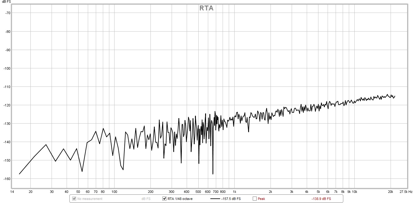

I found a swept sine wav file at audiocheck.net. Here is my measurement with peak holding.
Without signal in silent room below 2Khz the curve is klimbing from 15 DB up and down ! But flat above 2 khz within 2 db with smoothing on.
is the + 2 or 3 db at 4khz can give a brighty treble or peak energy in treble ?
Why below 2 khz without sound the curve is not flater ? Hope to be in topic.
Pink Noise give a diferent result with peaks at 3300, 4500, 6 to 7000 hz
I don't see a problem here. This s/w is measuring the level in fractional octave bands, so if your residual soundcard noise is essentially 'white', then you would expect the plot of the noise to rise at 3dB per octave. At a first glance, this appears to be what you get.
This is the reason why you use a pink noise signal for fractional-octave RTA measurements. (Pink noise rolls off at -3dB per octave, so produces a flat response curve when measured by an RTA). If your plot was measuring the noise in bands of equal Hertz (perhaps in 1kHz wide bands) then you would see a flat measurement result if the noise is white.

Don't want to high jack the post of Jayadev. Sorry for my low knowledge, but does it mean that I don't have to be frighten by big variation of the curve in a silent room when my mic and RTA are switched on ?
Because the low end of the mic+room are always enough flat (I have peak of more 10 or 15 db below 1,5 khz in silent room) for sweep sine or pink noise injected ?
Is it another way to say that with pink noise injected with a good enough micro (here ECM8000), I will see only the trouble of room+speaker in bass area and not the relation between mic+soundcard+phantom powersupply added to the measurement of the speaker ?

Given a muted input, the absolute noise floor is below -100dB, slope being irrelevant at such low levels. This is a 'good' result. If you have -80dB noise floor with mic turned on and gain set correctly (0dB input to output, 60dB at mic producing 60dB at loudspeaker) that would be classified as 'Excellent'. It is practically impossible to have actual noise floor below -60dB in most urban settings. I don't know where you live, but most cities in India are frightfully noisy at all times of the day. In a very quiet, untreated room in the middle of the night, I get about -50dB when the microphone is set to 'medium' sensitivity. Real noise floor is closer to -40, treatment can improve this handily but I haven't got around to doing it.
The USB Creative soundcards have a peculiar problem that you will encounter when actually using for measurement, seek out the Asawari build thread to find it. You will never get the response aligned correctly because of the variable latency over USB using the Creative drivers.
You can surmount this by using a low-latency solution - either a PCI/PCI/Express soundcard (and not creative, something with decent drivers) or a good USB solution that offers ASIO drivers. You will still have round trip latency of 10mS or so, but you can adjust that in RMAA because it's more or less fixed.
