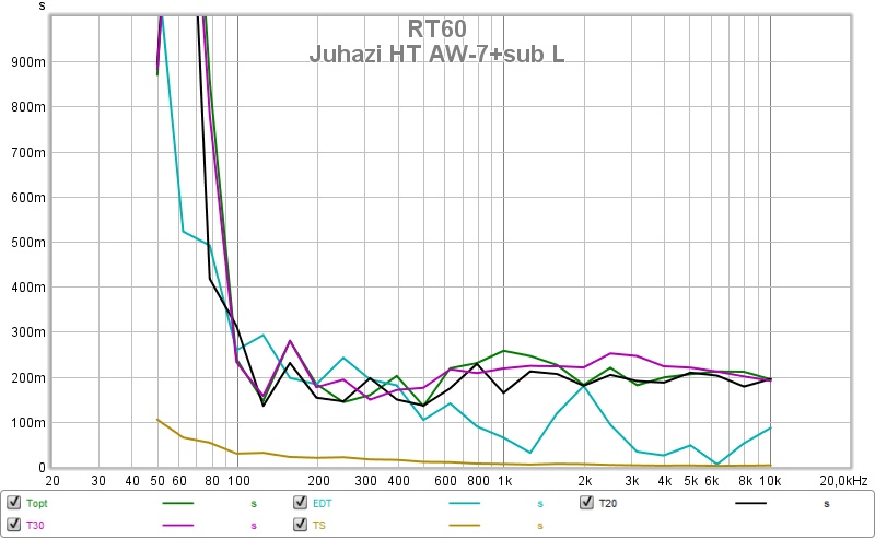

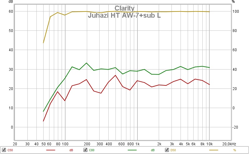

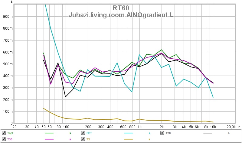

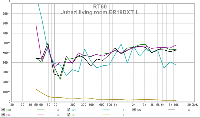

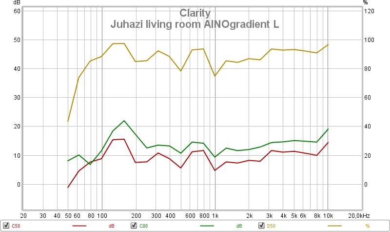

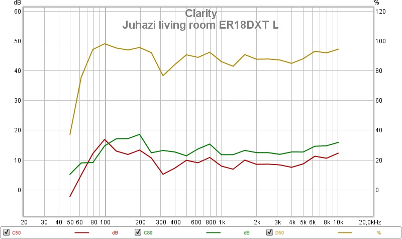

Here are my living room and HT room measurements. The sound is very different in these rooms!
Living room is 3,5x6x6m with tilted ceiling and large openings to kitchen and corridor. Gypsum board walls. Nothing done for acoustics except normal furniture and one small carpet under the table. Measurement with a dipole and monopole speaker in same location.
HT room is 3x4x2,5m even ceiling with air space, lots of bookshelves on two walls, sofa. Gypsum board walls except concrete behind the bookshelf. Small carpet.

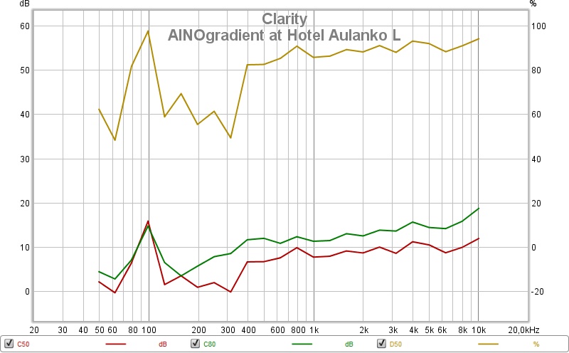

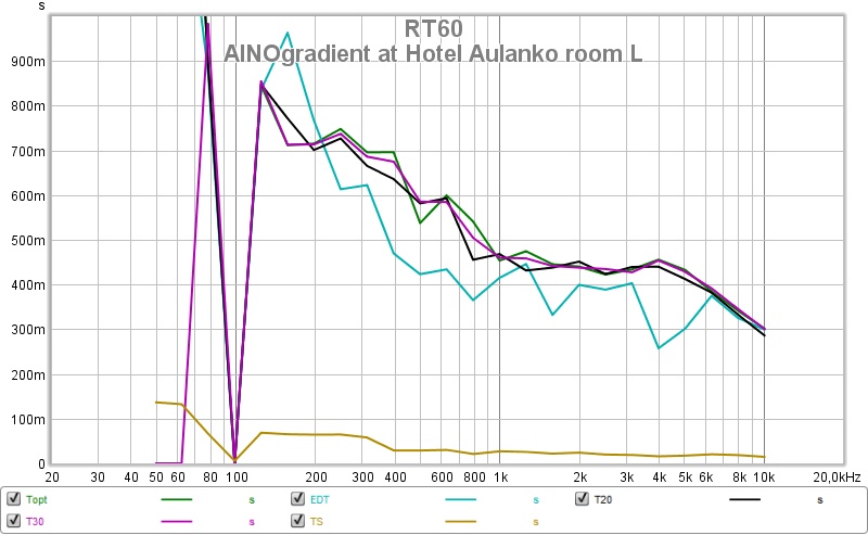

For comparison, here is AINOgradient in a hotel room with concrete nude walls. Trapezoid area 2-4x5x2,5m. It still sounded quite good! I guess my brains adapted quickly. And so for others too, "best sound at event"award!

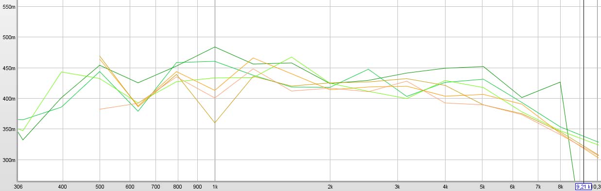

I finally got around to testing my still unfurnished living room (which sounds awful) to have a starting point against which to measure future progress. Used the wonderful REW. The RT60 is around 3.8s at 1kHz and my target is more like 0.3s. Speech is difficult to follow, music sounds cluttered and that lingering 1kHz region is unpleasant. I have my work cut out for me 🙂
