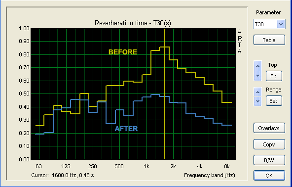

This is a before and after treatment from my old listening room that I converted from a garage. It's in my pegboard panel thread.
207387d1296262617-pegboard-acoustic-panels-30-png
One of the comments I made was "...this is already paying off...". What I was referring to was the systemic rise in T30 values above 1 kHz for the untreated cases that I see in the couple of room reverberation time plots (T20, T30, Topt, EDT, etc) in this thread. The surprising thing is that I've never had that rise at higher frequencies before--at least not anything like I see in untreated rooms like the one detailed above.
This tells a story of why I believe that certain people go for diffusion panels (most of which are only effective around 500-1000 Hz and higher frequencies). Since I've not had that problem in my room that I can recall, this plot by Pano gives me a glimpse of what is occurring. I would hazard a guess that directivity of loudspeakers above 500-1000 Hz (or rather, the lack thereof) is the root cause.
Why would I say that? Well, as a sideline, I volunteer to help others via emailing me their in-room REW measurement files so I can help them to dial-in their loudspeakers using DSP crossovers, and I get to see their RT room measurements at the same time. Thus far, I've helped in over two dozen installations that use (mostly) K-402-based loudspeakers, and have not seen this big rise in HF reverberation time in any of those REW measurement files.
Perhaps this observation might fuel conversations about controlled directivity/frequency and room reverberation times. I now observe that almost all the instances where someone is adding diffusion panels to their rooms--they also are using small-mouth horns (mostly on the K-forum where all the loudspeakers have HF horns). [When I say small, I'm talking about those loudspeakers whose minimum horn mouth dimensions (typically vertically) are about 5.5 inches (14 cm) or smaller.]
Maybe this is something that the "big horn crowd" avoids typically because of the dimensions of the horn mouths controlling their polars to lower frequencies than 1 kHz. I see a some other people having to use a lot of diffusion panels around the nearfield of their loudspeakers. This typically brings down reverberation times in the 1 kHz+ band.
I was under the impression that RT values were not really dependent on loudspeaker directivity. Apparently, this is not correct. (Comments welcome.)
A question for Pano: can you remember the HF horn/radiator that you used for your measurement above, and approximately where you placed the microphone relative to the loudspeakers in--room?

Those were made with both speakers playing, mic in the center of the room. The speakers were Altec VOTT A5 with the 1005 multicell horns + Fane bullet tweeters. Crossovers at about 700Hz and 7kHz. Speakers near room corners, toed in toward center. Directivity is pretty well controlled down to 300Hz.
