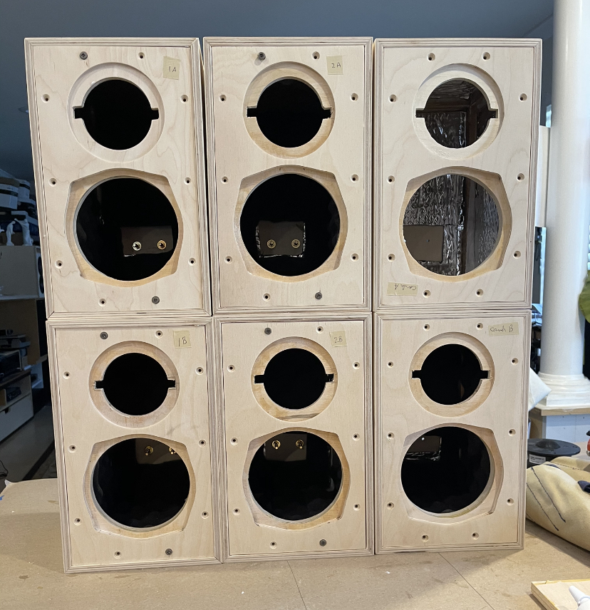

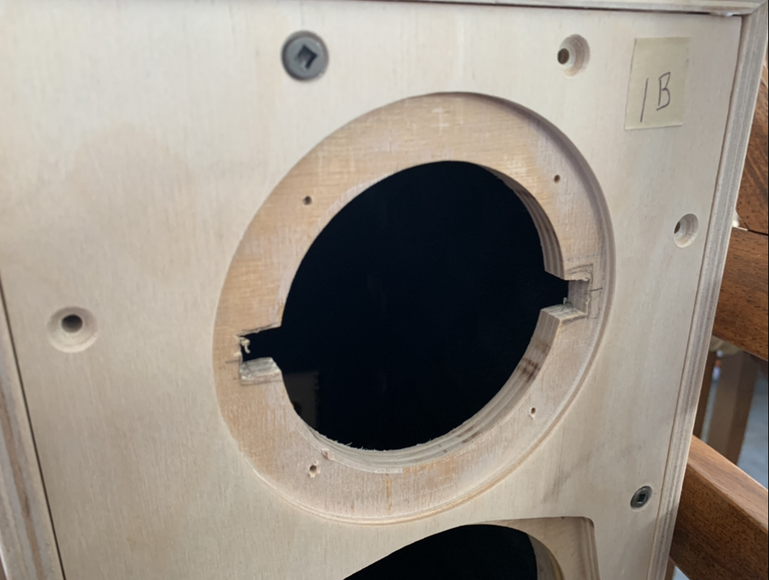

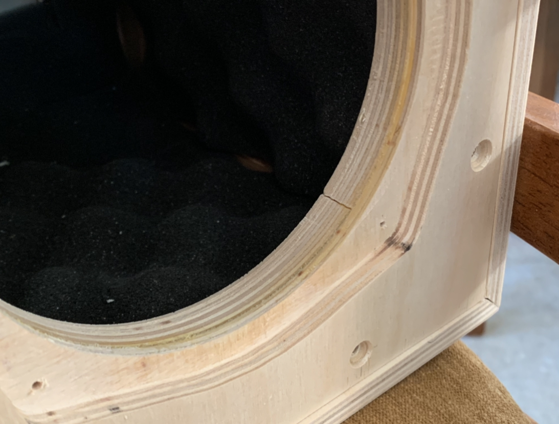

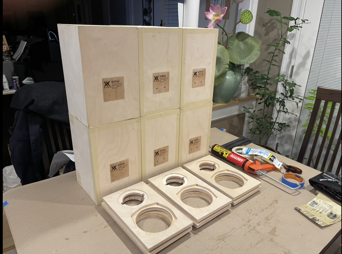

Some progress on the baffles - my cabinet maker was not happy with how the flush rebates on the pincushion shaped bezel looked so he started over on the baffles and this time, made a template using a precision scroll saw. Then the template was used with a router to do the flush rebates. The baffles are now done and the overall assembly of the cabinets remains to be done.

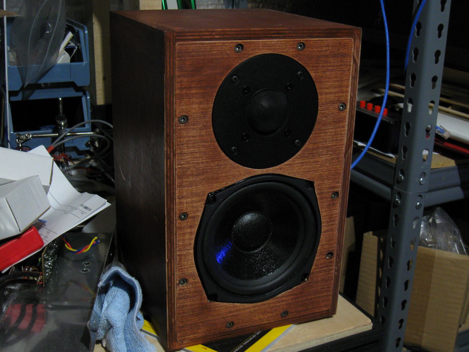

Those are nice boxes you made - stain is tricky. I like using dark stains because I can always add more to cover up the light spots. It helps to use a pre-stain sealer on the wood. Glad that they are still sounding good to your ears. The second pair is for a gift for someone?
It would be nice if my building skills allowed me to make a gift one of my siblings would proudly display in their homes. However I must be realistic. I had the wood and could make drawers for another project or speaker boxes. I tried miter cuts on the corners. Seven out of eight corners turned out good. So part of the purpose was to experiment with different building techniques, different finishes and learn a little about what I can do.

Thanks, dBel84! This is going to be a lot fun to assemble. A pair of cabinets are going to a good friend in Long Island. 🙂
My cabinet maker gets a pair with drivers and XO installed.
I get the third pair.

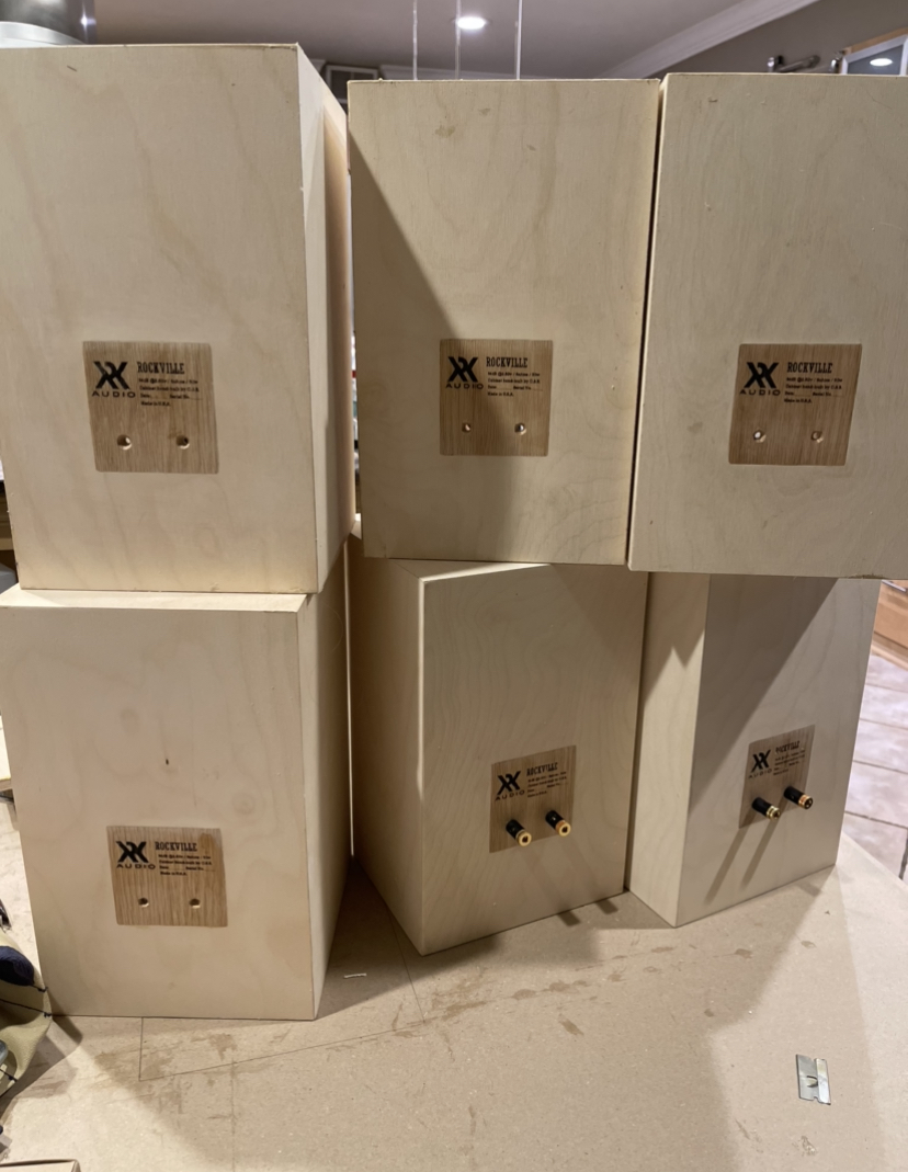

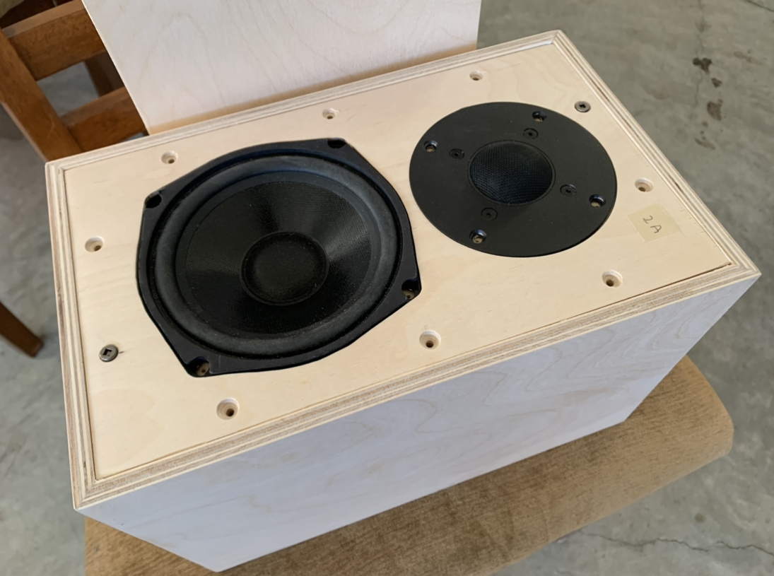

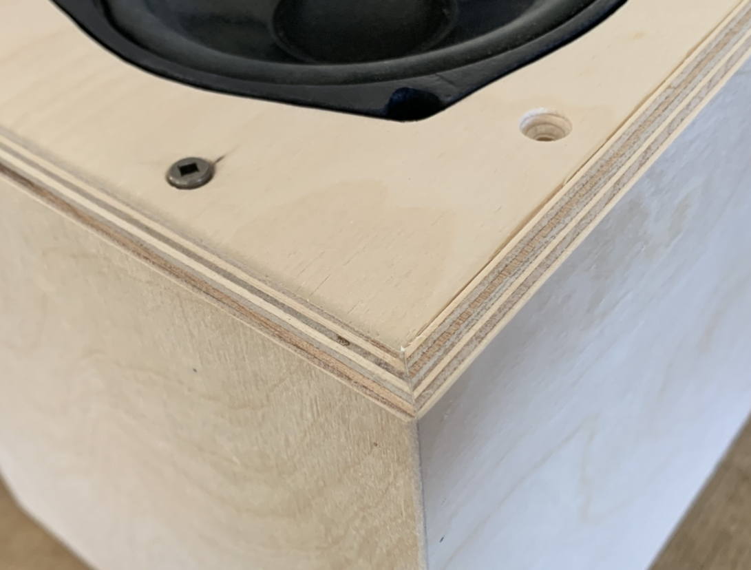

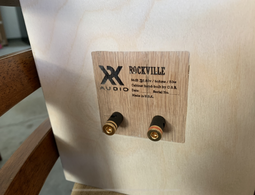

I have them in hand and they look great. Here are some details of the construction.
