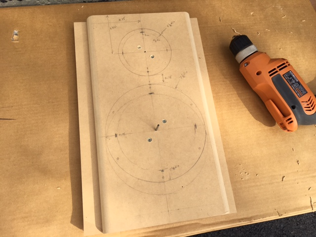

I have been planning these for a long time and parts have been collected and ready to build. I finally took the plunge (pun intended) and used a router today to cut the driver cutouts with rebates with a circle jig. That's a lot of work to cut a couple of holes.

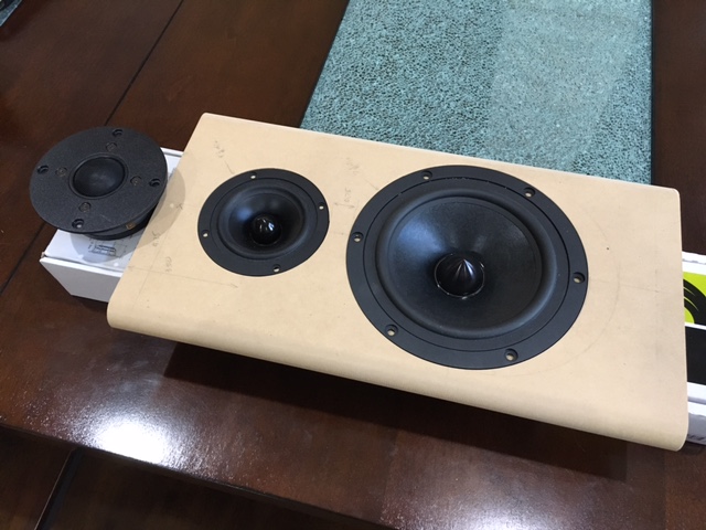

Some pictures of drivers after cutting out holes. Still need to make trapezoidal mount for tweeter. Then make measurements, then develop crossover in PCD or xsim. Lots of work ahead.

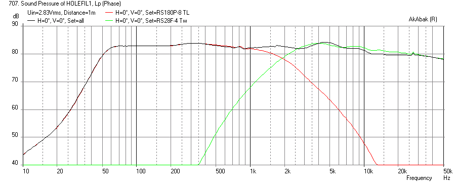

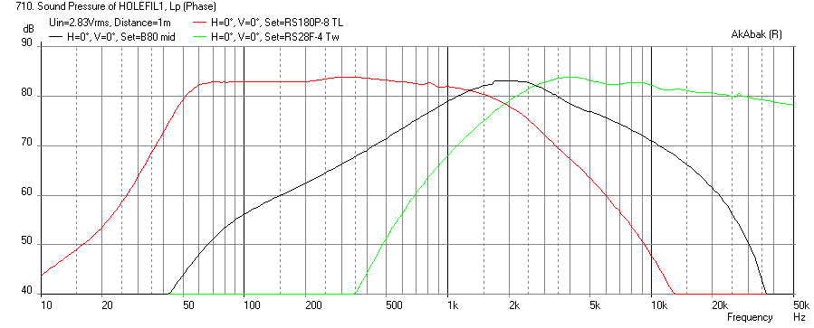

Hole Filler rough sims
These are very rough sims in Akabak to show the hole filler concept. The model of the RS28F is approximate as I had to estimate the rear chamber and dome curvature etc. RS180P and B80 T/S params are from manufacturer specs. I guess I should use my own measured ones from DATS but this is something I whipped up on my commute to work this morning.

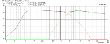

Here is response of drivers alone with a 1.9kHz XO point. Sims are showing baffle step losses greater than I anticipated - in 4pi space sensitivity is only 83dB. You can see how important the mid range hole filler driver is - it has to work over a very wide range to fill in what appears to be a very notch. Not too many drivers are capable of a linear wide bandwidth like this:
571560d1474889969-rs28f-rs180p-b80-hole-filler-3-way-rs180p-rs28f-b80-hole-filler-xo-drivers.png

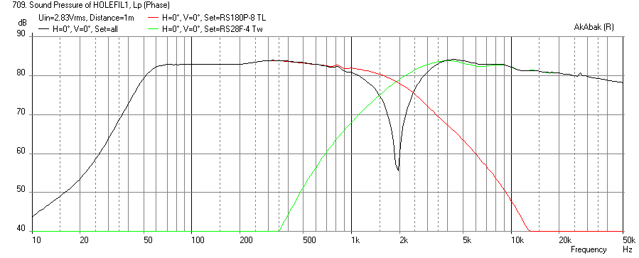

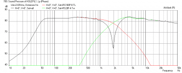

Here is what it looks like with no B80 mid showing the deep "hole" that forms when you have two second order filters in phase (both +ve absolute phase):
571561d1474889969-rs28f-rs180p-b80-hole-filler-3-way-rs180p-rs28f-b80-hole-filler-xo-hole.png

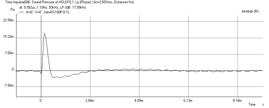

Here is the impulse response:
571563d1474890269-rs28f-rs180p-b80-hole-filler-3-way-rs180p-rs28f-b80-hole-filler-ir.png

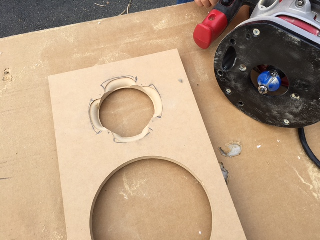

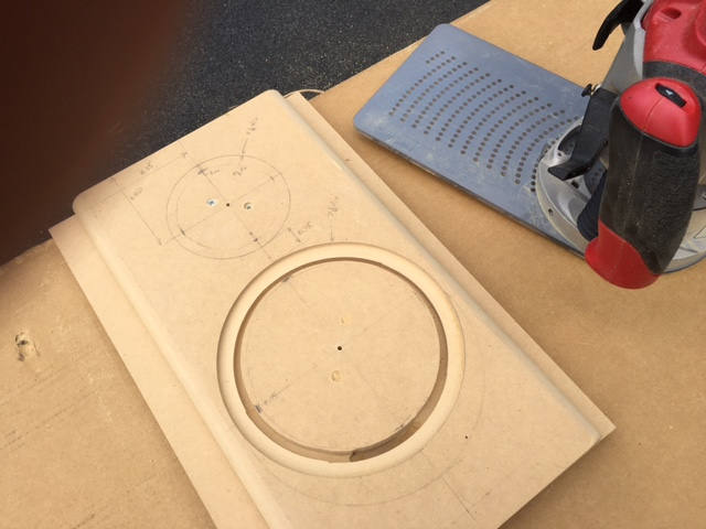

X's first experience with a real power tool

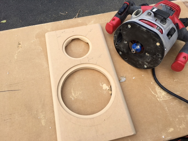

Most of you know me for foam core speaker builds and this is my first speaker with a real power tool (beyond a jig saw or hand drill). A friend loaned me a very powerful plunge router - he has 5 of them 🙂 I used a circle cutting jig and a sacrificial backing board screwed in place. It all worked very well and the carbide blade cuts MDF like butter. An enormous amount of waste is generated and I am glad I did this outside. Anyhow, here are a few photos of what took me 2 hours to cut two, albeit, quite precise holes with flush mount rebates. This was a test baffle so I can make another but it turned out quite well.
Layout work:
Initial cut, so far so good...:
Finished:
Backside round-over for good mid range air flow:

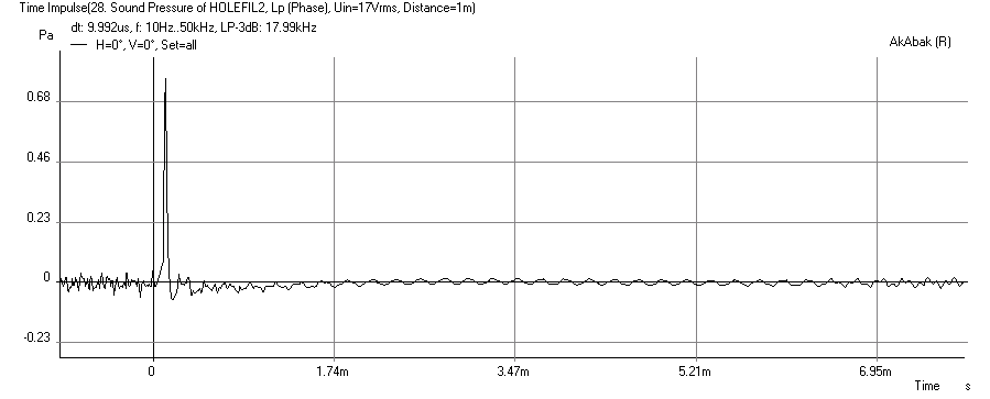

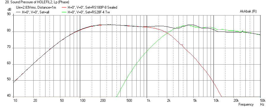

Sealed RS180P
Here is what this speaker might look like as a sealed alignment (assuming 14L chamber), not much bass with F3 of 91Hz:
571655d1474926301-rs28f-rs180p-b80-hole-filler-3-way-rs180p-rs28f-b80-hole-filler-sealed-fr.png
Although one can see how it really tightened up the impulse response into a narrow spike now:
571656d1474926301-rs28f-rs180p-b80-hole-filler-3-way-rs180p-rs28f-b80-hole-filler-sealed-ir.png
This will translate to a much tighter transient response. Hmm...

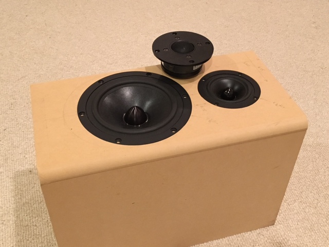

To give a sense of scale of the speaker - here are the bass and mid drivers fitted to the baffle on the box. The tweeter (or mid) will go on an external trapezoidal baffle mount that will be set back about 3.5in from main front baffle (TBD with measurement of time alignment). I think I need to look at simulated verticalnpilats in Akabak to see which way I should mount the drivers: TMW or MTW?

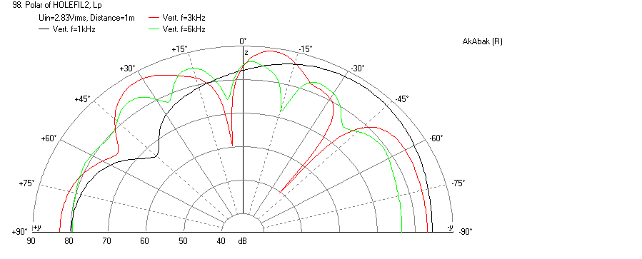

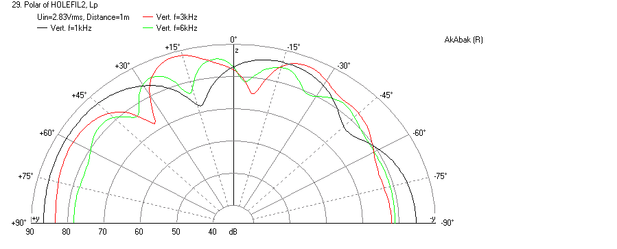

I'm exploring the differences in the vertical polars for TMW vs MTW and surprisingly, it seems that the MTW has a smoother vertical polar response. This may pose a problem because to get time alignment on the tweeter will require setback via a waveguide, which at this point was not part of the plan. Although I could cut a new baffle with provision for the WG, it would increase CTC spacing between between the WT and TM.
Vertical polar for MTW:
571755d1474980088-rs28f-rs180p-b80-hole-filler-3-way-rs180p-rs28f-b80-hole-filler-tmw-polar.png
Vertical polar for TMW - this one would indicate one should flip the speaker upside down with WTM and place it a little below ear height for best performance:
571756d1474980088-rs28f-rs180p-b80-hole-filler-3-way-rs180p-rs28f-b80-hole-filler-mtw-polar.png

Still would like hear input from folks regarding the TMW vs MTW arrangement. So far it looks like MTW gives a smoother vertical polar according to my sims. Is this right because TMW speakers seem to be the norm in commercial offerings. Do I have this wrong?
If going MTW route I would need to redo baffle to accommodate a waveguide for the tweeer to allow sufficient setback for time alignment.
