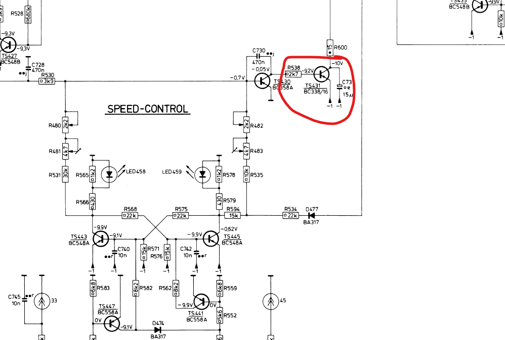

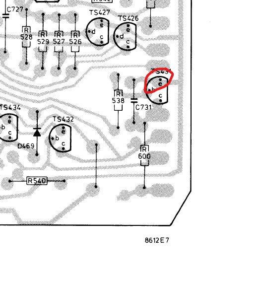

After giving up for a couple years, I've again decided to see if I can save the old girl. The problem: the platter spins super fast. I was told here originally to check for bad capacitors. This week, I took everything apart and inspected two caps in the speed circuit that might be involved. They both look fine, but I understand they can just crap out with age. I figured I'd just try and replace both, and see what happens, but I'm having a hard time figuring out replacements. I'm attaching the schematic, and info on the caps in question. To further complicate things, someone suggested recently that it could be a governor failing in the DC motor. That's a whole new wrinkle, and I have no idea how I'd even deal with that or test for it. The dead caps seem to make more sense. Anyone have any thoughts or suggestions? BTW, I'm a novice, not an experienced electronics tinkerer.

What you attached is a board layout. If you have a schematic, it might be worth posting that too, since it may help others point you in a diagnostic direction. Untangling a board layout can be difficult for those unfamiliar with the circuit.

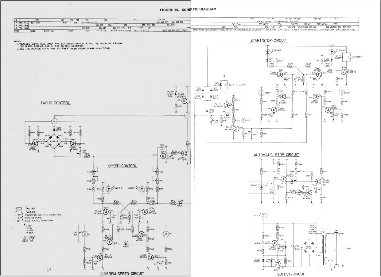

Okay, I found the schematic in the service manual, and attached it. (tried merging the two pages, for easier reading)

If you can identify and locate parts on the PCB then one worthwhile check is to quickly measure across C and E (collector and emitter) of transistor TS431. The power must be OFF and you should use the diode range on your meter. See if it reads very low or short circuit.
You could also try shorting the base and emitter of TS431 (or lift one end of R538) The platter should not run at all doing that.
All that just proves the motor driver transistor is OK but that type of part is likely to fail in use. Worth checking before getting heavy with it 🙂

Well, not so much the comfort zone as the "have a clue zone." 😊 Thanks for the suggestions, Mooly. If I can figure out how to perform those tests with my meter (never used it for electronics testing), I'll have a go at it. Time for some more "homework." I think I ruled out C729, as it appears to be part of the supply circuit, not the speed circuit. Thanks again for your help!
