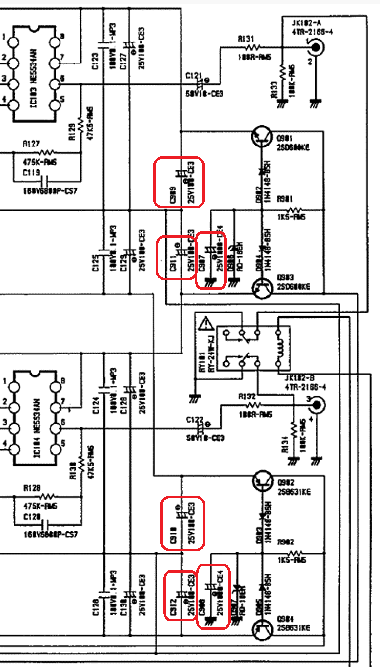

A lot to read but I think I get the takeaway point of pin 7 voltage is correct and pin 4 varies between 0 and -17 volts. Both rails should be rock steady.
Suspects are the Zener failing low impedance, the 1k5 going high/open circuit or the electrolytic cap failing short (unlikely but possible). More likely could be a break in the print somewhere so I would check that the raw voltage on the collectors of the two regulators remains at around -25 volts.
If that jumps around to zero then you have a break in the print feeding them.
If it remains then its likely one of the those three parts and the safest fix is to swap them all unless you can definitely identify the problem.

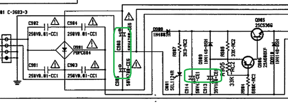

OK sorry for the lack of clarity - Im software not electronics so am a bit lost. Looked a bit more closely at the schematics to understand what people are asking/saying and did a bit of reading - a bit clearer now. I think were very close now 🙂. Heres a hopefully clearer summary:
1. Secondary AC voltage: White to Blue1 22volts good. White to Blue2 22volts good. Blue1 to Blue2 44 volts => Nothing wrong with transfo.
2. Collector voltage into -ve side: Q902 vs gnd correct at -30v and same for Q904 -30v. (Same on +ve side into collector Q903 and Q901 at +30v.) => Nothing wrong with Rectifier.
3. Emitter voltage -ve side Q902 vs grn OFF at -1.5v - it starts lower (-0.6v) and creaps up to that maximum. (Correctly +17v on +ve side on Q903 emitter)
4. Voltage over D907 on -ve side OFF AT -1.5v. (Correct on +ve side D908 at +17v)
So best chance of fix is replace:
  • Zener D907
  • Resitor R902
  • and maybe Cap C906 (visually looks ok)
Can I measure the power-off resistance across R902 inplace - or is only an out of place measurement reliable?
I did measured this inplace with ohm-meter with power off and it was in the MOhms (~1.4 MOhm) not the 1.5 k Ohm expected - I'll pull this out and test it out of place later. This would fit with @Mooly's comment:

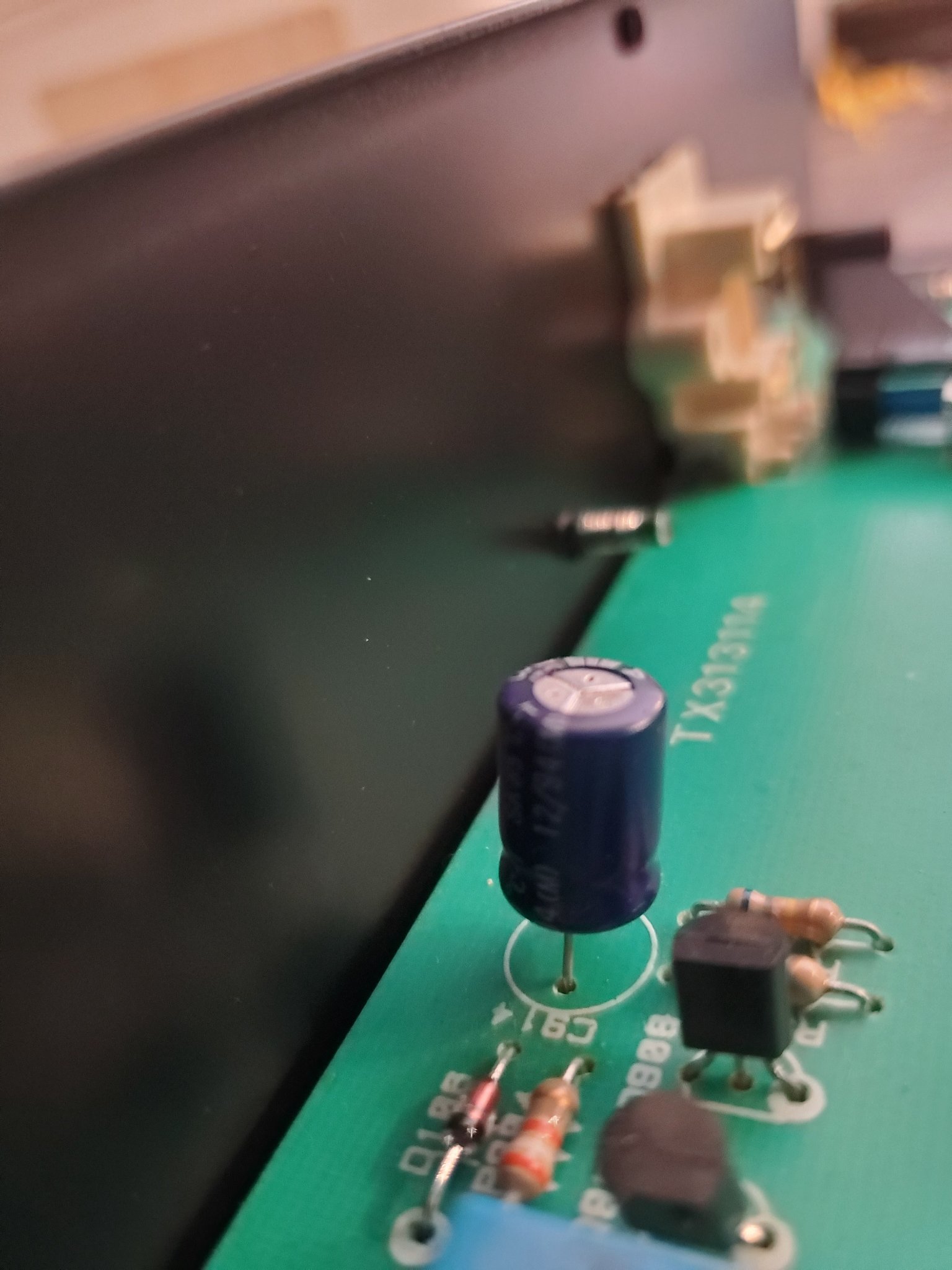

Looking at that R902 now with that knowledge it is pretty clearly fried... I had in my head a cap issue so looked at those carefully - I should have done a closer visual inspection of everything... Anyway pretty clear now I think this is the culprit.
Tbh that points to a break in the print. If the collector volts is low and yet the voltage on the big reservoir cap is OK (C906) then there is a break.

It seems it got warm. The new one could be soldered with a few mm space below it. Maybe replace the other one too.
Yes when I took out the cooked resistor there was literally a black burn mark on the board - space between board and resistor a good idea. As it happens with my sloppy component mounting I have that now more or less by accident 😆

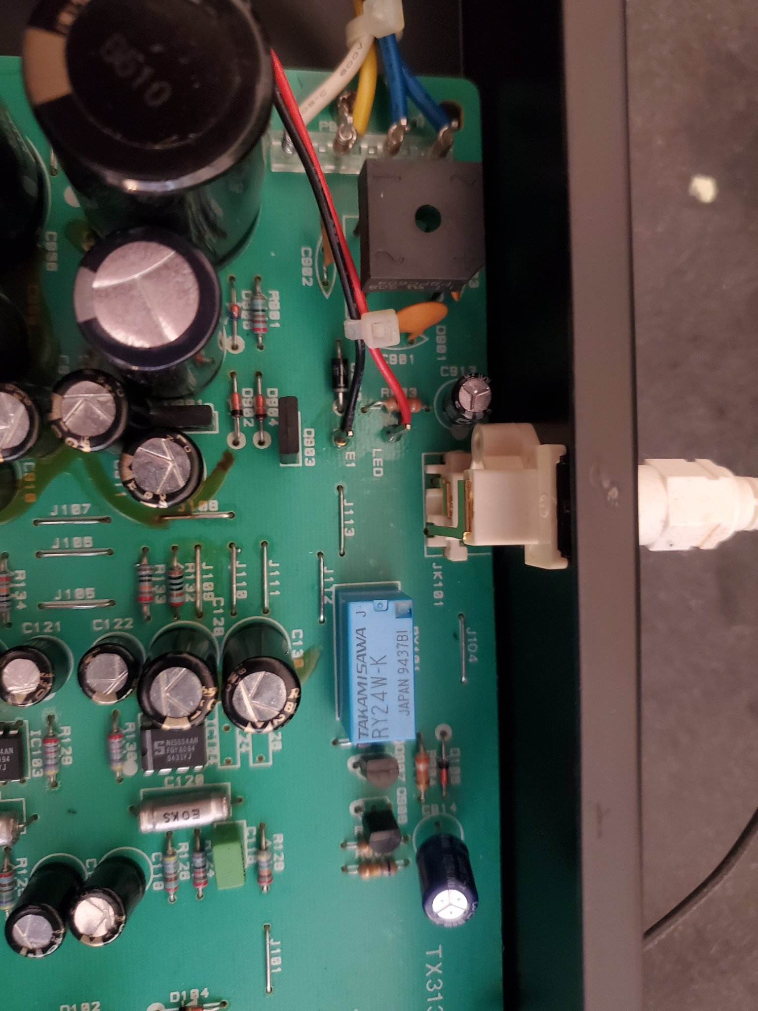

Worth noting that visually by eye the resistor looked kind of OK - certainly didn't jump out. But looking at the zoomed photo from phone is was quite clear it was damaged.

b. Photograph the board and examine it on PC, zoomed, component by component.
This would have likely found this with out the electronics diag. If you know what your doing I guess the electronics diag is quick and relatively easy but for someone without the knowledge the closeup visual inspection is a good tool.
