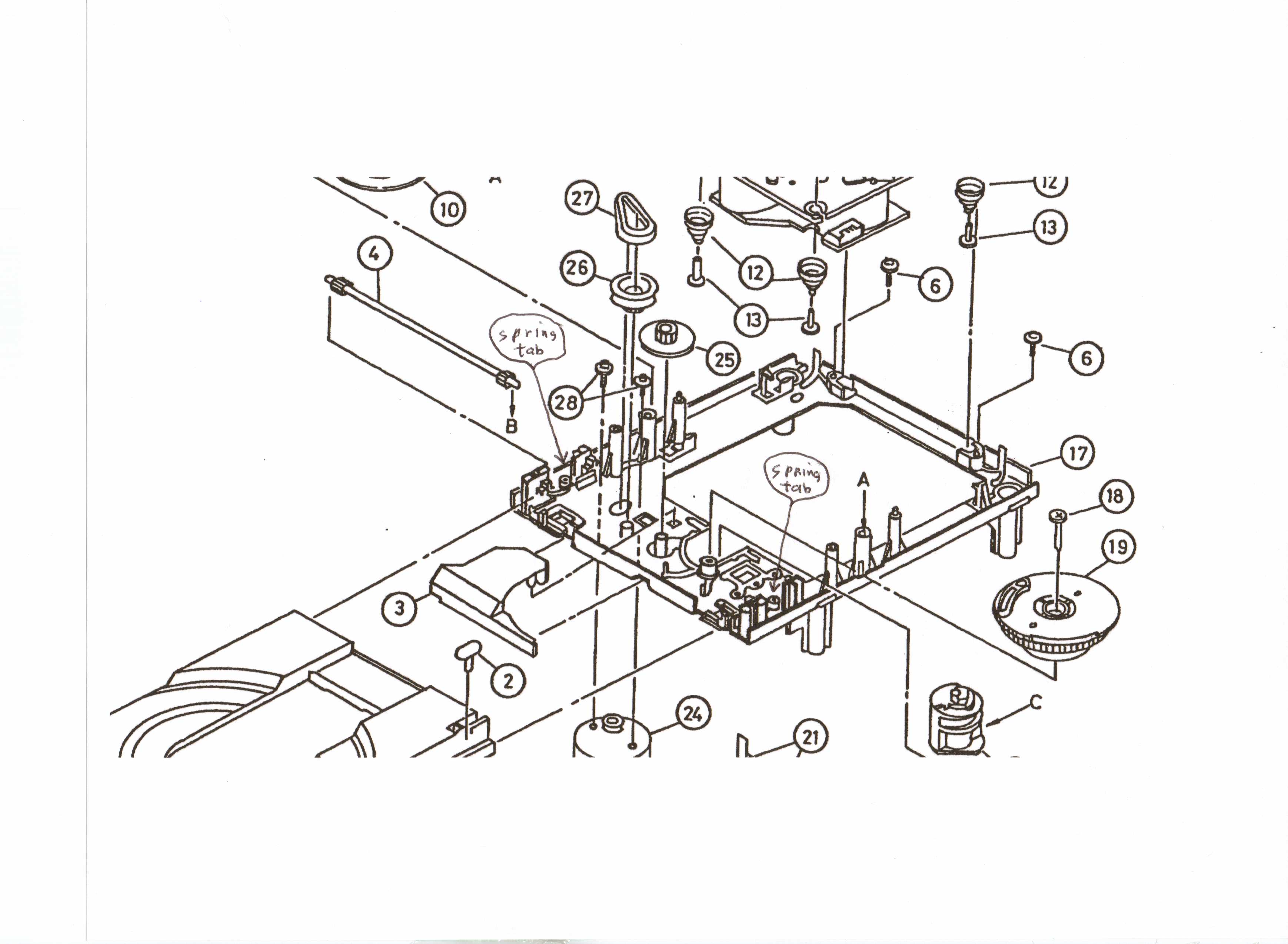

Well, just for you😀 I took mine apart this morning.
There is a small tab on both sides of the tray that extend downwards. They contact small plastic ears that are part of the moulding that holds the cross shaft and gears that directly drive the tray. These small ears must be gently pried outward with small screwdrivers to let the tabs on the tray pass by. Be gentle, and the tray will fall out. After the tray is removed the gear cover must be removed. Pop the rear of the cover off, then slide the cover sideways until the removal slots are lined up with the tabs on the gear cover and it will fall off.
You can then remove the belt, remove the motor screws, pinch the plastic PCB retainer and remove the motor/ PCB assembly. Now you can get to the leaf switches, but you need some soldering skills. I would suggest purchasing a solder sucker from Radio Shack to remove the leaf switches. If you practice a little on something you will "get it". Once the solder is removed the switches will come out easily. If you know someone that can do it for you, all the better. The switches have slightly different size ears on each side so presumably you cannot install them backwards, but pay attention anyway.

I tried to attach the drawing? New puter, hope it worked.
Wow, thanks Bill! Much appreciated, I hope your player won't suffer for my lack of experience! I got the tray off and the PB off as per your directions and am ready to go. I assume I have to re-solder the switches in after inserting them.

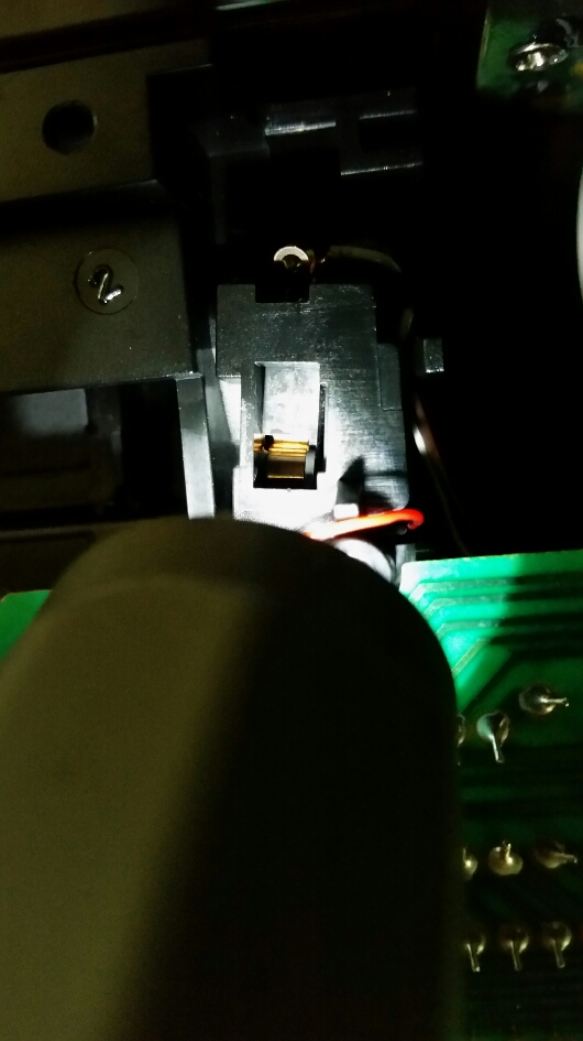

Guys I'm always late to the party.I have a nice 971 here that needed a new gear to open/close. Got that installed and it now opens and closes fine ,but won't spin. I have the bottom off and I think I may have found the stop switch sensor I will try to attach pics. I don't see any plastic extension here and wondered if I'm all wet or it may have broken off? Thanks a million. Would love to get this going. How do I best reduce pic size to under 1 mb on an android?I think my photos are way too big

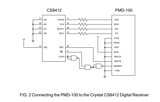

I also have same problem of 00. I buy CS8412 board and make it to DAC instead. Now it indirectly solve 00 problem. you can see how to connect CS8412 and PMD100 of Rotel in PMD100 Datasheet. Just do as the picture. it works fine.
