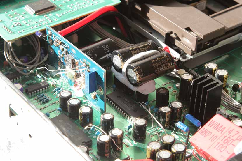

Guys I'm always late to the party.I have a nice 971 here that needed a new gear to open/close. Got that installed and it now opens and closes fine ,but won't spin. I have the bottom off and I think I may have found the stop switch sensor I will try to attach pics. I don't see any plastic extension here and wondered if I'm all wet or it may have broken off? Thanks a million. Would love to get this going. How do I best reduce pic size to under 1 mb on an android?I think my photos are way too big
