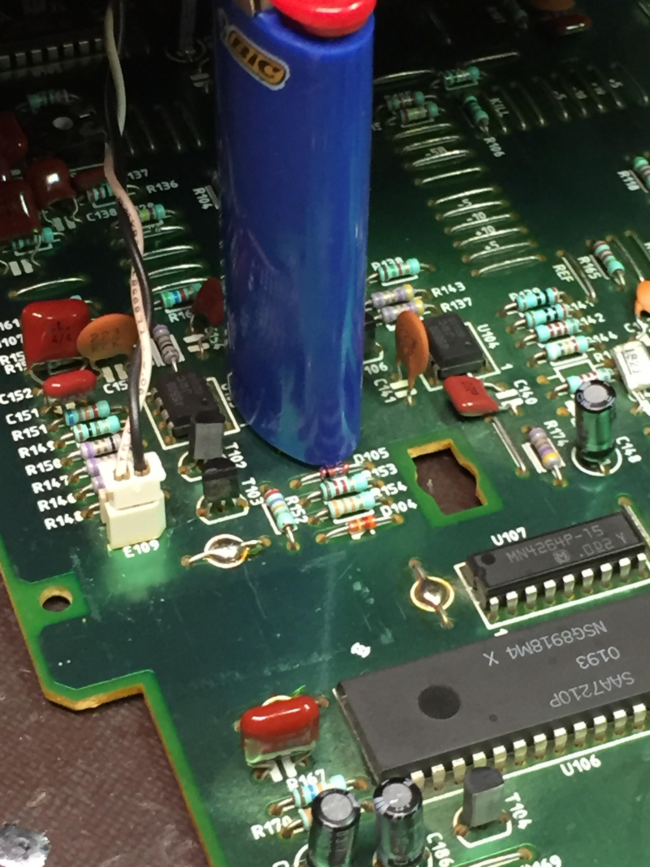

From the jizz-matic, I saw T102 and T103 are the motor drive transistors. Can't measure them in circuit so I removed them and viola, T103 was open collector to emitter.

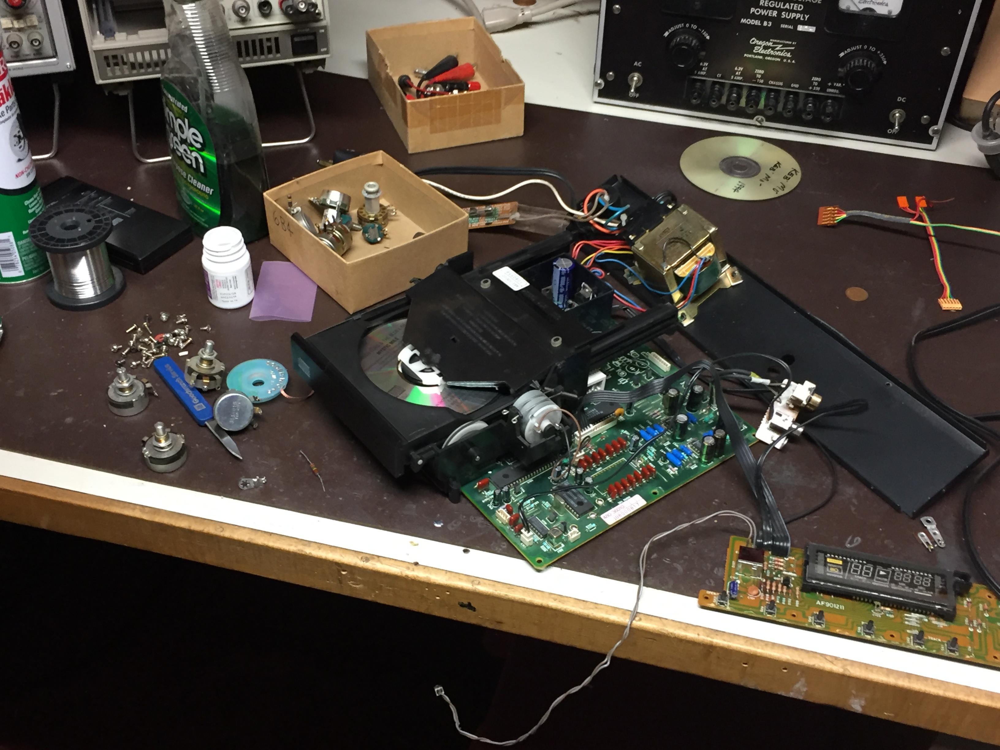

Of course all of this circuitry is under the transport. The two transistors in question can be seen in one of the photos. The other photo shows that I've made a "kit" out of my player......😀

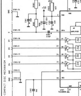

So I got back to this and figured I should do the alignment as outlined in the RCD955 manual. I know you have all been on the edge of your seats waiting for this......😀
There are two adjustments. Laser Current and Focus Offset.
I had only messed with the current pot a little, so I followed the process for that.
I set the pot plus R108 to equal 1K.
Then hit play and attempted to set the voltage across R101 to 50mV.
R101 is in series with the laser I assume. See attached.
It is a 4.7K resistor.
At any rate, this is quite low current.......
That said, with the disc spinning, I measured 20mV. As I adjusted to increase it, the disc stopped and the current went to 0. started over, adjusted the other way and below 10mV the disc stopped and the current went to 0.
So 20mV it is. I let it play the entire disc twice, and the volts stay steady. But it sure won't set to 50mV as described in the procedure.

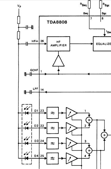

Basically, I think there is more going on here than a direct current adjustment. I have the Datasheet for the Photo diode signal processor TDA8808T but confess to not having paid attention in CD player class back in 1987. I was a spectrum analyzer tech.

The official Philips method for setting the laser current was awkward and convoluted. You are measuring the current (indirectly by measuring voltage) flowing in the photo-diode array when playing a test disc meeting Philips standards.
If you have twiddled the pot away from its original setting then the best you can hope for is to adjust it using a good commercial CD (and try more than one in case the one you pick is poor) and by setting the RF signal to an amplitude of approximately 1.2 volts peak to peak as measured on a scope. Use a properly compensated and correctly adjusted divider probe and a scope of at least 20MHz bandwidth.

Well, I took the laser assy apart and cleaned the mirror and the underside of the lens.
Didn't change the output wave form amplitude.
I got tired of having the thing spread all over the work bench so I put it back together.
Plugged the digital out into my DAC and I'll be dammed, it works.
