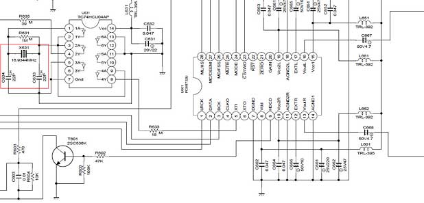

OK, I believe that re-reading the thread has started to refresh my memory.
I pulled one of the leads on each of the resistors R633 & R635.
In other words for each of the resistors, I de-soldered and lifted the lead that was closest to the HCU04.
Then I attached a wire from the clock-out to each of these resistors.
This way the clock signal goes as follows
Clock -> R633 -> XTI (pin5) on PCM1732U
AND
Clock -> R635 -> Pin62 on CXD.... chip.
As for the power lead for the clock, as Elso will tell you, it needs to go to the un-regulated digital supply. If you follow the schematic to one of the +ve pads of a digital supply capacitor and test it for the correct V, then you should be in business.
I would tell you which capacitor I used, but I no longer have this player and I simply forget which one. Elso knows. He'll hate me for that.

You're probably right about the cap, but you'd best trace the schematic to be sure.
As for the ground, I would strongly advise against running the ground to the power supply. -You'd essentially be picking up all the noise and EMI crud (like an antenna) from the ground at PS back to the clock.
I believe a better approach would be to run your ground wire as close as possible to one of the -ve pads near the resistors that the clock out is going to. I believe I used the -ve pad of C601.
Hope that helps.
Hope that helps.
I think the name of the game is to keep the ground lead as short as possible.
You might even try connecting it to the ground side of J337 or J332.

Help!
With the C633/C634 and the crystal out of the circuit, and my clock output feeding pin 1 of the HCU04, I occassionally experience static in the outputs of the CDP. If I power down and power up again, the CDP plays well. Anyone knows what's the possible problem? Is it to do with the analogue stage or the clock?
I've attached a part of the schematic for reference.
Thanks in advance.
Regards
CK
