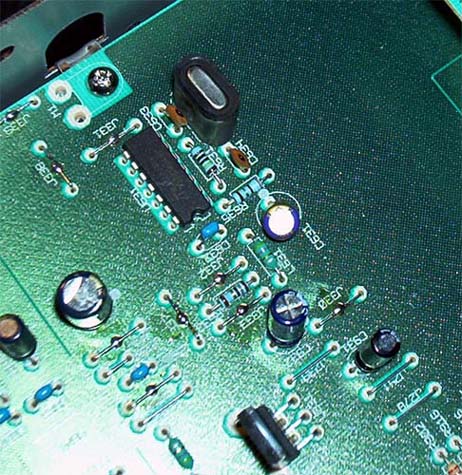

Elso, should I ground the quartz's metal case?

In most Linear Technologies papers the case is grounded. I tried it but did not hear any difference in sound.
To prevent disaster I do not remommend it as the heat can damage the crystal.

I can't comment about the sound, since I still haven't put it in the player now.
But on the scope, the output waveform didn't change at all when I grounded the quartz
You're right about the heat, I haven't thought about this. And for sure, soldering this would require time and heat 🙁

I think I put this picture in earlier, but here it is again. It's the standard crystal in my cdp. That PCB has a ground plane, and the crystal has a 2 or 3mm thick rubber thing to sit in. I assumed this was to insulate the crystal and ensure it doesn't become grounded

possible i guess, but if they're going to put that much attention into damping components like that why haven't they given any other components much attention? of the cd players ive taken apart, i havent seen the crystal set in a rubber sleeve like that, but then i don't think any of them used a groundplane like that from what i remember.

Rubber damping
Hi Steve,
Please see:
http://www.diyaudio.com/forums/showthread.php?postid=301336#post301336 (second part)
baggystevo82 said:possible i guess, but if they're going to put that much attention into damping components like that why haven't they given any other components much attention? of the cd players ive taken apart, i havent seen the crystal set in a rubber sleeve like that, but then i don't think any of them used a groundplane like that from what i remember.

Hehe, very cynical! So does that mean you think it's there for insulation then?

No I believe the rubber around the crystal is for mechanical damping NOT for electrical insulation.😎
