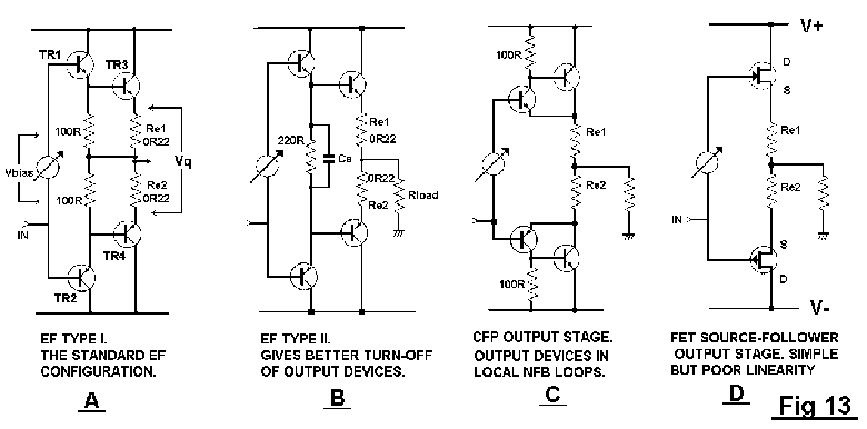

You can also modify the output stage... use the schematic B on the picture. it inproves the turn off caracteristic of the output stage.
I made that change in my amplifier whit good results...
Here is a link to the doug self website with a lot of information about amplifiers: http://www.dself.demon.co.uk/dipa.htm#4
hope this help's

rickpt said:You can also modify the output stage... use the schematic B on the picture. it inproves the turn off caracteristic of the output stage.
hope this help's
Regards
Rick

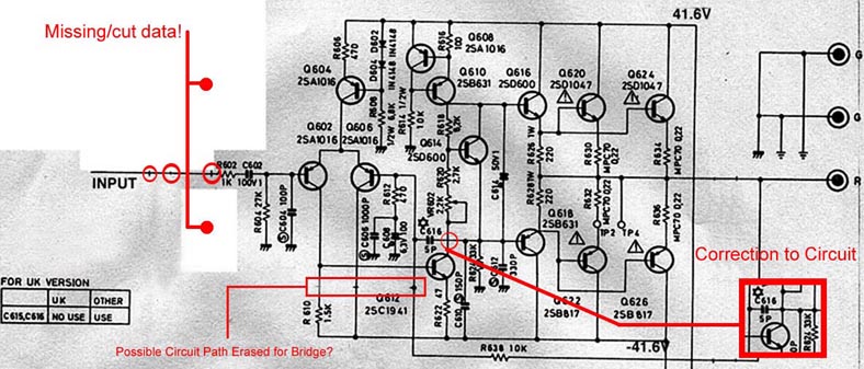

Hi Ron
The above statements about the turn-on hump are right (unless you have a turn-on-delay relay).
I didn't watch out for the behaviour of the two current sources invloved. The current source around Q608/Q610 will turn on faster than the one around Q604 if you bypass the two diodes and therefore cause momentary imbalance, leading to a turn-on hump. OTOH bypassing would improve noise and supply rejection a bit. I can't even say how much - since I never tried any circuit WITHOUT bypass on such current sources.
Jorge Santos' statement about the missing junction is right (collector of Q612 to base of Q618) as well. Since I assume your amplifier is working properly, this is only an error in the diagram.
The capacitor C616 is part of an inner feedback loop. Since it is not used outside the UK, I assume it isn't used to increase stability (which it also would be capable of) but might have been necessary to meet some EMC standrads (I don't know if British standards are more stringent then the rest of the world).
Regards
Charles

Charles,
Thanks for the clarifications 🙂
I think I'll try out some of the mods, bypassing D602/604. What value and voltage do you recommend?
The 5pF cap is used everywhere except for England. I'll upgrade that as well. While I changed out the input and feedback resistors to Vishay S102 (because I had the correct value lying about), I think the biggest improvement was made by changing the input cap, a weird little silver affair, rectangular in shape. For the moement I have a Solen metalized cap in there, but I want to try something a bit better.
I suspect that there is an error on the diagram, one day I'll trace it out on the board.
Thanks again for all of your help!
Best,
Ron

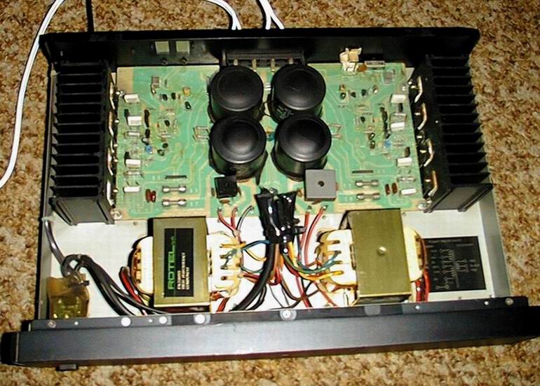

Hi Ron
Now that I have seen the picture that has been posted by mpopovics I also see that there is no DC output protection relay. So one has to be careful with the size of a bypass capacitor.
I also see that there are fuses in the DC supply lines, so I think it would definitely be a good start to apply bypass capacitors after these fuses for both supply lines. I would try this one even before doing something on the current source. I think 100 uF (as Raul suggested) with low esr and reasonably high voltage rating would be a good starting point.

Hi Charles,
Yes, there are fuses in the DC rails. I didn't show the power supply schematic, maybe I should have 🙄 Following the fuses, there is a 0.1uF cap to ground on each rail. I will upgrade these to something on the order of 100-1000uF, depending on what I can fit into this position. It is my understanding that while the fuses provide protection, they also increase the power supply impedence, not a good thing 😡
There is no DC protection relay as you mentioned.
Speaking of rectifiers, as mpopovics brought it up, I'm thinking of going to Schottky rectifiers, as I've had good luck with them in the past. I can't find the spec's on the current bridge rectifier, but the fuses are rated at 4 amps and the power supply provides 41.6v after rectification, so we have approximately 30V AC on each leg of the secondary referenced to ground. I think that's correct, I should just measure. Any idea's for what rating I need for the Schottky rectifiers?
RonS

Rotel RB850 Corrected Schematic
I have been researching the Rotel RB850 amplifier for
several years.
I have redraw the schematic with some corrections based
on tracing a RB850, the schematic on this forum, and
schmatics of similar Rotel amps. The Rotel RA-02 is very
close to the same amp section. So are the 5-channel and
8-channel amps.
This site offers for free schematics of some similar
amps to the RB850.
www.eserviceinfo.com/browse.php?id=32
Sincerely,
Chris Browne

Rotel RB850 Birdging Switch
The schematic seems to have been floating
around for several years. It sure seems like
the small missing hole is the bridging switch
area from the other channel. Most other
Rotel amps have a resistor and cap from
the base of the input transistor to the
base of the second transistor of the
differential pair. I will have to retrace my
RB850 and see how the bridging switch
fits in the schematic. One amp will run
at 0 degrees and serve as the main
input and the second will run at
180 degrees out of phase and have
its original input disabled.
It seems logical. Your thoughts?
I hope to have
my amp back in September. . .
it has been on loan to a friend.
I have missed it though.
Chris

Bought one Rotel RB-956AX used.
Two pairs of outputs were gone, and one speaker terminal was broken.
Got hold of the original transistors and fixed everything. It works great.
But:
The Idle current in all the outputs were set to 160mA. I think this is quite high for this amp so i re-adjusted it to 100mA.
I am suspecting the previous owner turned it up for lower distortion, but this could be why it burned the two outputs.
Does any one know what the Idle current is supposed to be?
