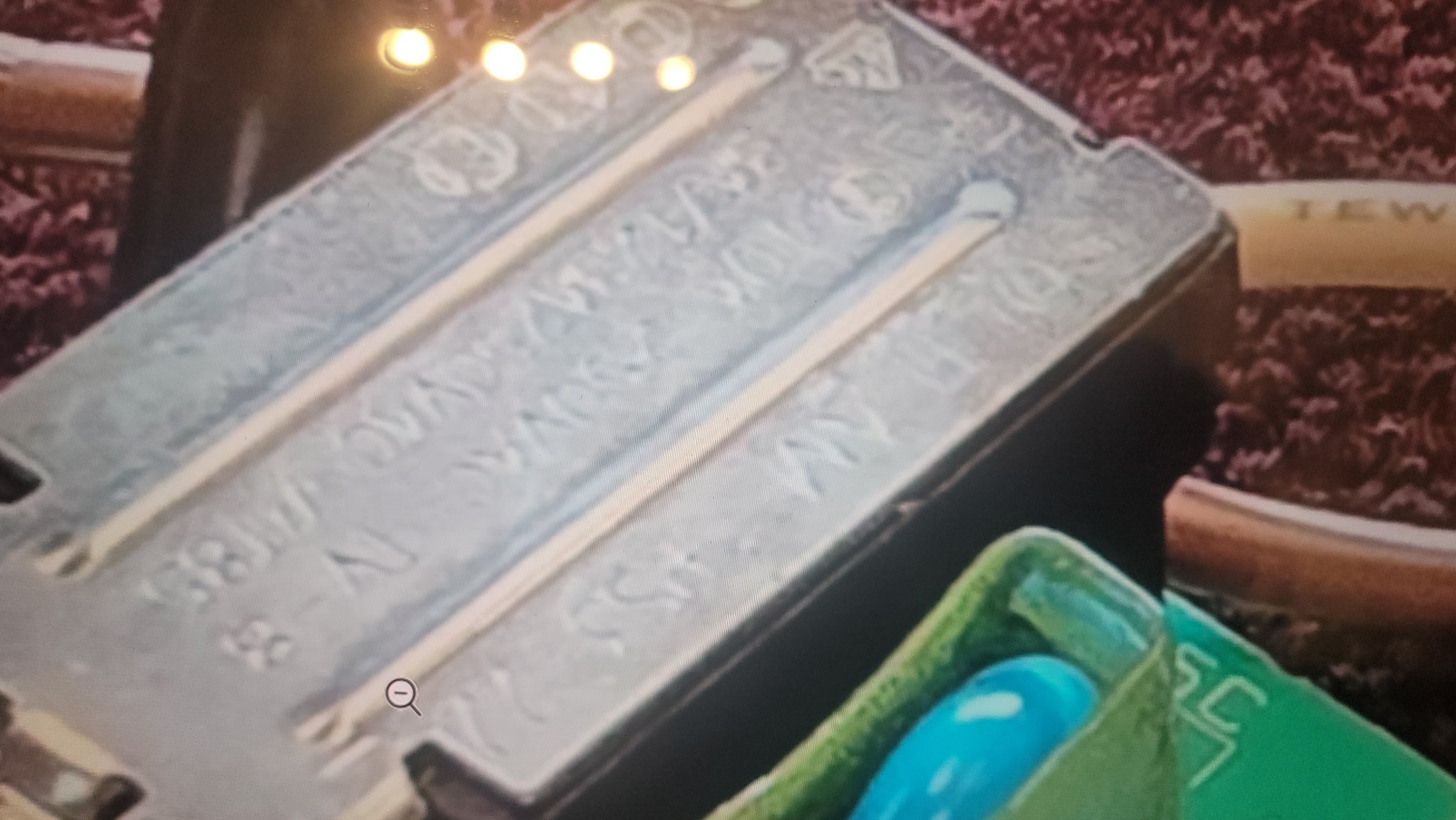

No you better remove your own defective switch (not to be reused again) and write down the type number and the ratings.
Especially the voltage and current ratings.

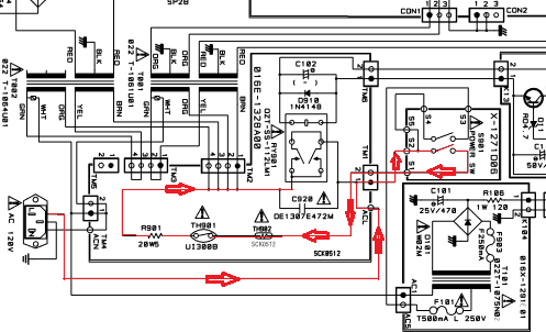

When you had the switch dismantled, did you observe any evidence of arcing—- especially on the S1-S2 pole of the power switch?
I note that during turn-on, that section of the switch has easy duty because no current flows until relay RY901 activates about a second later; in contrast, at turn-off, full operating current is broken by the power switch and would likely experience arcing erosion.
This might be failure of the power switch S1-S2 pole. The relay would energize but no power to the PA due to open S1-S2 side of the power switch.
——— It clicks but doesn't do anything to the power. So now it is a bit different and possibly something more? But then why did cleaning work for almost a month. Will need to find a reliable tech in AZ

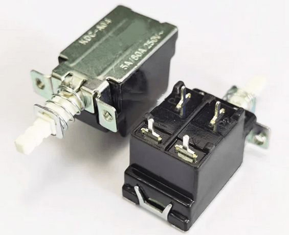

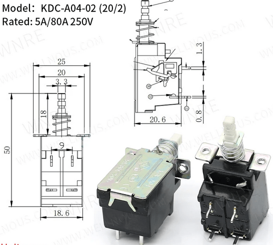

According to the schematic, one half of the switch need to pass through high current for the main power transformer. It is not hard to imagine the switch contacts will fail over time, cleaning only can do so much to extends its service life.It obviously was not a matter of cleaning. It worked since I last responded on July 20th. Did the same yesterday. It clicks but doesn't do anything to the power. So now it is a bit different and possibly something more? But then why did cleaning work for almost a month.
Replace the switch and see if that solves the problem, please check the dimension of the KDC-A04 if it fit in the PCB, and since you're in it, it might be a good idea to replace the soft start relay (RY901) as well.
