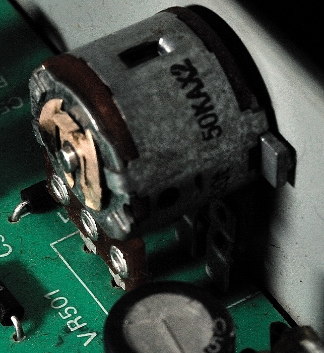

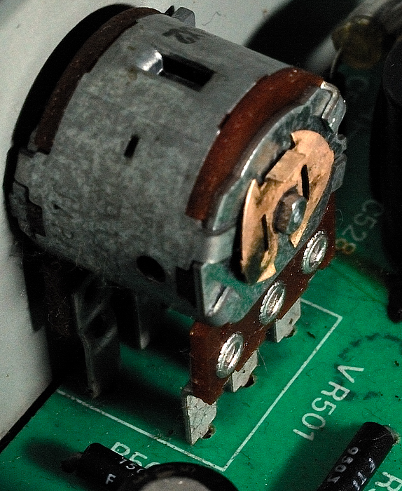

I have an old Rotel RA9708X amplifier with a dual volume pot, and one channel is dying on me.
The pot is marked VR501 on the print card, and 50KAX2 on itself.
Can anyone recomend a replacentpart for it, and where to buy it online?
Any help would be much apriciated!!
-Kvikkas

Maybe better to ask the question in the Solid State or parts section of the forum...
Anyway, 50KAX2 suggests an Alps pot, so just replace with a new 50k Alps pot and use wire links to connect to the circuit board.
If you are sure that the pot is faulty.
