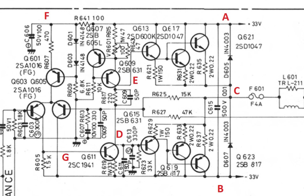

No problem 🙂 I know its a steep a steep learning curve 😉 I hope this doesn't look to daunting but they are just simple voltage checks. We need to try and see where its falling down, where the loop is failing to correct the offset.
Lets elaborate a bit more on those voltages...
28 volts on D605 I'm assuming is the supply end of the diode
18 volts on D607 I'm assuming is the amplifier output end of the diode which is the same as measuring on the fuse. So that would be the DC offset (which is obviously at fault)
I've labelled these points on the diagram. We need to know what you have at each location as measured from chassis ground.
Point A is the positive supply which you have measured at +28 volts. That sounds OK.
Point B is the negative supply and should be - (minus) 28 volts.
(If the supplies are wildly different to -/+28 volts or they are unbalanced (i.e. the negative value is nothing like the positive value then we need to resolve that before continuing)
Point C is the amplifier output which I think you have measured at + 18 volts.
Point D (which is R617) should read approximately 1.2 volts more negative than whatever you see at point C. So if point C is +18v then point D should be about +16.8 volts.
Point E (which is R617) should read approximately 1.2 volts more positive than whatever you see at point C. So if point C is at +18v then point E should be about +19.2 volts.
Point F should read about the same as point A
Point G should read approx 0.6 volts more positive than point B. So if point B is -28v then point G should be around -27.6 It is not an easy one to measure accurately because the rail voltage can fluctuate a little. If you measure across across R605 you should see a steady 0.6 volts approx.

Hi Mooly, ok; Point A 29.6v
Point B -30.2v
Point C 18v
Point D 18.8v
Point E 16.6v
Point G -29.2v

Basically OK I think. Supplies are good
I'm wondering if you have points D and E back to front. E should be the more positive one. If that's the case then the numbers look OK. Just check though.
Was point F OK? Should be around +29 volts.

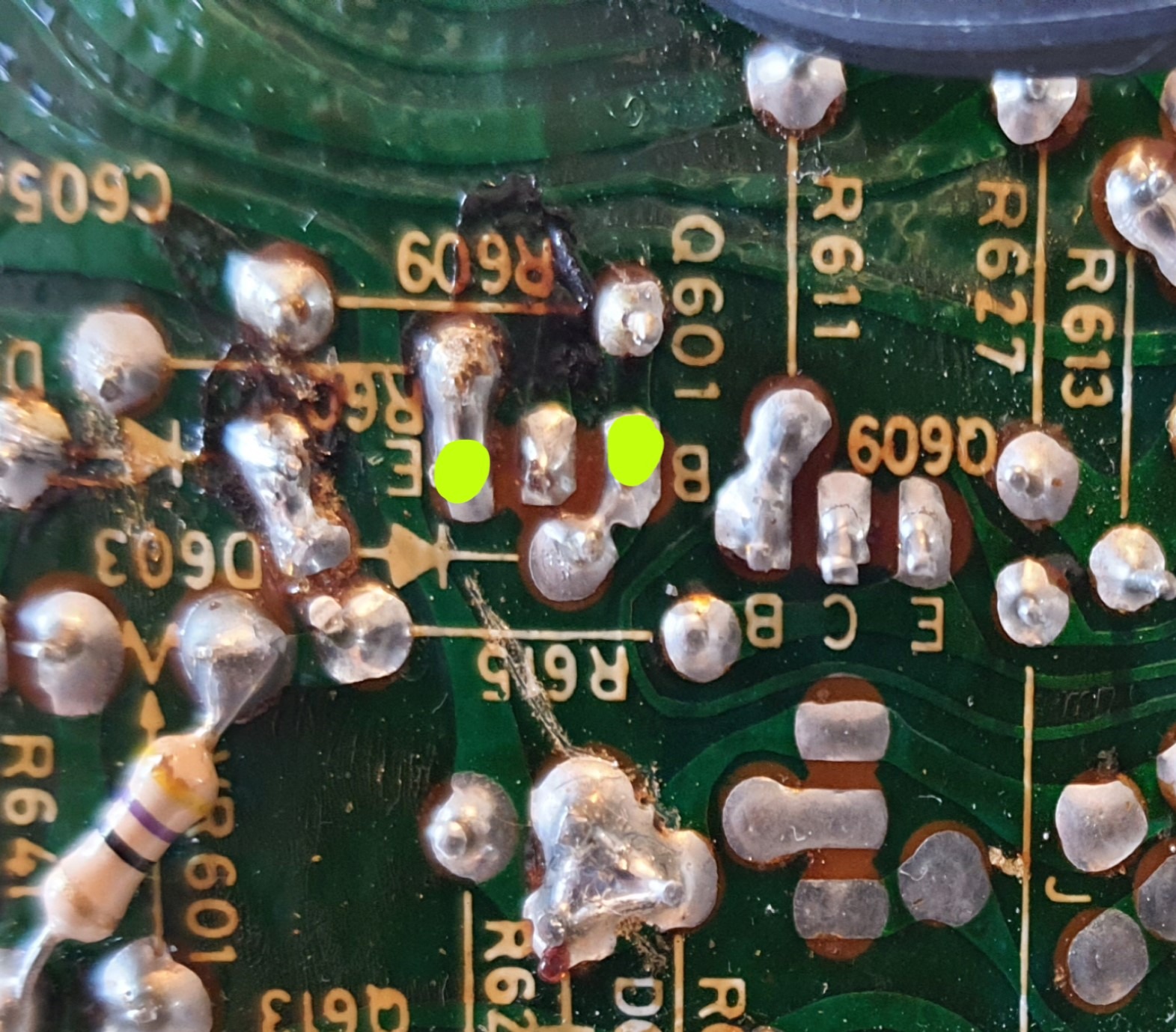

Please excuse my intrusiion.
Pictures can be very deceptive, but the R609 joint on right side (center), just above green edit mark, looks questionable. I suggest liquid rosin flux to get good reflow where necessary.
Agreed that Q601 current source is open. I suggest the following powered gremlin hunt: tie one meter lead to point F and probe your way down the D601, D603, R609 bias divider. There should be about 1.2V showing on meter at junction of D603 and R609. Any erroneous voltages should stick out and be easier to trace. Probe directly on component leads as necessary; integrity of parts, board traces, and solder joints are all suspects.
Assuming 1.2V on D603 the R609 junction, the same meter voltage should be present on base of Q601, and about 0.6V on emitter and its end of R607.
Another observation: R605 had 0.7V across in post 43. I surmise the current source must have been working at that point to deliver R605 bias current.

Hi Mooly and Bsst. So, Mooly, re your last; D601= 838
D603=838
Q601=827 pos lead to e neg lead to b (over limit with leads swapped)
R609= 075 (meter set to 200k) Then 15 climbing to over limit when set to 20k
Bsst re your comments; Point F to D601=.5v
Point F to D603=0v
D603/R609 junction = 0v all measured on comp legs (which was very difficult).

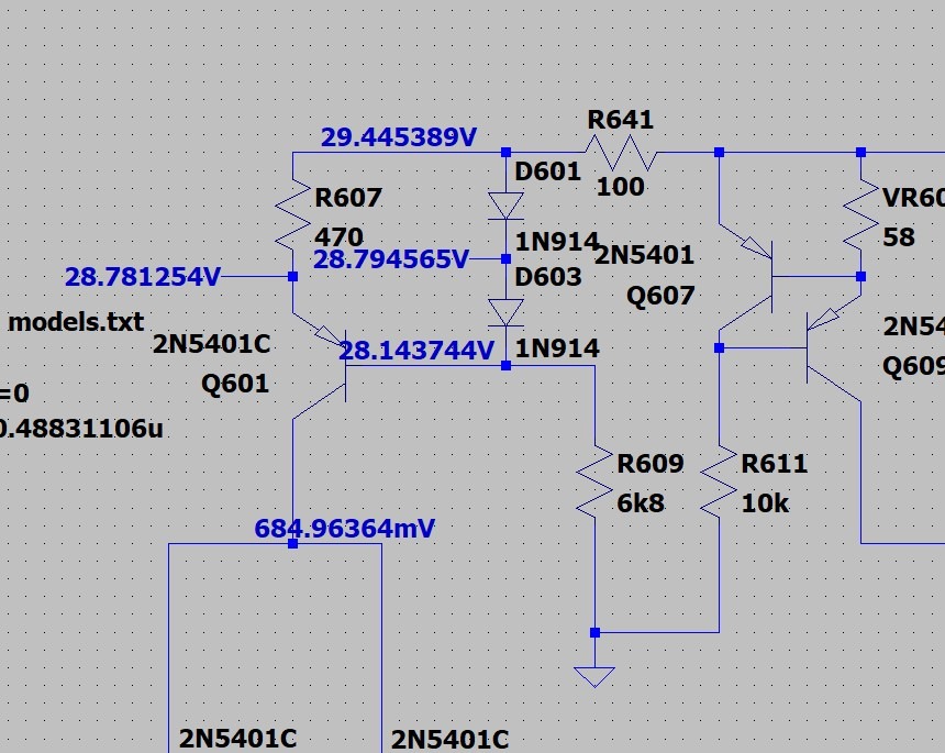

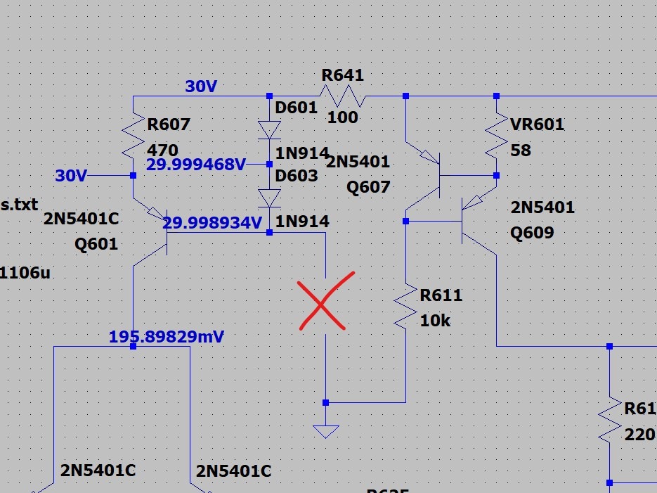

The 838 sounds OK, particularly as both read the same. It is actually showing millivolts dropped across the diode when the meter passes a small test current through the diode. So we'll say OK for that at this point.
R609 will need one end isolating (unsoldering) to get a true reading.
I did a hatchet job 😀 on another amplifier simulation (sorry Doug) and built it up into the Rotel.
You can see the sort of voltages you should be getting and the very important approx 0.7 volts across the diode and base emitter junctions).
An open R609 would give the fault you have (second image).
