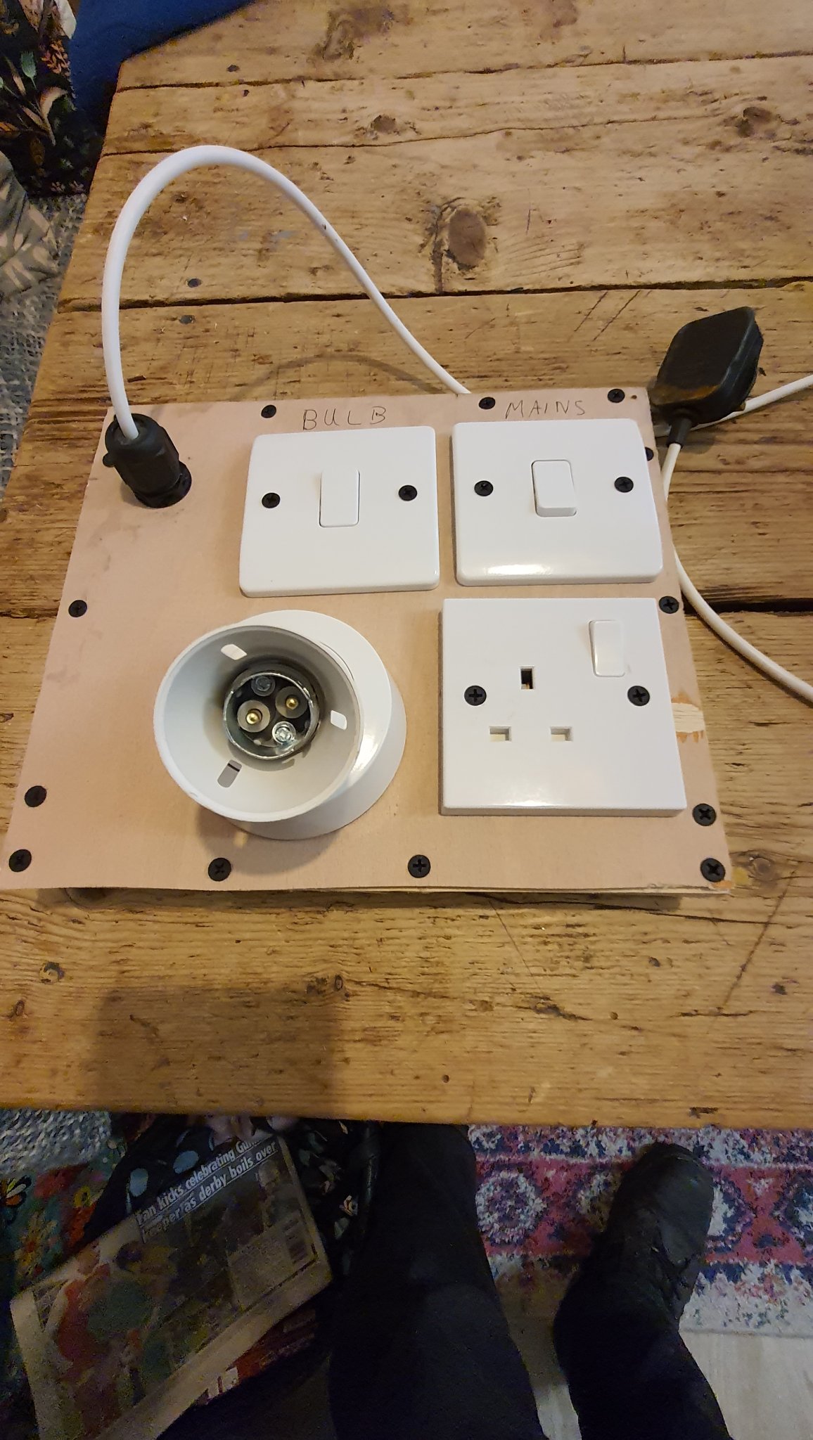

Hi Mooly, thanks for all the help. So I researched the dim bulb tester and knocked one up. Now it's made I can't find an incandescent bulb anywhere! Another thing; I read that I should use a bulb roughly the same wattage as the amp's cosumption?
If that's correct then going by the owner's manual i'd need a 310 w bulb! That can't be right, can it?
Re, running on one less set of transistors, I'm aiming to get this amp working as it did when new. The cost of any required components isn't much of an issue as far as I can see from looking at various suppliers sites. I'm not interested in krytonite plated boutique caps ond so on, but I would like to finish this project properly and to spec. Away for the weekend but will take powered up readings as soon as poss (and when I've found a 300w bulb!)
Try a 60 or 100 watt bulb 🙂 Those cover most applications.

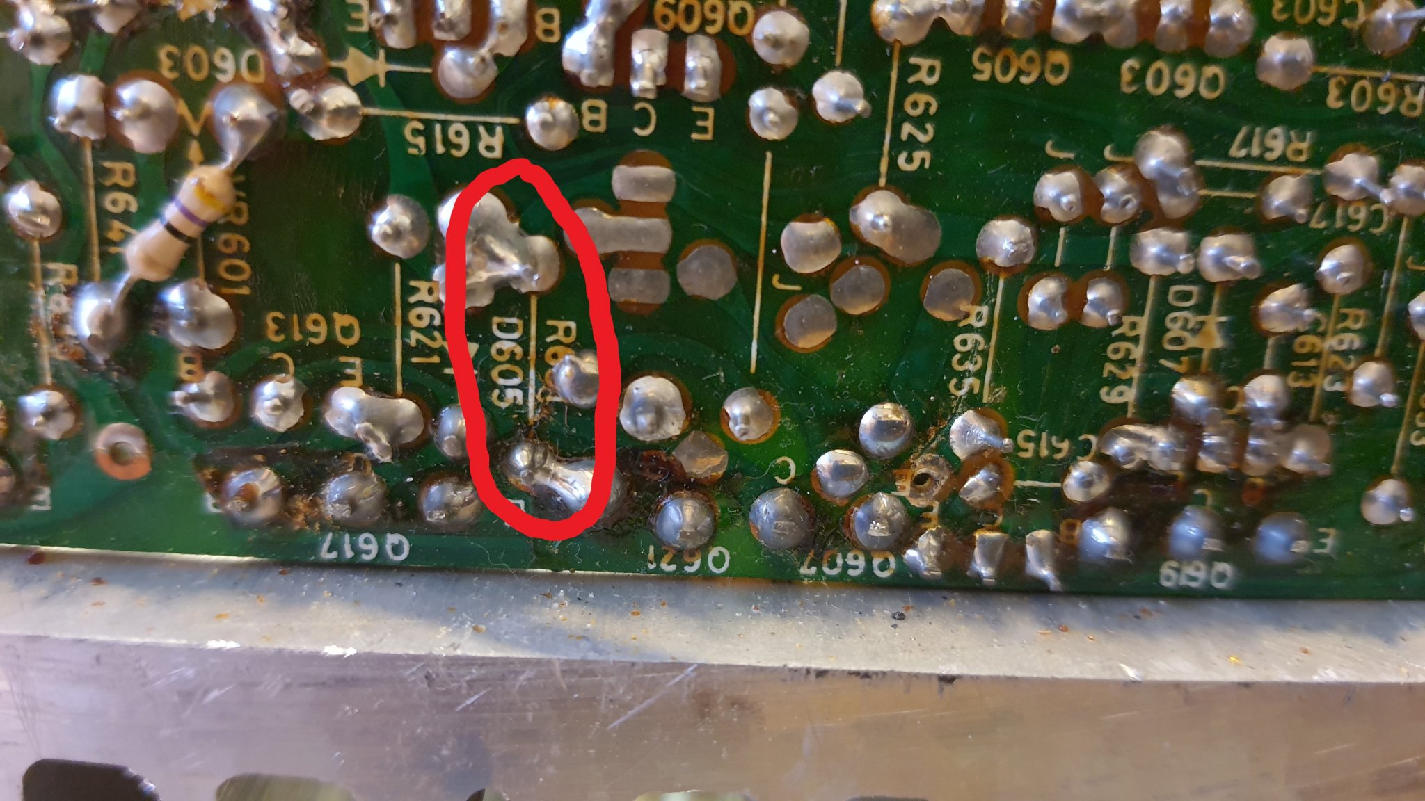

The .22 ohm resistor readings varied; r632 80 ohm
r636 .8 ohm
r634 32 ohm
r638 3 ohm I noticed it seems to be solder joined to other comps (pic), unlike the others.
r631 34 ohm
r635 .6 ohm
r633 1.5 ohm
r637 1.4 ohm

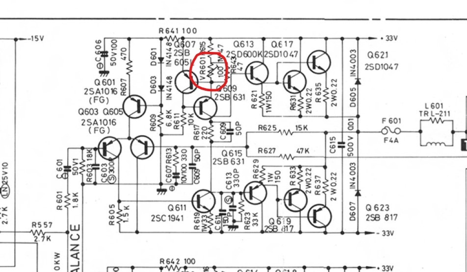

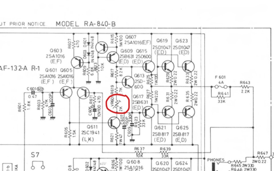

In order to help we have to know which version you have because although the circuit design is broadly similar between the two, the component reference are totally different. See post #27 🙂 You will see the transistor reference numbers differ.
Ok, I'm sure that I have the straight ra-840. This would be the 180800.jpg screenshot. The ra-840 b was (visually) entirely different with no tone controls and two transformers. The screenshot for that (154.jpg) shows, as you mentioned, the suffix E,D on the transistors which is omitted from the ra-840 diagram.

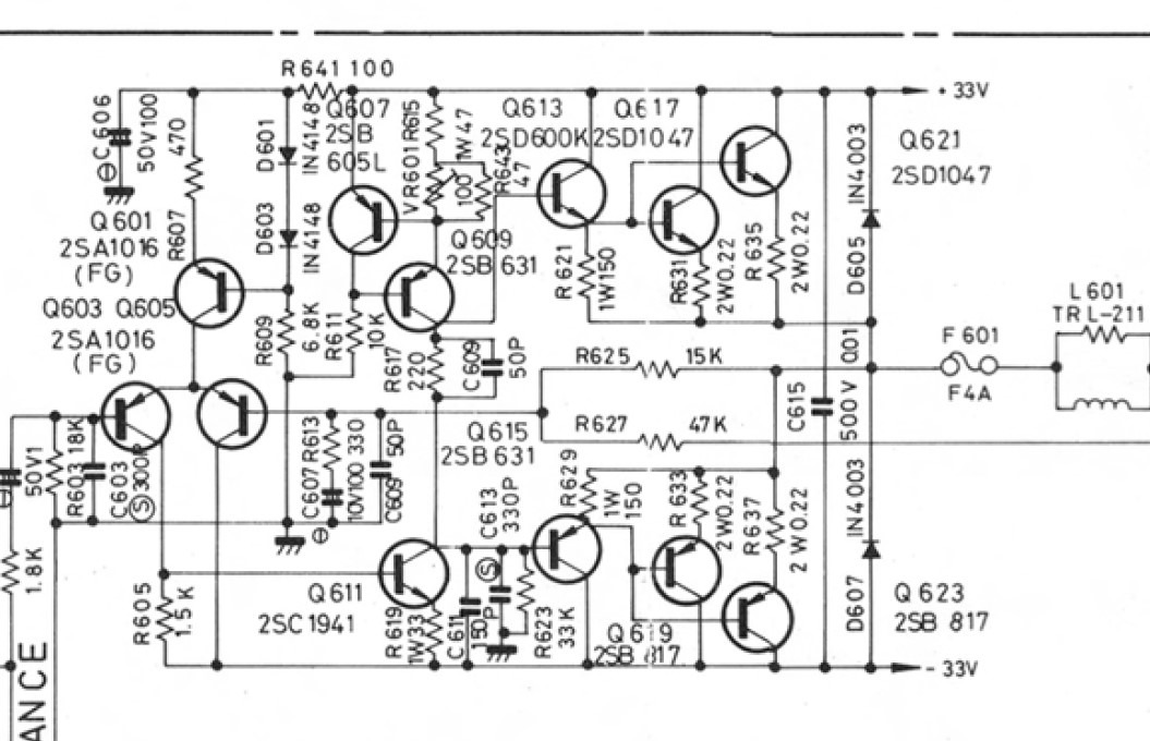

We need to get on top of these measurements as something is going amiss here 🙂 Lets go through it slowly.
Look at the circuit:
D607 connects between the negative rail and the amplifier output. This means the voltage measured on D607 anode (the end without a stripe that goes to the negative rail) and using ground (chassis) as a reference point should be no more than around -33 volts and a bit less with a dim bulb dropping the mains a bit. Now you measure 48 volts here. So something is amiss. Have I got the correct circuit? It is the standard RA 840 I'm using for this.
(Are you using the chassis (the zero volt line or 'ground) as the reference point for these measurements. That means the black meter lead goes here. The voltages you are seeing could perhaps be explained away if you were using F601 as the reference point)
Again look at the circuit...
D605 should see the positive rail on the end with a stripe (about +33 volts)
Do all the component references on the circuit diagram appear correct for for amp?
