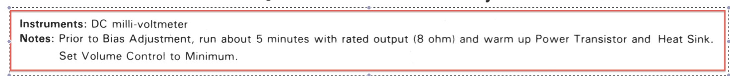

Also check quiescent current by measuring voltage across TP1/TP3.
I did this before, but didnt let the amp heat up for some time. Now after the amp is running for 10 minutes, its still drifting! But its possible to adjust quiescent current to around 2,5 mV after about 20 minutes

Eek!Just one more thing: After adjusting the quiescent current, my DC on the speaker output doubled!
Well, we haven't looked at the 0.22R emitter resistors yet (R645/47/49/51). Or the solder joints on the finals (output drivers), for that matter. I suggest you check both.
Loop gain seems to be very low.
An unrelated question:
Could it be that C625 is a 2.2 µF type and not, as I initially suspected, 2.2 nF? That would mean about a 34 dB closed-loop gain in the audible range, which seems more in line with what I'd expect and what you find in the power amps of other Rotels.
This is supposed to ensure that bias current is not excessive even when the amp is nice and toasty.
I suggest you decrease bias again until DC offset is where it was before.

Since I adjusted bias, my DC offset went higher Also I can't adjust the offset anymore with its trimpot
DC offset is not changing with load either...So, hmm shall I continue with the measurements you suggested before? I get a bit nervous now running the amp now for longer time...Still my connected headphone sounds ok when I play music...
