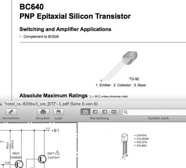

ROTEL RA-820BX3 not working

GoranB, there is a relay based circuit according to the schematic, but it is not a conventional DC protection. It appears to be simply for anti-thump and thermal overheat protection. It connects the current source made by Q607 to the VAS buffers Q609/Q611. If the relay or its control circuitry fails to energise, there will be no sound.
You are right, i just didnt noticed it. Thanks.

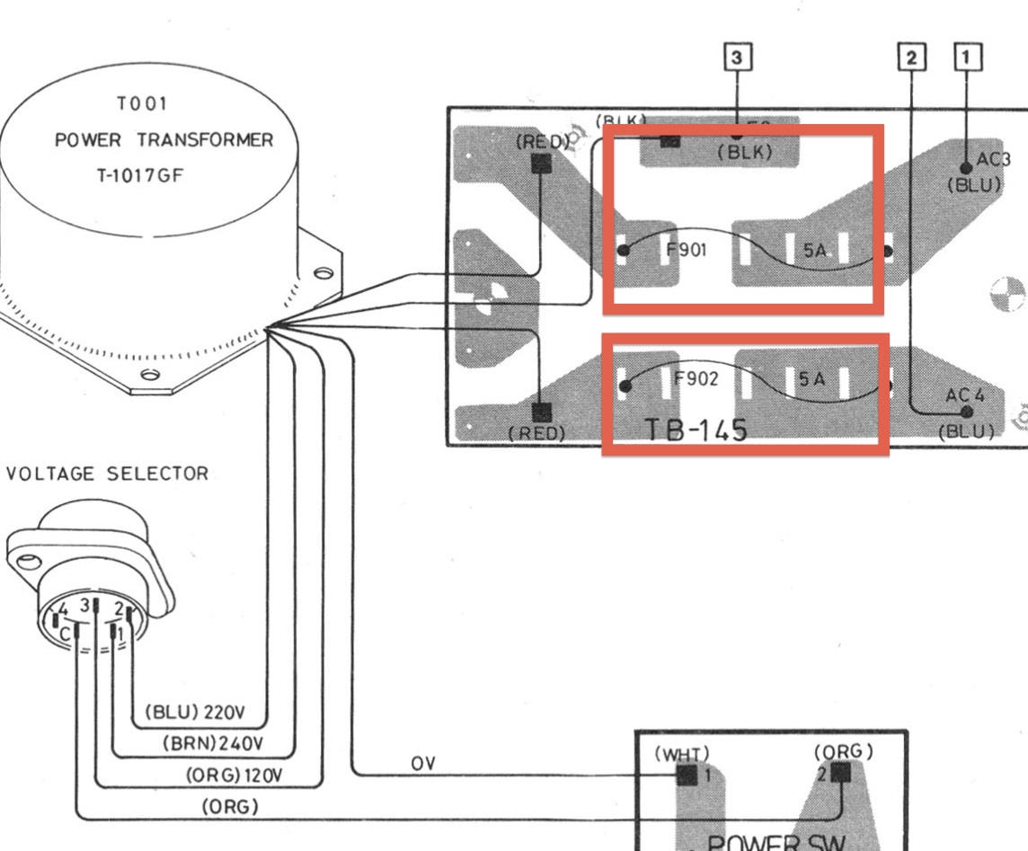

The low voltage not having 41 volts made me take off the fuses right after the transformer (F901/902), see attached pic...
The voltage which I measure there is 2x26,4 volts AC. If that means the transformer is faulty I have to give up. Exchanging the transformer would be to expensive for me. 🙁

This amp has 220 and 240V main selector.
In Europe the main had been changed from 220V in continental Europe
and 240V in the UK to 230V for norms unification purposes.
If your amp is on the 240V position , the supply voltage will be about 5% lower,
that is 2V , than the value in the schematic wich itself is given with a 5%
precision by the manufacturer.
Power output will be about 10% lower than the one measured with
the correct supply voltage.
Switching to the 220V position would increase the supply voltage
in respect of the schematic value by 5% and increase output power by 10%.
All in all , and considering the usual variations , your amplifier supply voltage
seems normal and you shouldnt bother about it.
It s best to stick to the 240V position, though , despite the slightly
lower output power.
The slightly low voltage will not be significant in this case. All it will mean is a little less output power. It could be that your mains voltage is slightly low, which would cause the secondary voltages to be low also. For 41V supplies you would need 29VAC on the secondaries.

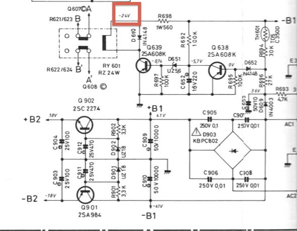

You say thet you have 3mV on the speakears terminals but if the relay is not closing that is irelevant.
Try to measure from the relay terminals to ground and post the results
Any DC on the relay pins will enable the speaker protection.
Good luck
I am measuring 37 volts on the coil of the relays. I should measure 24 volts instaed 😕

Yes, but when I started measuring voltages on transistors yesterday, some were really 4 volts lower then the the ones on the schematic. So, should I exchange Q638/639 now? I could get BC 640 for them easily...
that is correct cause you measure the relay pin in reference to ground at the specific circuit 24 volt will be present only between the relay pins and not in reference to ground
As i said this is secondary ...you may as well, jumper the relay but only to test if the rest of your amp functions and only if safety measures have been taken
I dont understand, as on the schematic is written 24 volt on the coil...
yes but in reference to the relay pin not reference to ground
and one way or another please take your brain and eyes from this .... for testing procedures only the relay can be bypassed .....
( the related circuit will actually "regulate" the ground to 24 volt not the + so that is why you will always measure rail voltage there = 37 volts )
