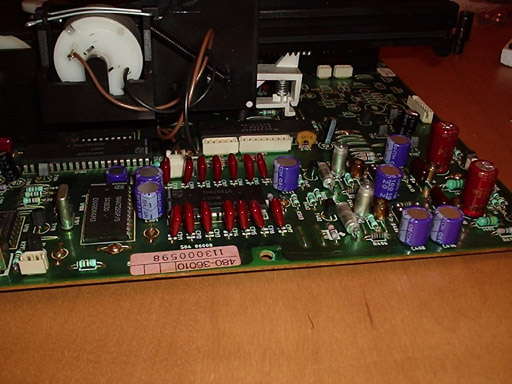

Had a buddy of mine remove some of the Black gates and replaced them cerafines (output) and oscons. Aslo got rid of the blue philips caps and dropped in some polystyrol caps. Doing op-amp rolling right now - AD-825 (on LC Audio's type 3 module), BB OPA 2227P, OPA-2604AP, OPA2132P. Also have some OPA 627 but I need to find some brown dog adapters (sigh). Anyone in sg sells these?
Basically this is what he did:
Replaced 4 x100uF/25v BlackGate F with 100uF/20v Oscon SH
replace 2 x100uF/25v BlackGate F with100uF/35v Cerafine (output)
replace 3 x 100uF/25v generic (labelled SME) with 100 uF/ 20v Oscon SH
replaced 1 x 47uF/25v generic (labelled SME) with 47uF/25v Oscon
replaced 2 x 1.0 nF film cap (philips) with 1.15 nF silver mica cap
replaced 2 x 2.2 nF film cap (philips) with 2.2nF polystyrene film and foil
replaced 2 x 2.4nF/ 2 x 5.6nF and 218nF with similar values polystyrene film and foil.
Intend to do the following at a later date:
replace the 4.00 Mhz crystal (ceramic) and replace the 7220 with NOS
BTW I do like what I'm hearing with the OPA 2227p op-amps.

Well, over the w/e I replaced almost all electrolytic caps (with mostly Sim Lim quality, which is sometimes Elna or Rubycon or Panasonic... and for some values, just generic). Then I added X7R small caps to the TDA1541 decoupling. Added a PSU for my DIY analog stage (JFET I/V and OPA2134 based lowpass, plus DRV134 balanced out). Changed some wiring. Put blue tack on the quartz and grounded it. Installed 3 prong plug with RFI filter. Cleaned the laser and tried to fiddle with its power through a pot I found on the PCB near it (but that didn't give the intended result so I set it back to where it was). Lubed the mechanics of the laser with motorcycle chain wax for the tray and motorcycle oil for the ball bearing. Tried to add a PSU for the +- 9 V pat, but that didn't work - display out - the original PSU must be connected in a specific way and needs the original wiring layout for fuctioning I guess.
Result: still works 😉 ... I like it better than my DVD/CD player with or without MSB Link DAC. Strangely, through headphones I can hardly tell a difference, but through speakers I like the soundstage of the NOS Rotel much better.
Anyway, op amps: I used a lot of 2134 and I like them. I tried 627 for I/V, but my generic prototype board from Sim Lim was probably too soggy, and in spite of my best decoupling efforts it oscillated...

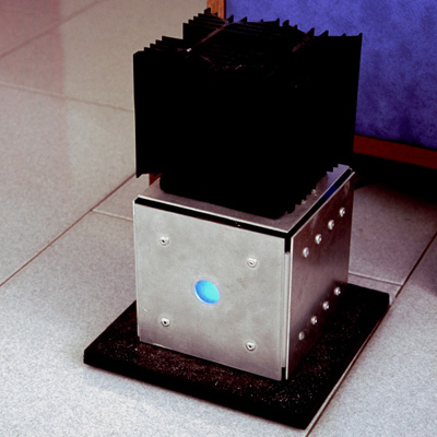

May I add my dipoles and Mini-Aleph monoblocks are pretty cool too 😀 . Here I skipped on the band aid and used rivets...
Drop me an e-mail offline...
