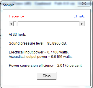

Can these Rossos give me 96db flat and clean down to 33Hz inside the booth without a large price and weight hit on the battery bank? With the front shutter/awning up and the front open, can this project like a horn as in the car discussions and provide a larger output due to the box ina box thing?
Near enough with just one Rosso based on its HR 29 Hz Fb max flat BR sim, though requires a 406+ L cab to do it.
Thanks for confirming that. I want to use a pair to iron out booth vibrations when used internally. Don’t really know if they can carry the effect to the booth structure but can’t hurt and the output of two cabs would be welcome under generator power for hire outs
My better and duskier half fully supports this project 🥰
Only 1w would be enough? That would be brilliant and will leave funds for higher quality power supply and internal audio. The ambience of tubes would be perfect and I have a 12v to tube PSU and the EL34 kit. Another kit and I would have the potential to get the subs on tube power too. With that kind of consumption, just one battery might be enough. This is getting better and better. I can have night time charging too by exploiting the roof exhaust and build a whirlybird type system to generate power. There is always wind here
