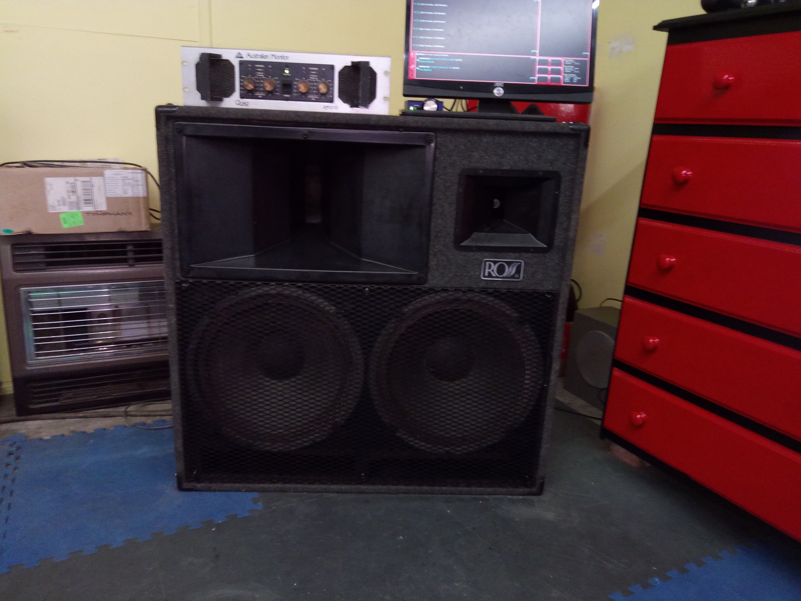

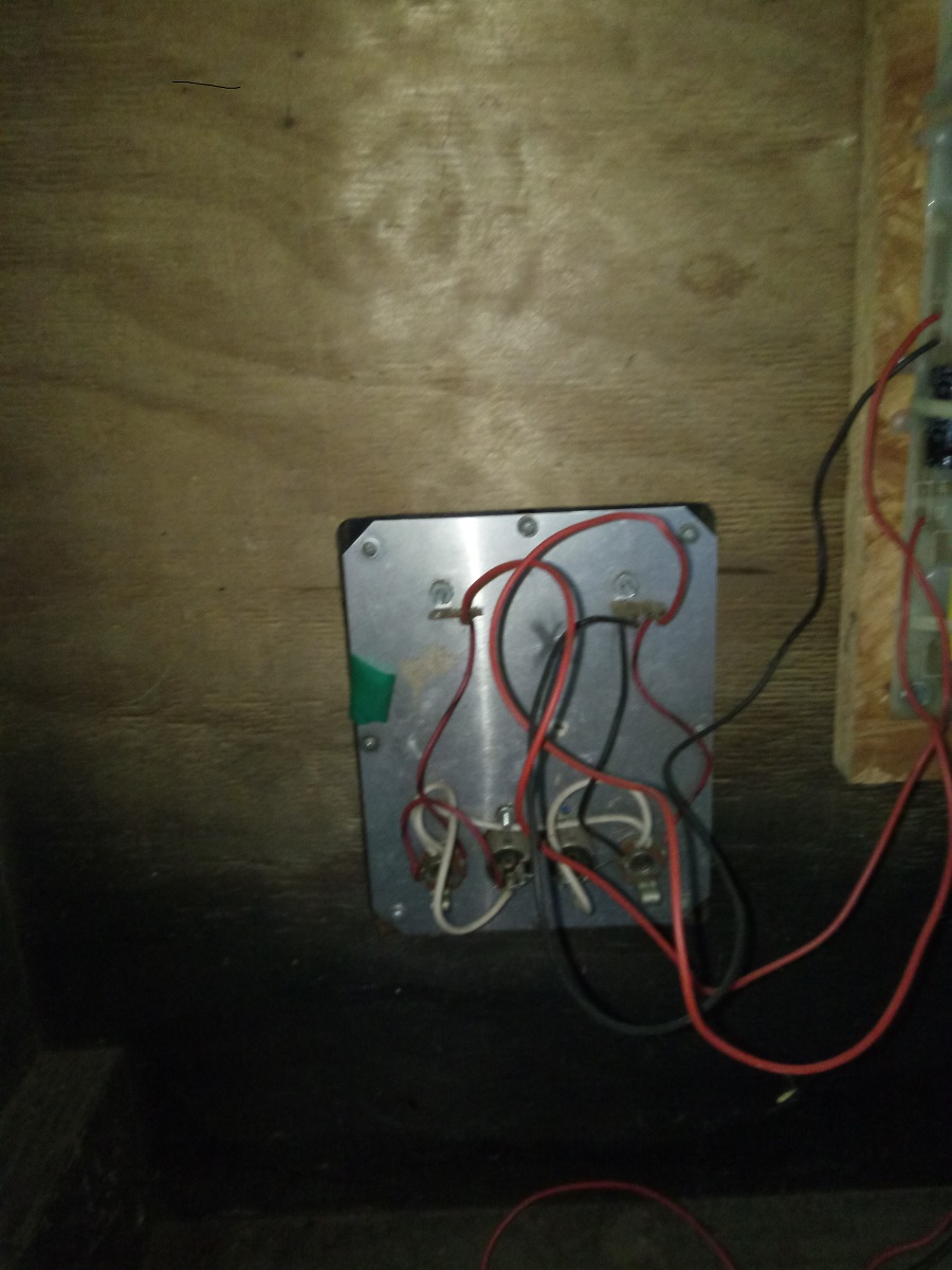

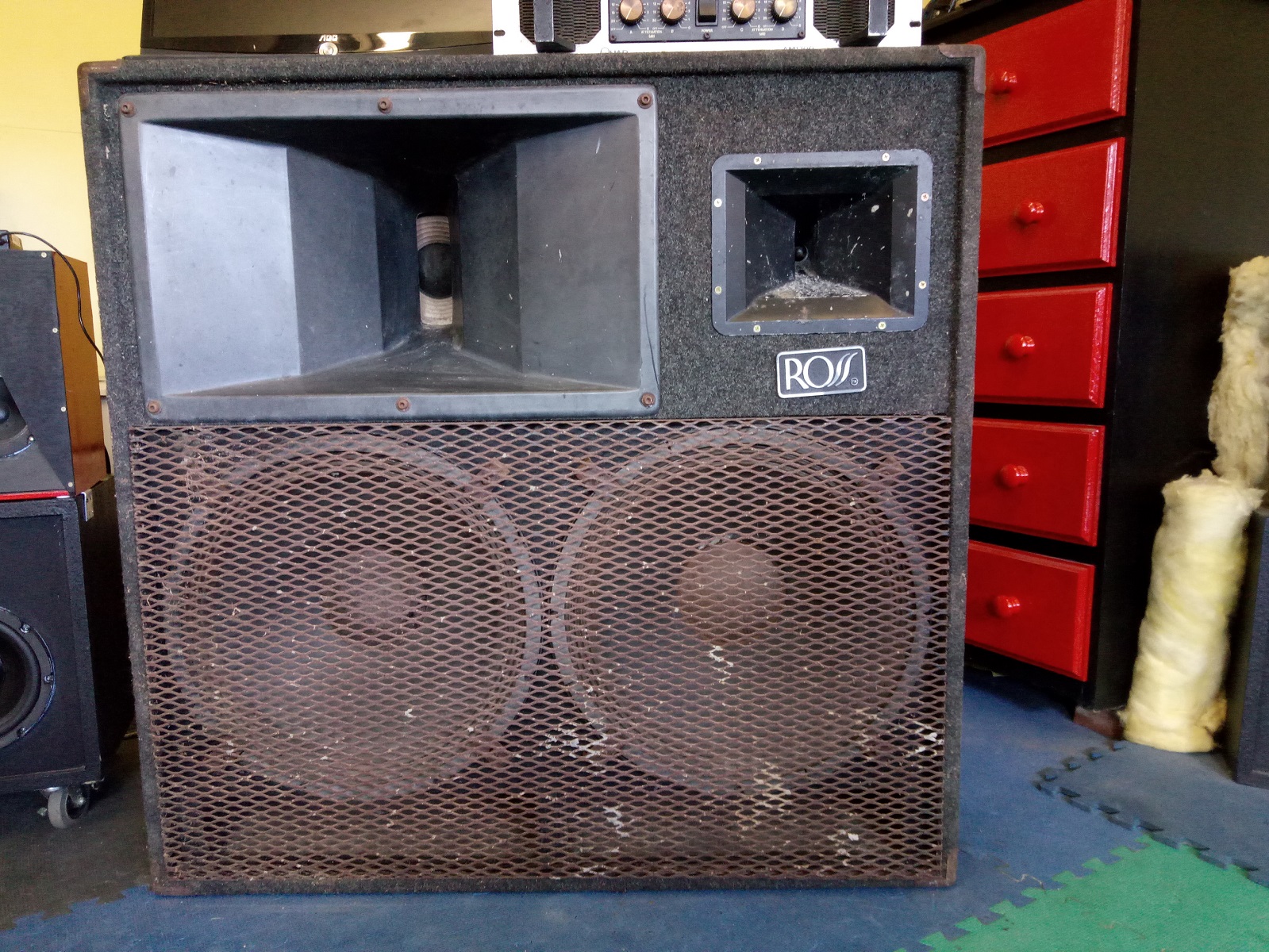

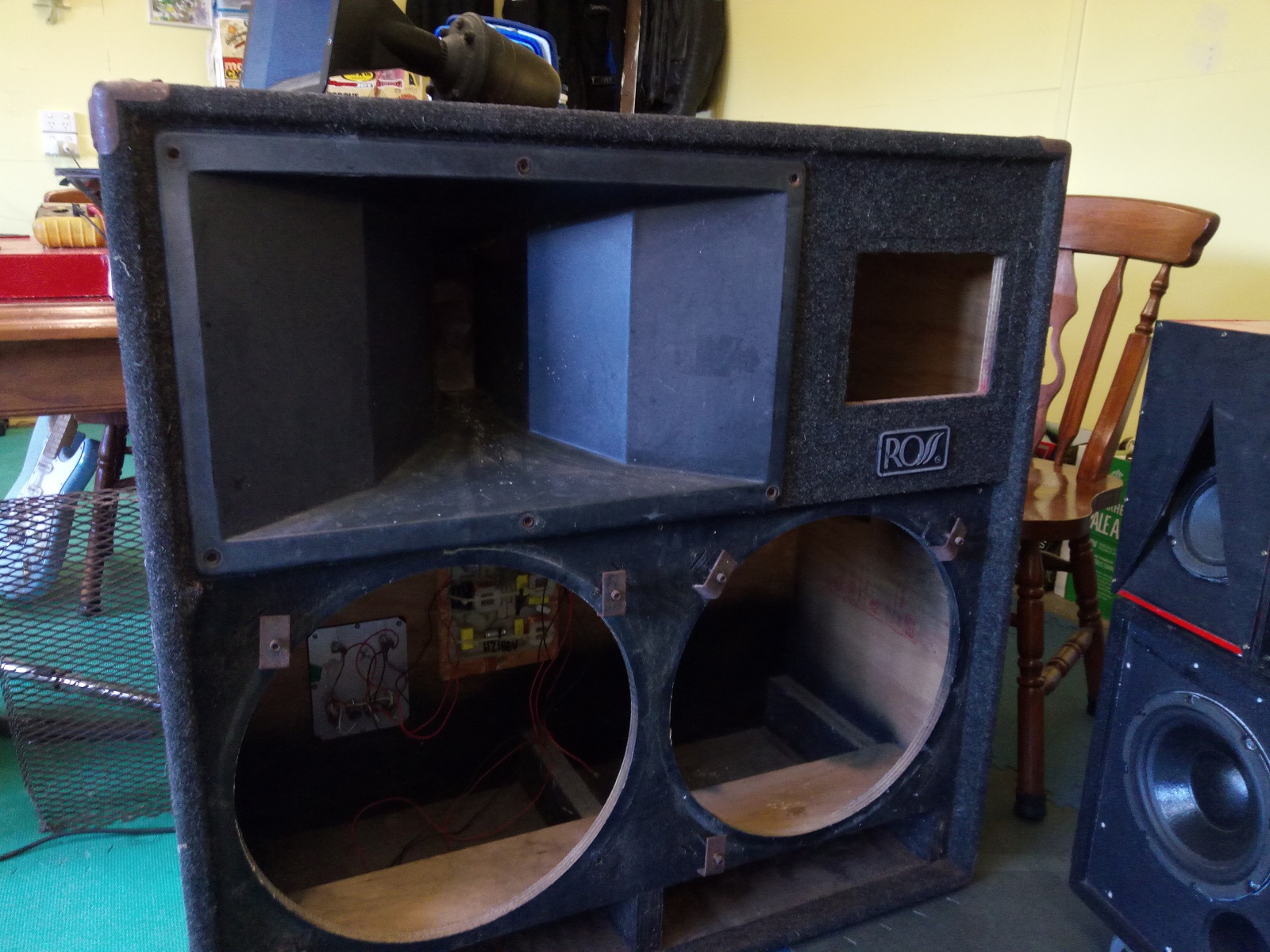

I scored a pair of these last friday for $0 and have been looking for info.
One works but has replacement mid range and no tophat. Piezo is Powerline.

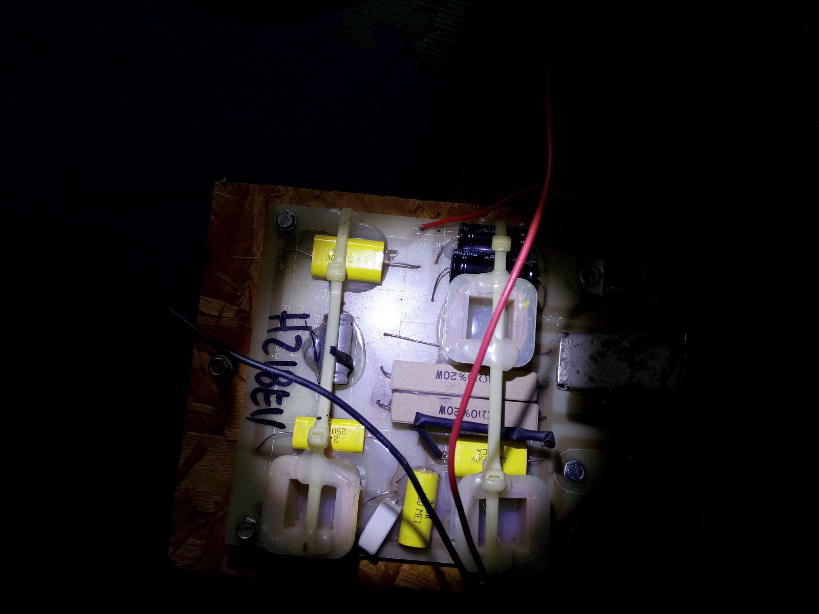

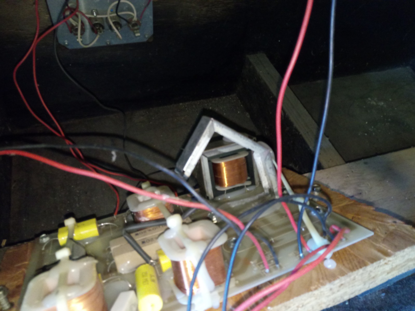

Other has "exploded" transformer with bits stuck on woofer magnets and open circuit compression driver. Lack of information is frustrating and great to find info here. Original mid works and has black cone and brown cap (pushed in).

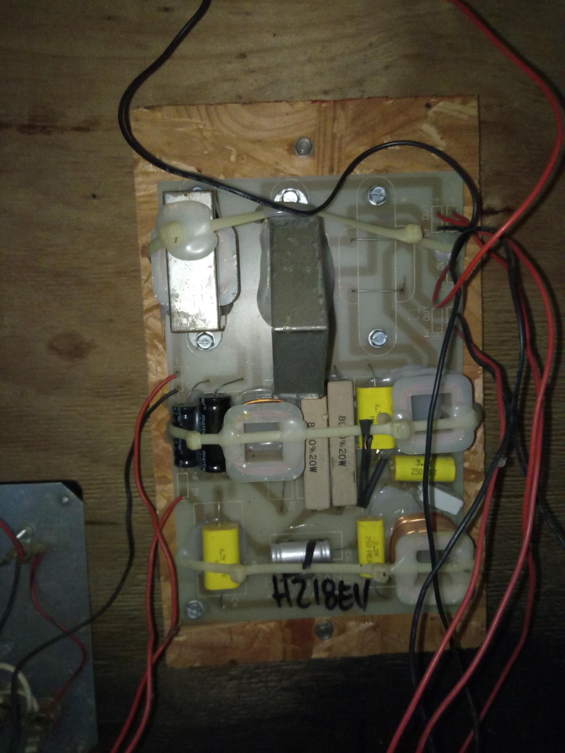

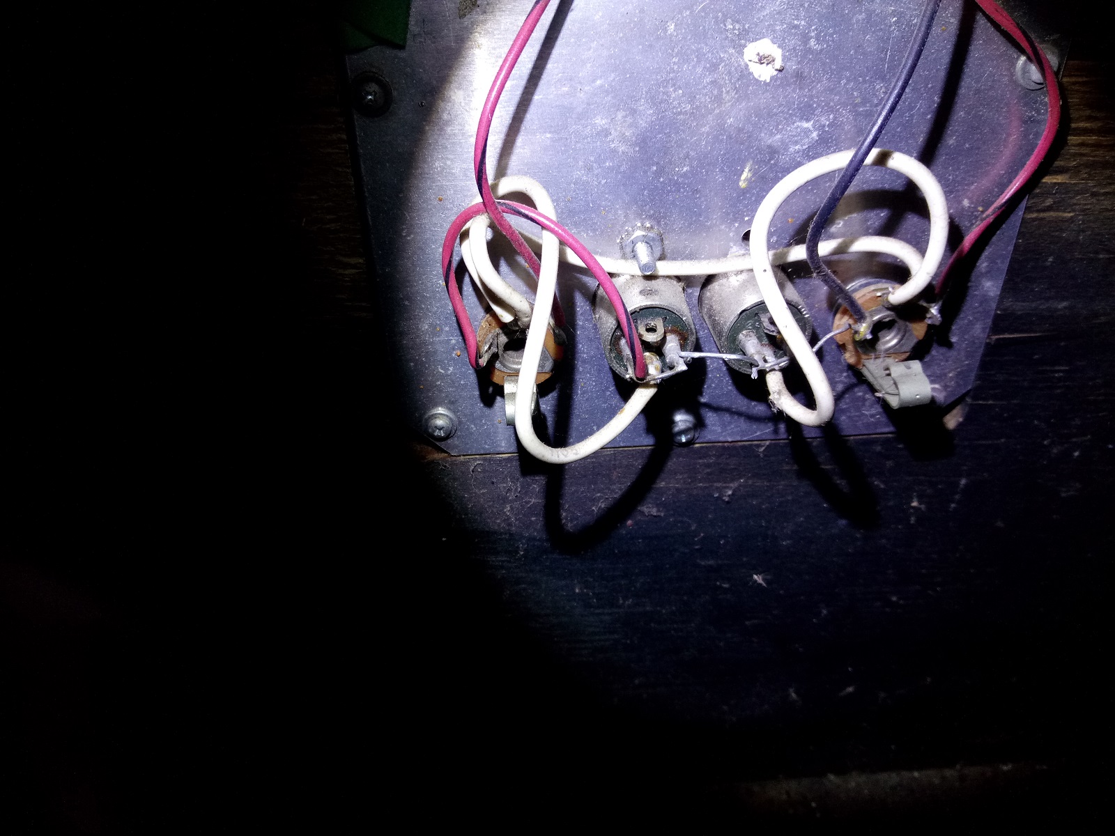

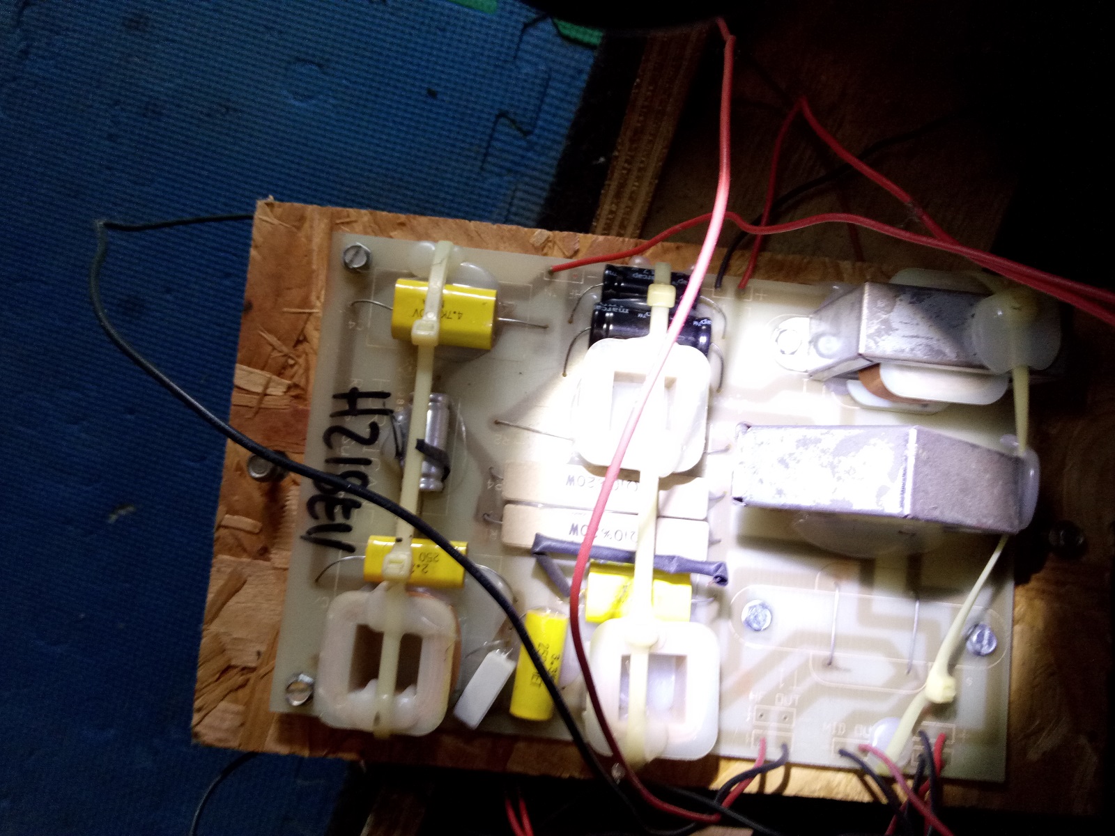

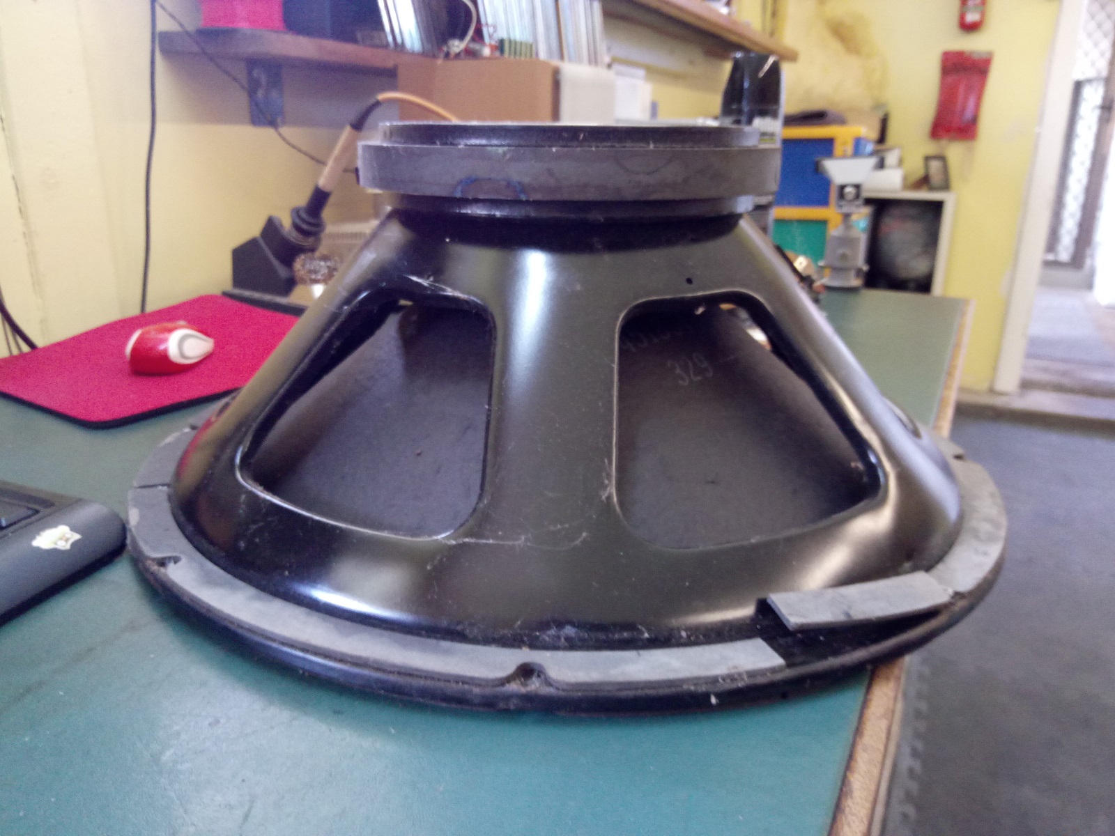

Just added pictures of woofer. My crossovers look different and there is a single tweeter. I have seen one other picture like mine and it was called a 218 HL.

Thankyou for the quick reply. A friend is moving to Tasmania and had these in his shed. I couldn't get there quick enough. I will post more as things get done.
The mono and biamp wiring is a bit confusing. It's an inductor that's blown. It's labelled L2.

Definitely an update with your crossover as well, mine have iron core inductor coils, and I see some of yours are air core.

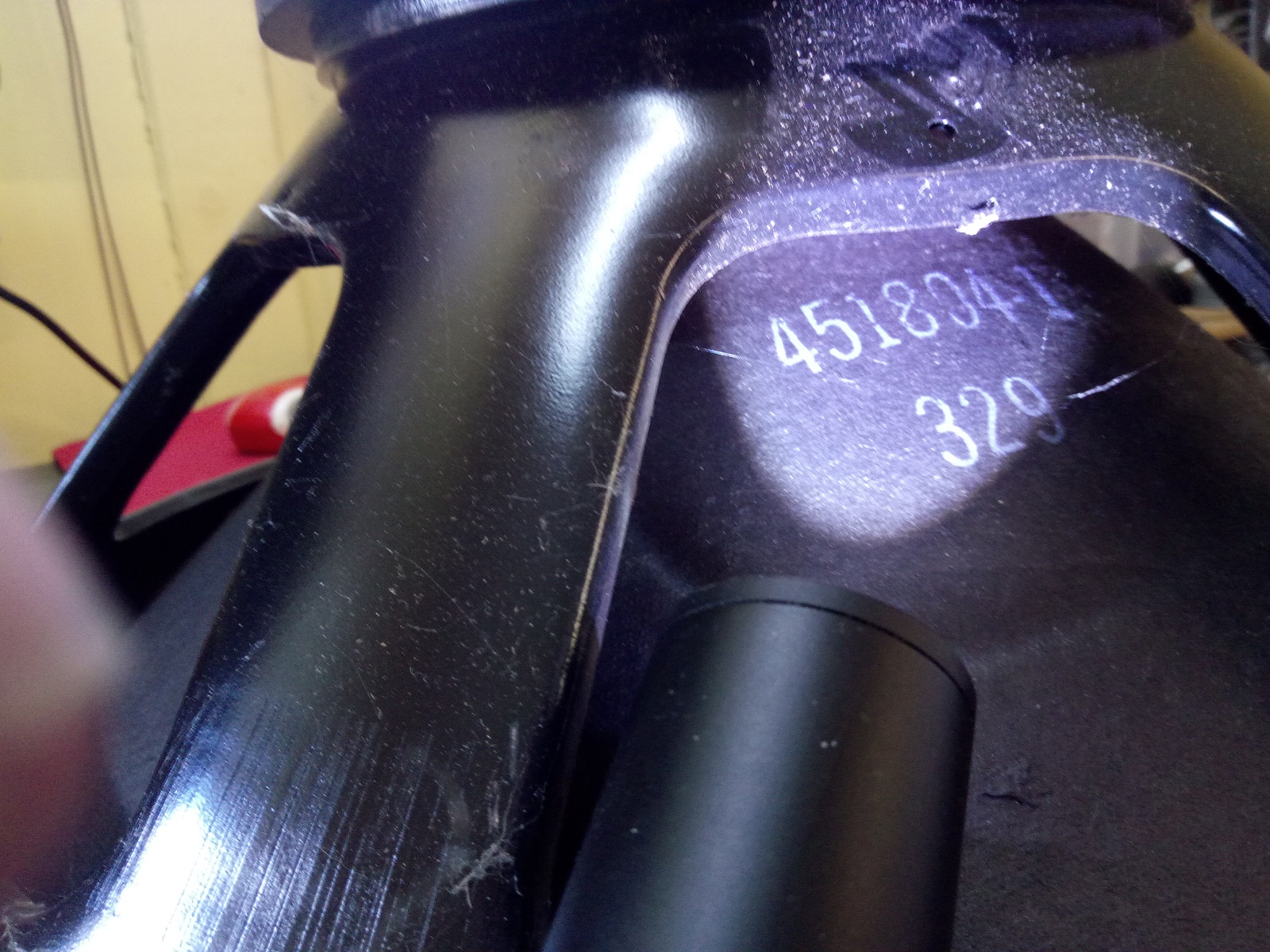

Yes, bottom line: 67-8950-G or 61
top line I think: 180371 8ohm

I think he was penny pinching to reduce costs,eg: crossover boards can be used for your setup- still has 2 HF outs; place for T1 (never installed on mine).
Also neither of mine has any bracing, which will be installed.
Finally, I have no idea what I'm going to do with them. I've got a old iron 600W amp p.c. hooked up to one and keep sneaking the volume up.

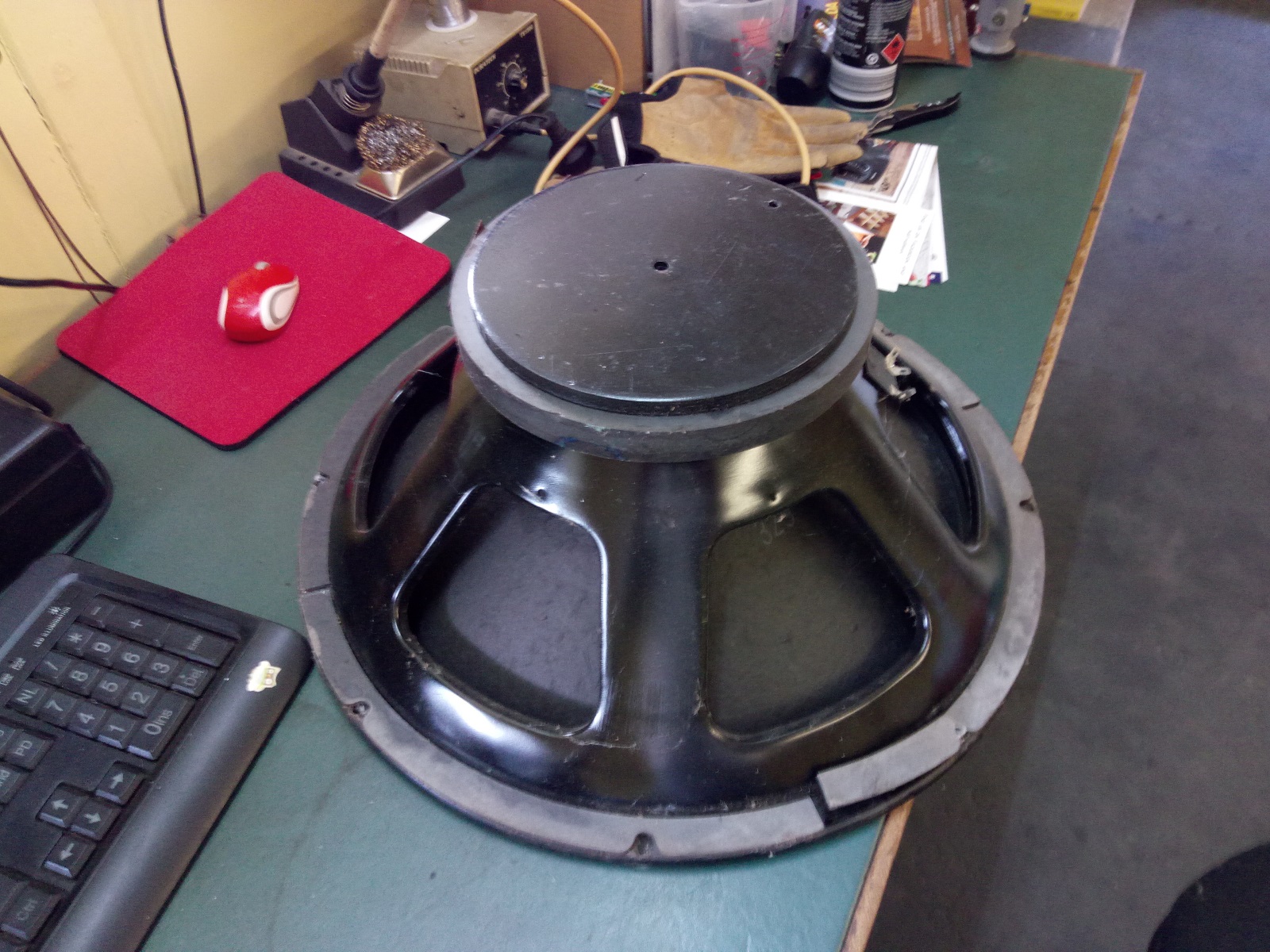

This means for one of my woofers:
180371 8ohm
67-8950-G1
18=size
0371=371st speaker produced
67=Eminence
89=year made
50=week made
G1=metal type (pressed steel)

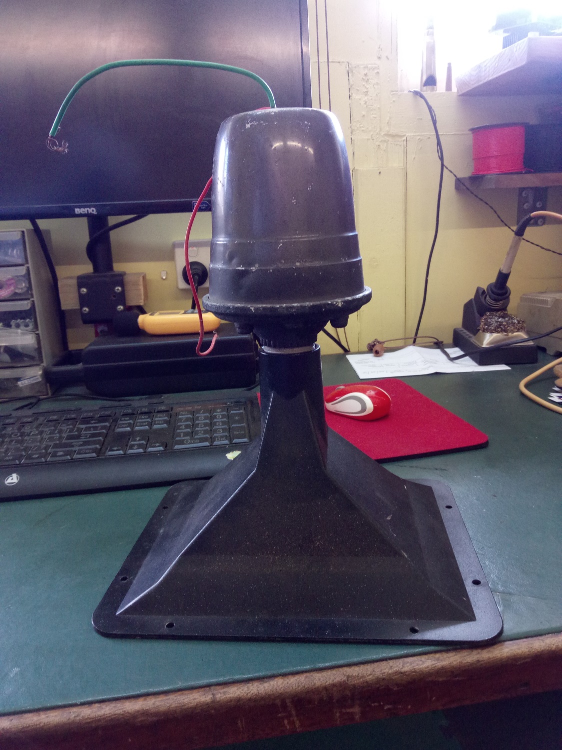

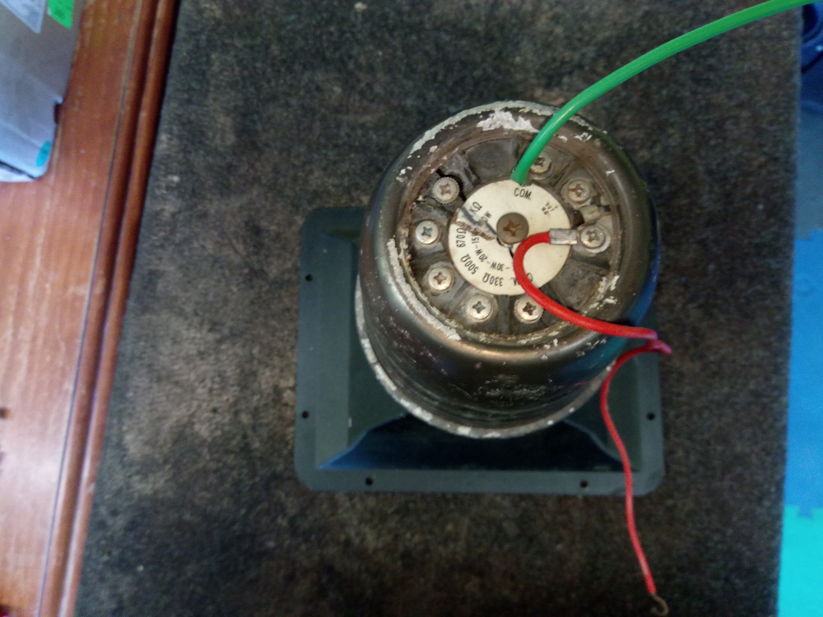

I didn't notice that date code was given on page 2. Unsoldered the leads.
Got the mid separated from the horn. How did you get the hat off? Where does it come apart?

You mentioned yours are poorly braced. I was actually surprised at how well mine are braced. They make a nice solid higher pitched tone when rapped on the sides than other speakers I have had. In fact I have a set of Wharfedale monitors that are as light as a feather, rattle their front grill, and sound tubby with extra artifacts thrown in there when rapped on with the grill off. So I am not really concerned about them when I see a water bottle or other random stuff fly across the stage.

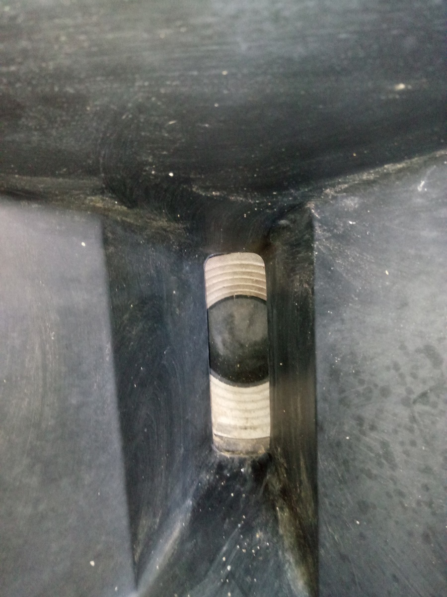

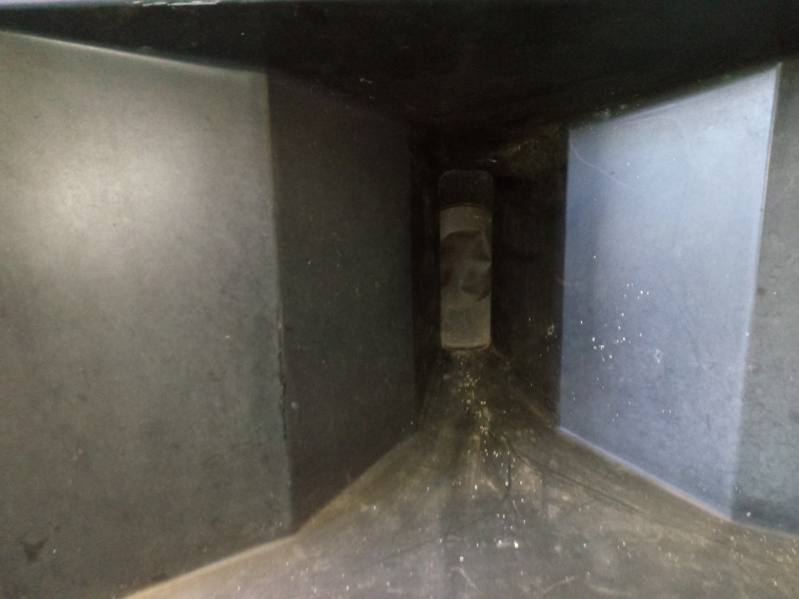

Thanks again for the reply. I got the mid cover off easily by running a sharp knife around the join (once I figured out where the join was).
I had another look at the old compression driver. When I stuck a battery on it, it buzzed. I installed it the working box and all the scratchy harsh treble is gone.
The sound is very good.

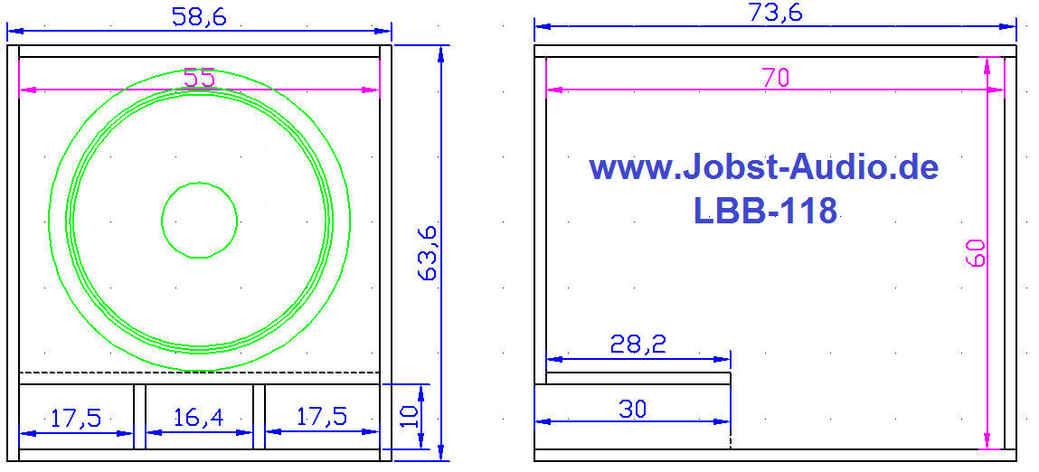

My Sigma 18A's are in fairly large vented boxes and they really kick the bass out.
I have a sub design for them that's 3dB down at 38Hz, but I agree for low bass I would pick another Eminence driver.

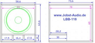

I wasn't saying my speakers are 3dB Down at 38Hz. It says that on attached plan from Jobst Audio- found on Speakerplans forum I think.

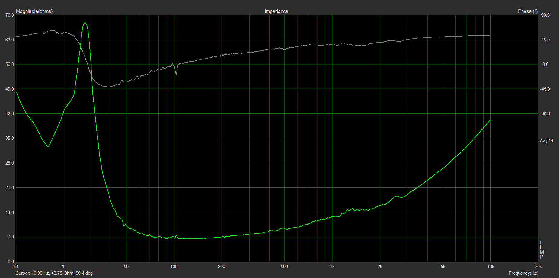

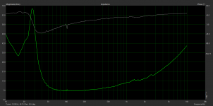

I tested one of the 18's.
These are the parameters:
