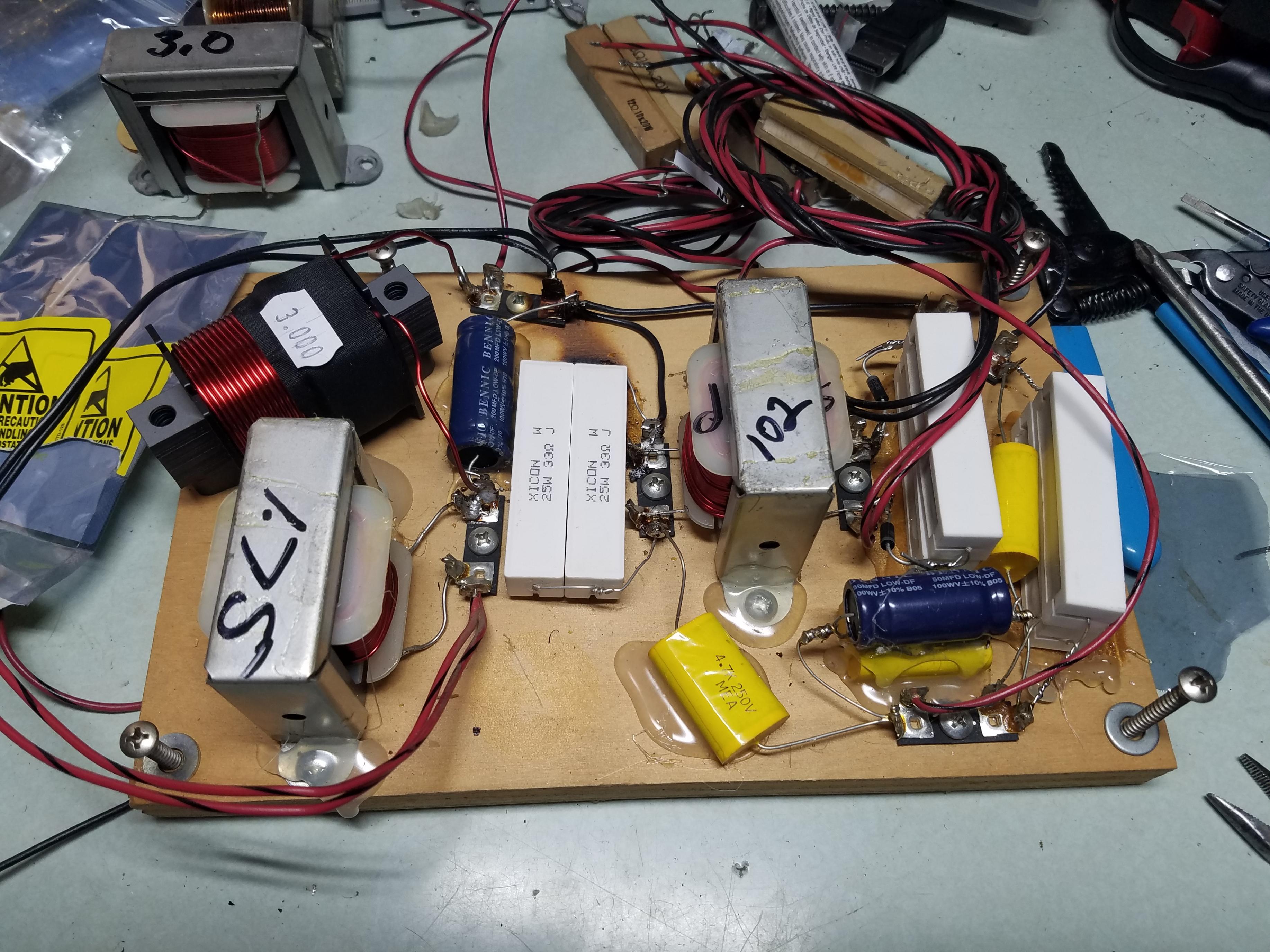

The other crossover turns out to be worse.
The 16R resistor on that one reads as open, and one of the leads was broken off at the mounting tab. Black painted board concealed the very burnt wood under it.
Both of the protection devices on the secondary of this one have blown out.
Also, the 3.0mh inductor has been Way Too Hot and needs replaced. Fun fun fun.
Found more resistors out of spec so what the heck all resistors will be swapped out. I'll replace the 10% 16-ohm 20w with 5% 33ohm 25w in parallel. The black crossover board has a pair of 8-ohm 20w in parallel on the transformer secondary and one of them is an open circuit. On the midrange side where there's a 12ohm in parallel with an 8 ohm on the black one that is reading 3.something ohms which is certainly not right.
So, all resistors got to go. getting 25w xicons from mouser along with the 5w zeners.

Well, the 1.75mh coils are ok, and the transformers are ok, and the foil caps are ok . . . .
Really one of the 3.0mh coils is good, the other one is baked. I'm waiting for my pro audio contractor friend to show up online so i can ask if he has some coils on hand. it will cost a bit over $50 to get a pair of matching 3.0mh 14ga coils from ERSE and the website indicates that they might be backordered.
Resistors aren't expensive. I don't think they're really scrap, just, there's plenty wrong with them.

Got my shipments from madisound and mouser, done the soldering part of rebuilding the crossovers.
Madisound's I-core 3mh 16ga choke is probably superior to the original EI-core. Wire seems bigger. I bought two so my crossovers match.

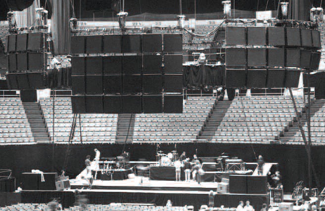

By then Bud Ross had 25/30 years on Live and MI sound under his belt, he was no fool and designed a practical low cost product which performed well, by 80´s standards, no doubt many performing bands as you mentioned used these.
I see them as a poor man´s version of Clair Brothers S4 all-in-one system:
which was THE PA cabinet way back then, used by *everybody*
Obviously yours were overdriven by clipping amps, which killed tweeters, damaged crossover, etc, but if separated and biamplified (say 300W into 4 ohms for Bass and 50/80W for mid/highs with a limiter setup to NEVER clip) they will work quite well.
And if highs never clip, Piezos are quite acceptable, now when you have clipping they can be UGLY, so just don´t clip.
The woofers are CTS (early Eminence) and should be good for about 150W RMS each, which is not bad, considering the intended use (unless you want to go on Tour with Slaughterchrist, that is 😉 )
In a nutshell, getting new Piezos, replacing a couple passive comonents and Zeners and biamping should turn them into something quite usable for headbanging.

Alright, crossover refresh parts list. For one pair of HD218-CD.
From mouser -- these parts are cheap, so replace them all. Maybe double up on zeners just in case?
863-1N5357BG Zener Diodes 20V 5W 4
280-CR25-33-RC Through Hole Wirewound Resistors - 33ohms 5% 25W 4
280-CR25-8.2-RC Through Hole Wirewound Resistors - 8.2ohms 5% 25W 6
280-CR25-12-RC Through Hole Wirewound Resistors - 12ohms 5% 25W 2
From Madisound:
m200 Bennic 200 mfd Non-Polar Electrolytic Capacitor 100V 2
m50 Bennic 50 mfd Non-Polar Electrolytic Capacitor 100V 2
If the 3mh is cooked:
sl3.0 Steel Laminate 3.0 mH 15 AWG Inductor
-OR- ERSE ESQ55-14-3000 3.0mH 14ga ESQ - Super Q Coil.
.124Ω - 600w
Both of these are lower DCR than the original EI core so you may wish to replace in pairs (or hit me up for the good one i pulled)

Lots of work going into your crossover rebuild. Personally I think the crossover design is ingenious, simple and effective. I do expect you are right about the old vs new coils.

It's not so much work to repair the crossovers. It is disappointing that so many of the resistors and 3 out of 4 protection zeners were blown, but it's reasonably simple to just replace the lot of them. It was less than $20 including shipping for all of those parts. The capacitors were replaced on principle - 30-year-old electrolytics are presumed to be degraded.
Having to replace the 3mh coils, eh, yeah, that was a bummer from a financial perspective.
It was an hour or so of soldering and hot glue once the parts were here.

They *scream* 70/80´s live speakers, .... so play 70/80´s music through them 🙂
The numbers scribbled on things indicate that these were built in December of 1987.
We were told that this band played more than a few gigs on them: Slaughterchrist - Feast of Consumption (YouTube)
Wait, the scribble on the back of the xover board was 10/12/87 so october 1987.

Reinstalled the crossovers and one pair of tweeters tonight, and reassembled one midrange assembly. Not going to monkey with it until the silicone on the hat cures.
