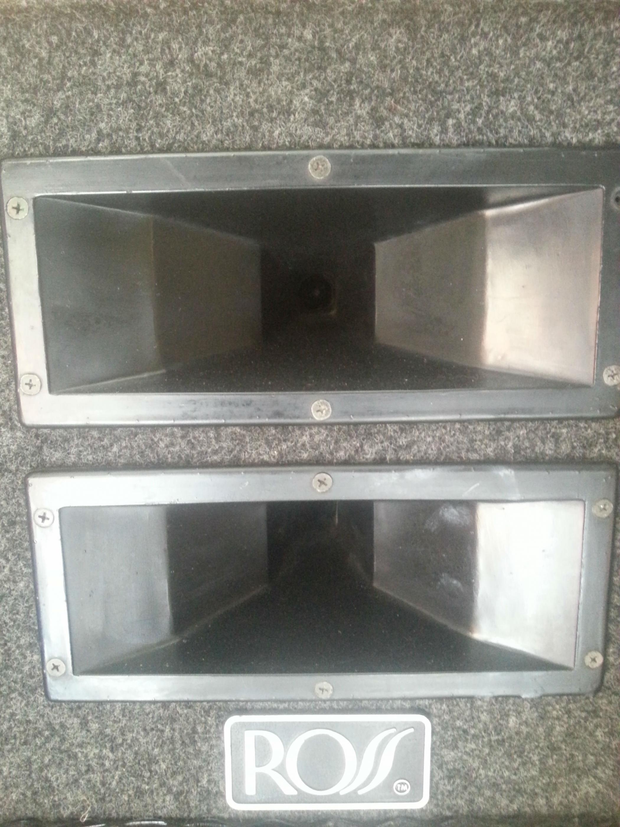

I'll add more photos to the album over time. And yeah i noticed that a resistor appears to have been on fire at some point.
They seem to mostly work. some of the connectors need some deoxit and maybe a rifle brush. I am pretty sure that speakers rated at 1kw RMS maybe ought to have internal wiring fatter than 20ga. I have already ordered new 'lytics from madisound.
Thing is i just have squares of masonite where the dual tweeters should be.
My guess, based on the vintage, is that they may have been the motorola piezos that were so popular back in the day.
Does anyone actually know? Parts Express sells a Goldwood horn that is the spitting image of the tweeters in the rest of the Ross Systems line. I can't find a photo online of an H-218CD. PE also has at least 3 piezo tweeters that claim to be clones of one specific Motorola piezo tweeters, and opinions of them would be welcome.
I'm also aware that those horns might not provide full or loud enough treble next to the other drivers. But lacking specs -- and i really lack them -- i'm guessing here.

With regards to the tweeters, you might just find they're not necessary. It looks like there's a 2" compression driver on a large horn, and you might find that runs high enough into the treble to keep you happy as-is.
If not, I'd take a look into using something like an Eminence APT150 rolled in above 5kHz or so.
I'd avoid piezos unless you're willing to do the work to make them sound good. They do not sound good right off the bat.
EDIT - looked at the photos again. Looks like a 5-6" mid on the horn, so you'll need the tweeters. I'd look for a 1" driver good for 2-3kHz, and a horn that fits the cutout dimensions. One per side will do the job and likely sound better than using 2 per side, but if you want them to look right, install a couple of extra horns.
If you can write up a list of drivers that are installed as well as a crossover schematic, we'll have a much better idea of what's going on in there.

Yes, that are piezo tweeters and a 6" mid driver. Different tweeters are a must, the rest is likely fine though. You have to modify the crossover and that's not that easy. Do you have any measurement equipment?
The woofers are house brand, all i know is the numbers i photographed. Ross just called them L18. I don't expect to find much on the midrange.

Put "piezo horn" into Ebay search and came across this:
NEW Pair Of MR DJ TE-180 4"x10" 300 Watts P.M.P.O Piezo Horn Tweeters | eBay
Looks to be a clone of the one I remember from way back that looked like the ones in that picture you posted of the H-215.
I would definitely recommend a single unit similar to the Eminence APT instead.
Your woofers look to be stamped-frame Eminence that were oem'd for Ross. Probably safe to say the mid horn is an Eminence sealed-back unit like the Alpha 6.

Yeah these look pretty much exactly like the tweeter waveguides in the pictures of the H-215CD and others:
Goldwood GT-400PB 1" Horn 1-3/8"-18 TPI
Fits the cutouts in the baffle too.
If i select a driver to use with that which is bigger in diameter than 4-3/8", I can fab up some spacers to angle the tweeters left and right by enough degrees so they clear each other in the cabinet. Shouldn't be a huge deal - glue up a couple boxes and miter cut them.

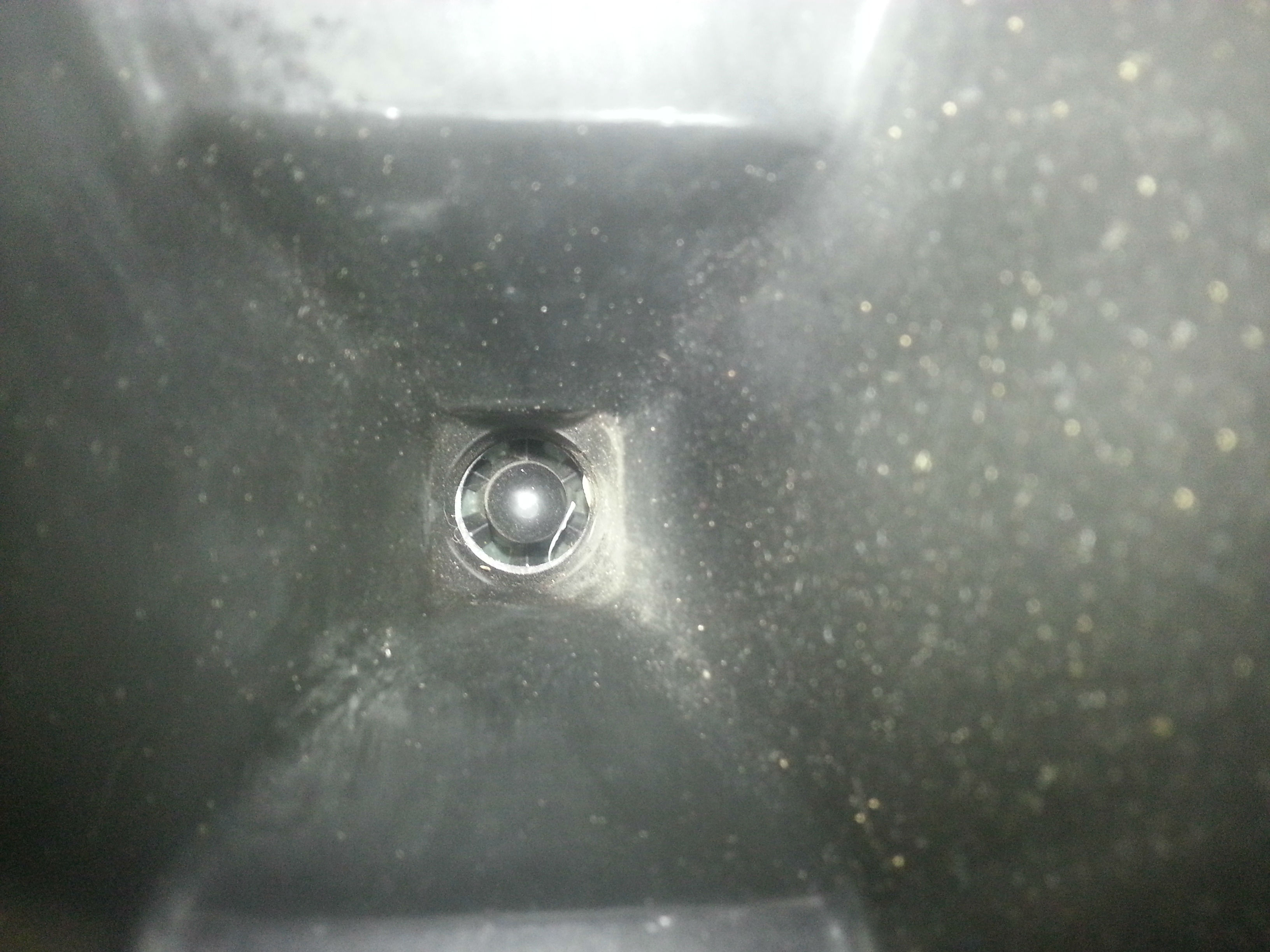

I'll see if I can pop off one of the tweeters and take a peek.
You are right about there being very little info about these guys, however I would agree with you they are 1000W boxes from what I can find, and imo the dual 18's do well.
I did find in a post somewhere that most of the speakers used by Ross Systems were made by Eminence, and your photo with the manufacturing code proved it. Speaker number 67-8723, would be made in 1987, the 23rd week, by Eminence.
I'm going to step out on a limb and guess the horn is the APT 150, as it has the same curves.
Supertweeter Detail | Eminence Speaker

Well at least one of the resistors in one crossover of mine has been on fire. The fire might have just been the glue, but carbonized glue conducts electricity.
I feel like i really ought to trace out the crossovers and calculate nominal xover points when i replace the caps. I think i am still looking for a 20w 16-ohm noninductive wirewound resistor. Or a pair of 10w 32-ohm noninductive wirewound resistors. But i will probably do the caps tomorrow. And i really should recreate the crossover in kicad while i have it in front of me.

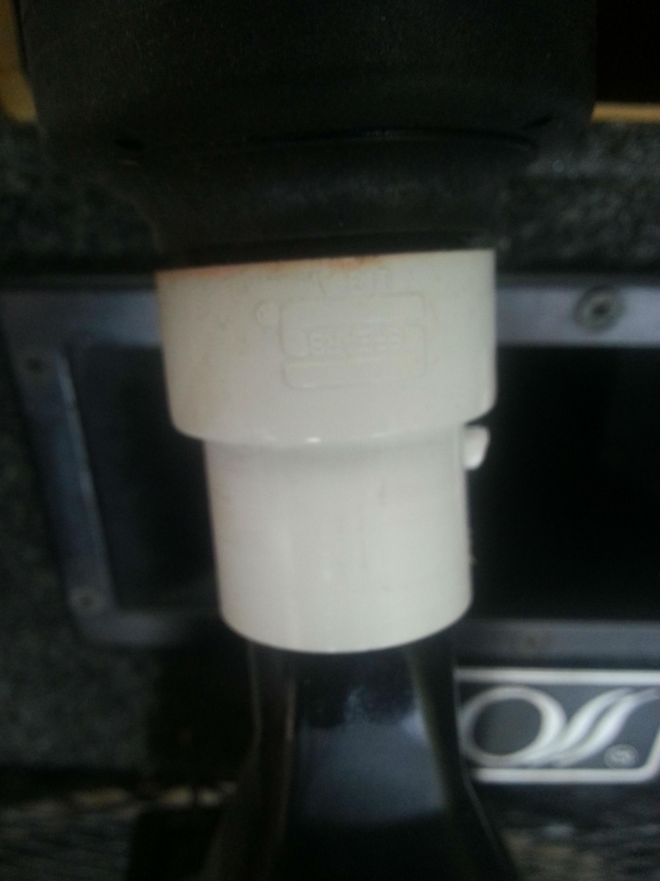

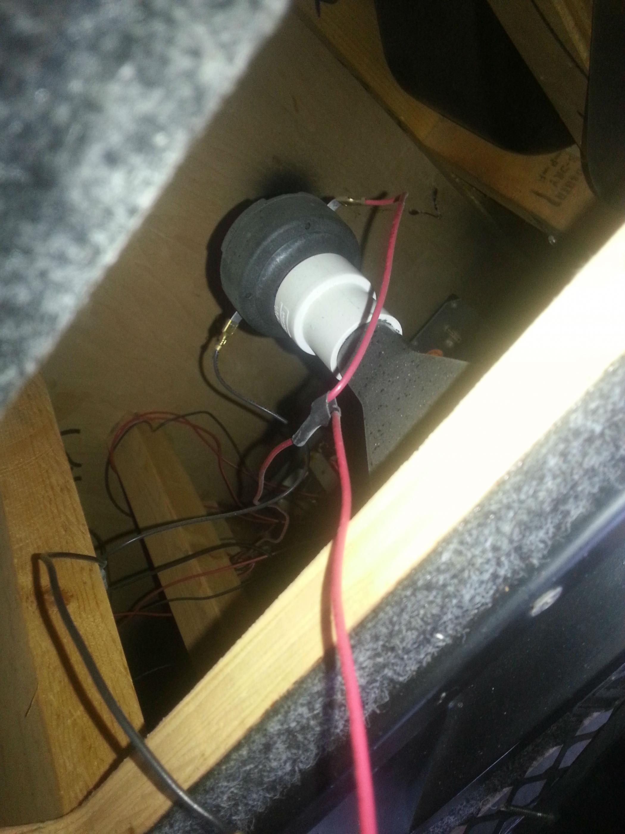

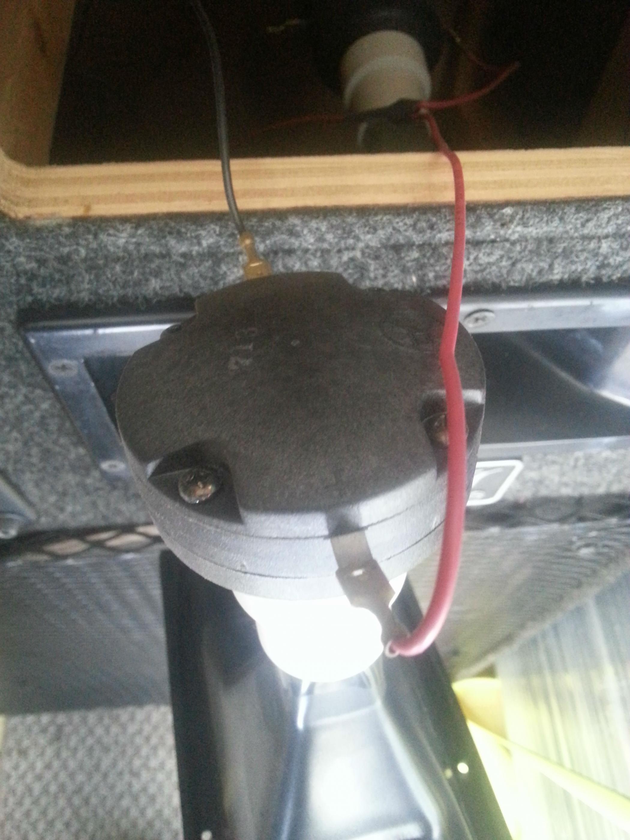

The horn seems to be a CTS KSN-1151 and the driver really looks like a KSN-1142. PE has a Goldwood horn that seems to be a clone of the 1151.
Real KSN-1142 tweeters are $37 each or so. goldwood and grs "similar to" 1142 drivers are cheap enough that they can be argued to be disposable experimental goods. 2-4 bucks each. Cheaper than the horns.
Point being, the tweeters may never have been a strong spot for these speakers. Maybe there is a much better HF solution for them. But it won't hurt much to start with some GRS tweeter clones.
I am just not sure if they are real KSN-1151's or not, as they aren't stamped other than the code. The real ones I have seen are covered in logos. I have another set of speakers with the gold coloured tweeter horn that are also part of this series with the same code stamped on them so I recognized them as piezo's right away.

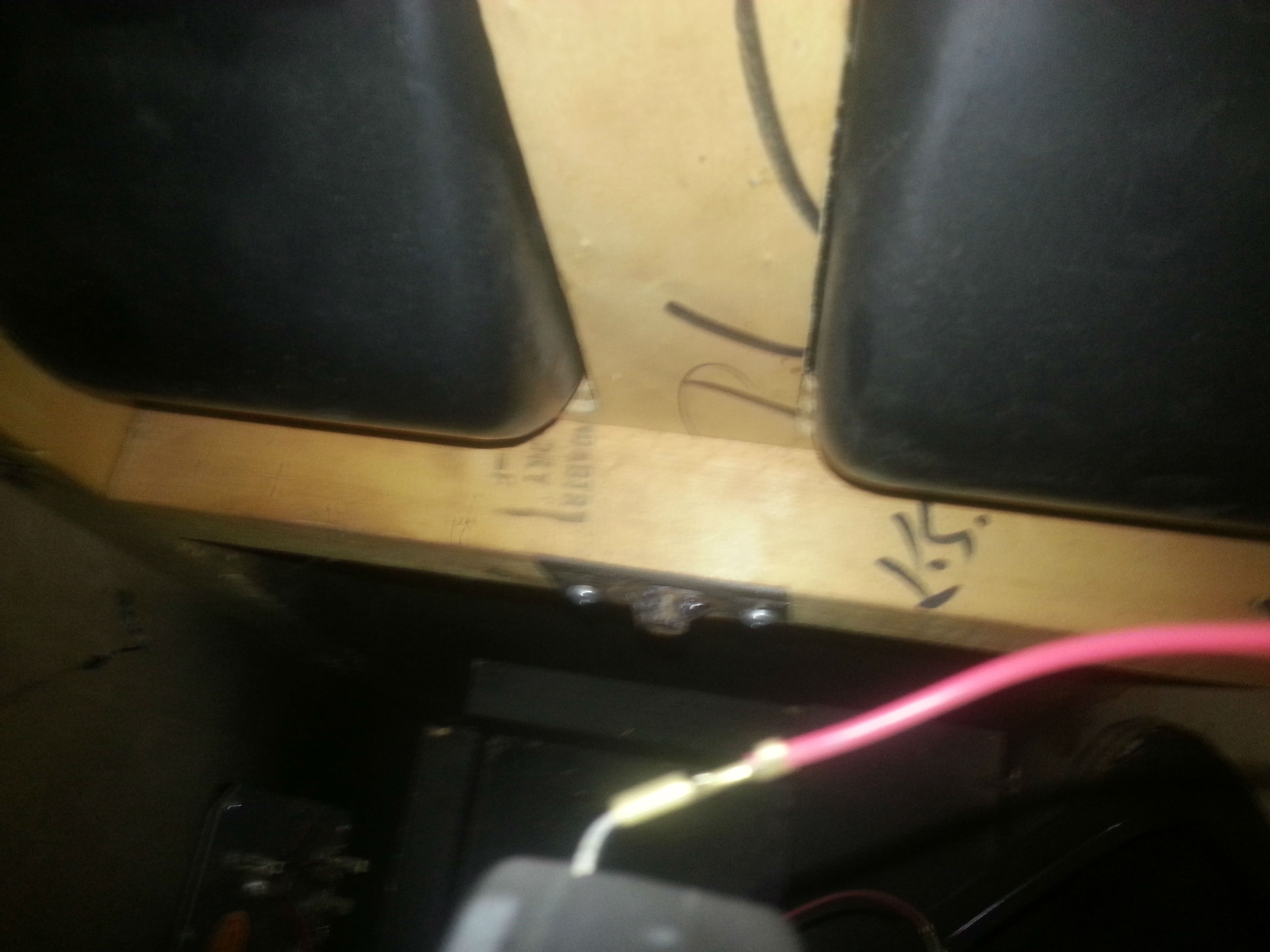

Interesting how they used the white adapter piece to join the two together. I think any experimenting you do will end up looking nicer than this. Whatever you do come up with, you still haven't spent a lot of coin on them. I bought mine from a heavy metal band who used them outdoors, for a couple hundred bucks and am pleased with the purchase.
I do wonder if a higher power handling tweeter would work well in this cabinet with a good three way crossover.

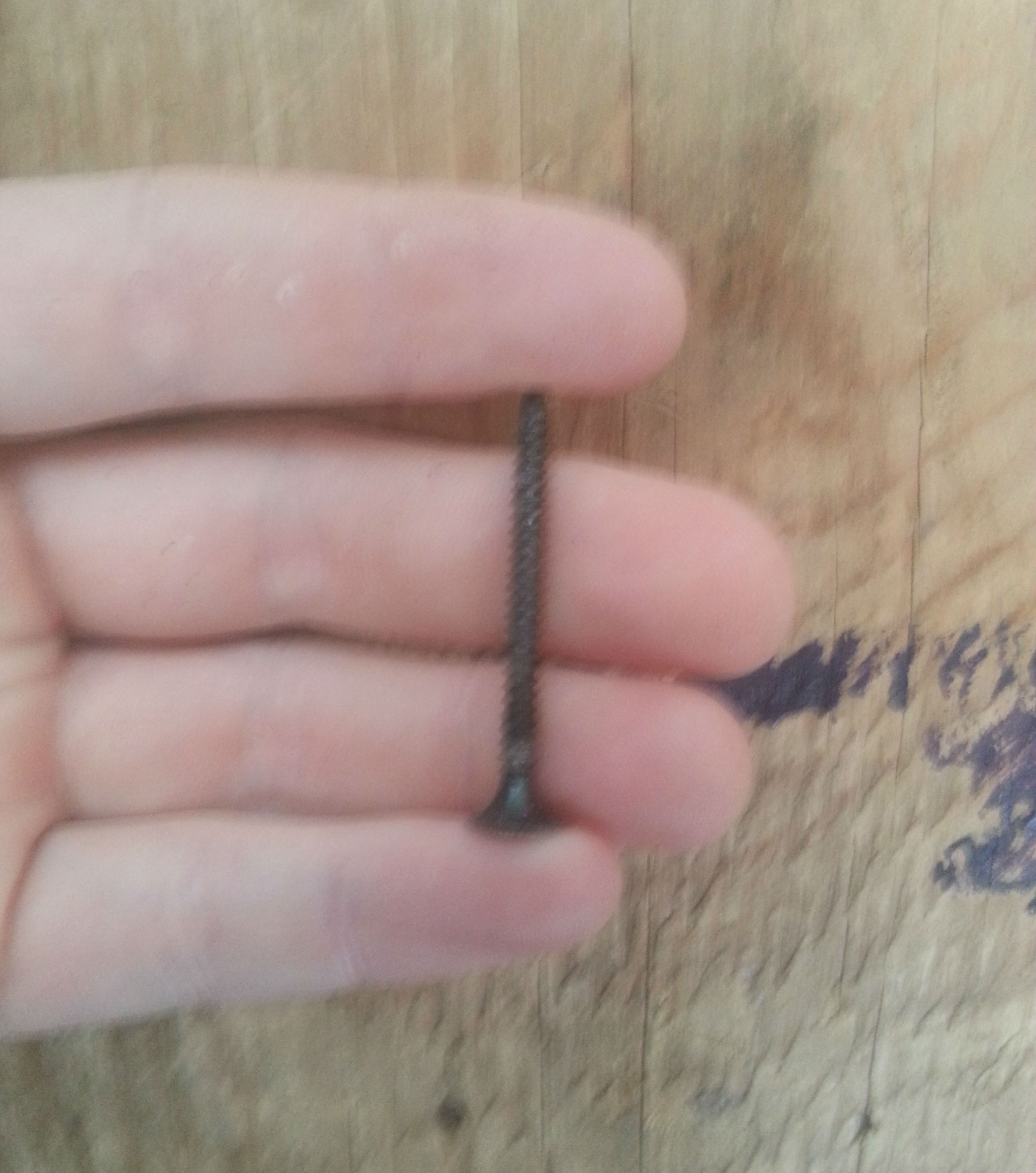

Did you notice the pic of the bolt on the inside? I saw the hole on the outside and wondered why it was there... odd venting point I thought. Can't believe they put in some sort of flying mount.
When I first used these speakers I bi-amped them and didn't realize bi-amping doesn't bypass the internal crossover, until I had a chance later on to take a peek inside, so I had an external active crossover before my amps, and I ended up with a bump I couldn't get rid of at 300Hz. I haven't bi-amped them since.
Looking at your pics, they look like 3rd order, two way crossovers, the low side on the left with the two coils, and the high side on the right with the single coil and diode protection for the tweeter.

Correct, no Motorola stamp and it's a cloneI am just not sure if they are real KSN-1151's or not, as they aren't stamped other than the code. The real ones I have seen are covered in logos..
It would, I did exactly that with some big old 3 way boxes I had back in the late '80 early '90. They originally came with a pair of Motorola 1157 bullets that sounded very nice at moderate volume but simply didn't have enough output to keep up with an 8" cone mid and a 15, so they quickly died. By this time Motorola had quit manufacturing them so I bought clones which didn't match the SQ of the originals, weren't as durable and worse still didn't have consistent output from unit to unit, I only bought 4 but each one sounded different. They blew on the first gig anyway so I then bought regular dynamic super tweeters and holy hell what a difference in sound quality. At gig volumes piezos degrade into an indescrete roar of frying bacon, 1 or 2 just doesn't have the SPL capability of a single compression driver so IMO unless you can use a big pile of them there are better options.I do wonder if a higher power handling tweeter would work well in this cabinet with a good three way crossover..
I know a lot of these piezo drivers, I've tried MANY. I found of the Mototola clones the Monacor MPT-142 sound best, by a far cry. Yes, they cost a bit more but they will sound best of all the clones.
