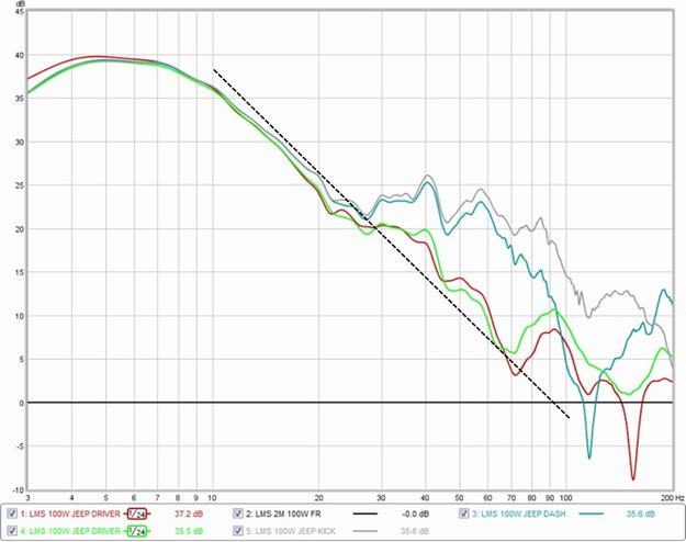

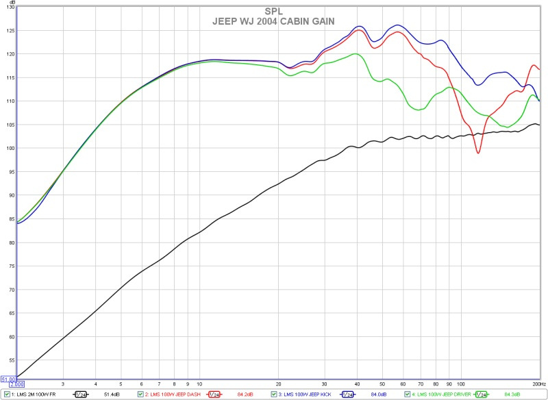

Attachment #1: Shows comparison of ground plane and in-vehicle response
The Green curve is at the driver's head. I'd ignore the dash and kickpanels curves.
Attachment #2: Shows difference between ground plane and in-vehicle response
The red curve is evidently an additional driver's head measurement.

Bolserst - you should have been clearer that you are talking about specially prepared vehicles. Sure one could do that, but my understanding of your comment was that this "room gain" was a given. In a "typical" case it is not and certainly it is not a factor at all in any space larger than a vehicle.

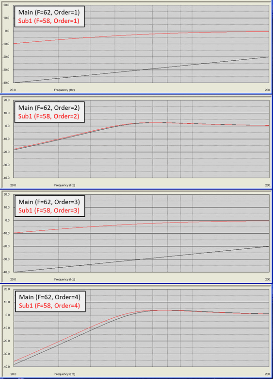

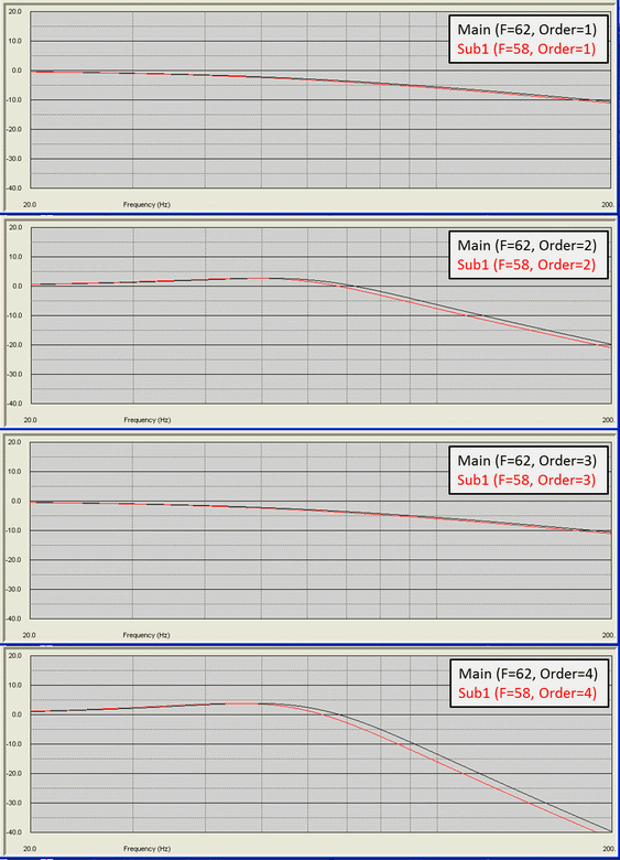

@gedlee,
When the "Show Filters" box is checked, the plotted response includes the native driver response. Was that intentional?
Looking at room modal response, the HP & LP filters didn't seem give the expected response in some cases.
To investigate, I set Mains and Sub1 to Fs=1Hz, Q=0.7 and plotter HP and LP filter response for orders 1-4.
In particular:
- 1st order HP on the Mains is not the same as 1st order HP on Sub1
- 3rd order appears to be the same as 1st order for HP & LP
- 2nd & 4th order look a bit underdamped
Thanks - that's clearly a bug on 3rd order.
Including the native driver response was not intended, but it was unavoidable without a lot of code rewrite. The response shaping is all bundled into a single call so it can't be separated without splitting up the calls.
The filter damping is fixed at .8, so its not too damped.
