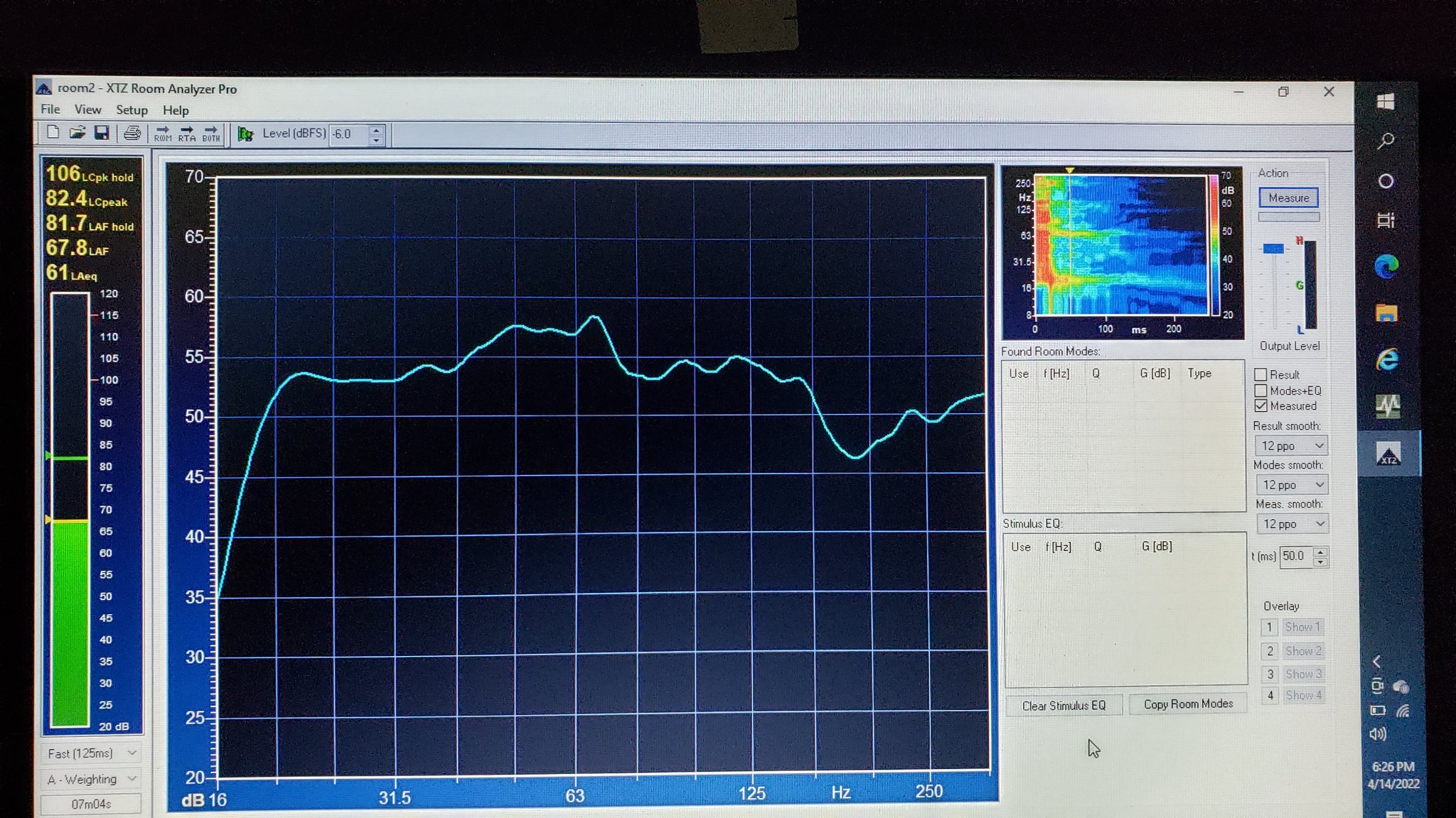

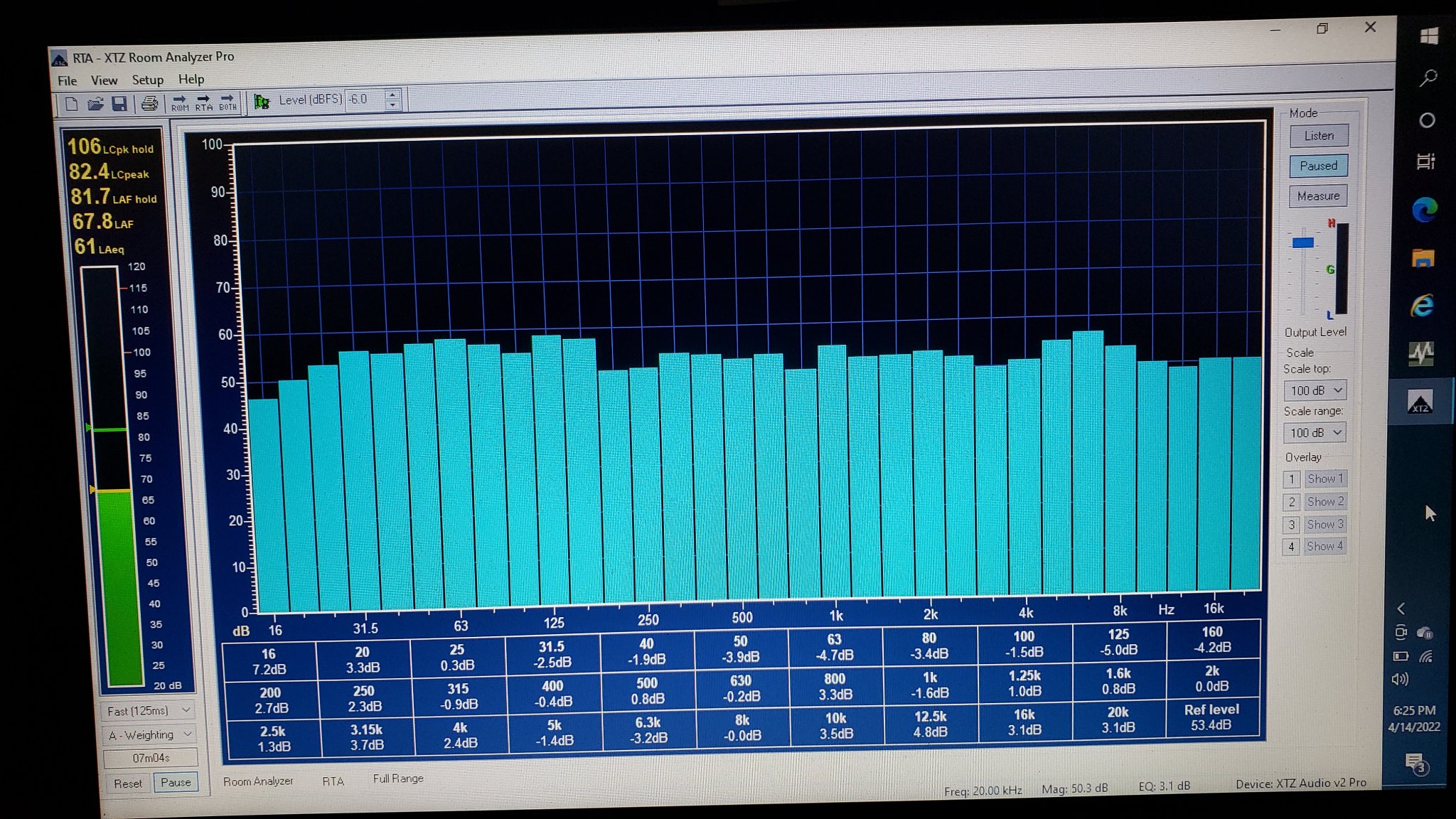

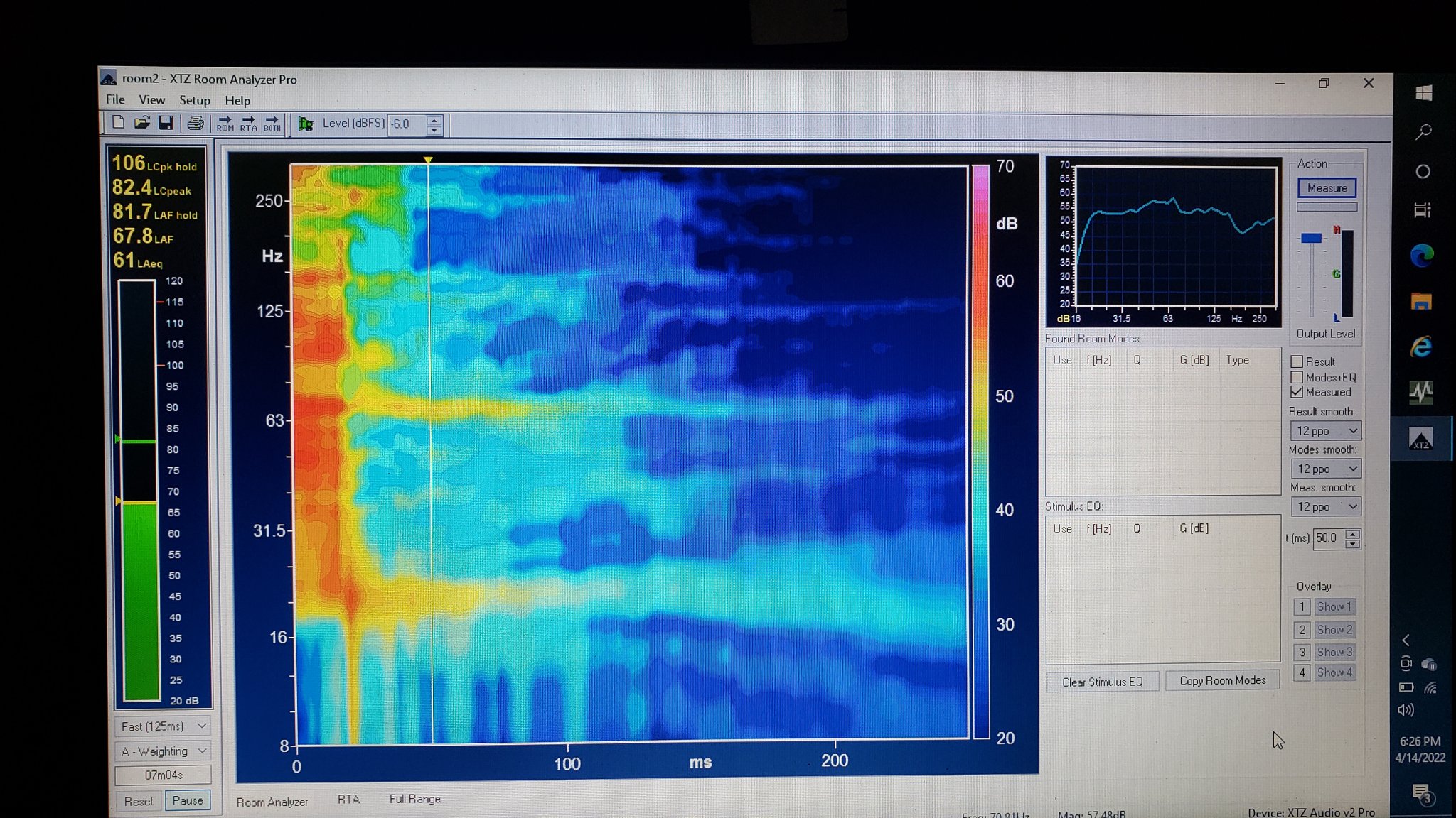

The case came and I quickly tested it.
Room sweep in the listening chair.

Stand is very light and flimsy, cheap. It will likely break, so eventually will have to be replaced.
Otherwise mic preamp box is nice solid, all cables are long enough and of good quality. Mic comes with calibration, no complaints there. Its smaller and lighter than umic or behringer I have.
Software is room modes oriented, measures in three room positions. Has absolutely nothing in common with REW.
You get what you pay for. Seems useful to me. I can see that I have two big room modes, one around ~20Hz, and ~65Hz. That 65Hz needs to be addressed. 20Hz maybe. Then there are two smaller modes higher, but not too serious. Overall not bad for open baffle system. I like how my system sounds.
