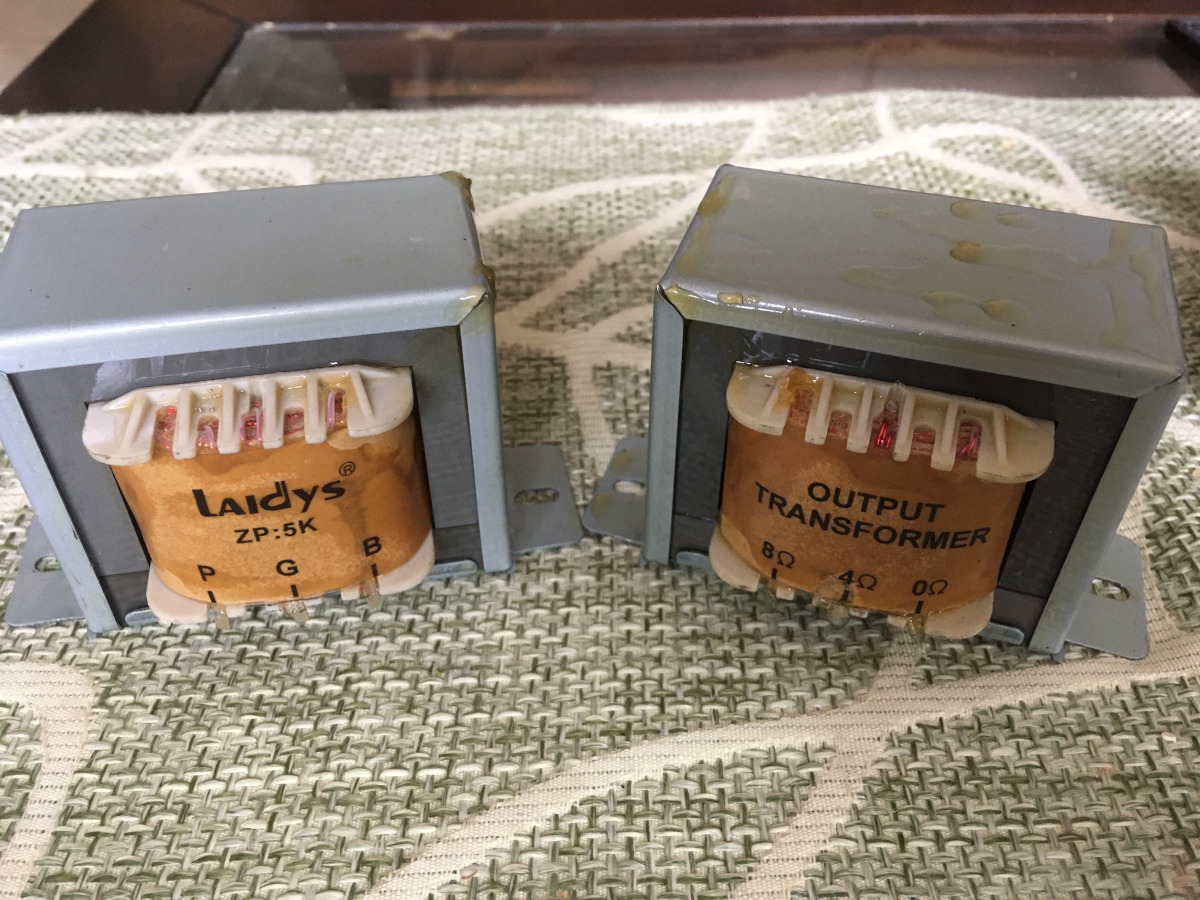

Whether its serious or not, getting an $18 OPT to test in an application where good specs are not that important is an experiment, and a learning experience.
Yes, the odds of getting satisfactory performance would be better with a $25 OPT designed and made in the USA by a serious company, but at the delivered cost of $56 ($25 + $31 shipping) it's not an option right now.
As I said before, the possible application would be a ultra low buck guitar amp. Anything SE requires a gapped OPT, or some circuit tricks. Either of these make the cost of SE well beyond that of P-P, so the whole thing is likely a non starter. I already have, and play often, a little P-P guitar amp that can be built very cheaply. I use this for a $3 OPT:

For a quick test of these "Laidys", is it 100% necessary to ground their chassis to the star ground? Or can I just set the Laidys on the table beside the amp, hook up the plate and B+ leads to the board, connect some speakers to the 8 ohm taps and let 'er rip?

Given their source, I would tend to err on the side of safety. They do have a visible plastic bobbin which highly reduces the risk of a short to the metal core or frame.
You can set them on a non conductive surface and do a temporary test without grounding the frames, but you must treat them as if the metal parts are connected to B+. In other words DONT touch them whenever the amp is plugged into the wall outlet and keep others away from the whole setup.
When the Amazon OPT arrives, I plan to take out my old SSE test board, the same one seen in post #173 of your other thread, hook up the OPT, a power transformer place it all on the wood bench, and fire it up to take some measurements. I have Edcors, the tiny Fender Champ replacements, some Transcendars and maybe more to compare them to. Then I plan to rerun the test with a UNSET board to see if UNSET does really make a crummy OPT work better.
I make it a point to step back from the bench when it's powered in this manner, and remove the line cord completely from the amp before messing with it. This avoids the nasty surprise when you accidentally plugged the amp back into power when you thought the plug went to the soldering iron.....yes I have done that, not once, but TWICE.
