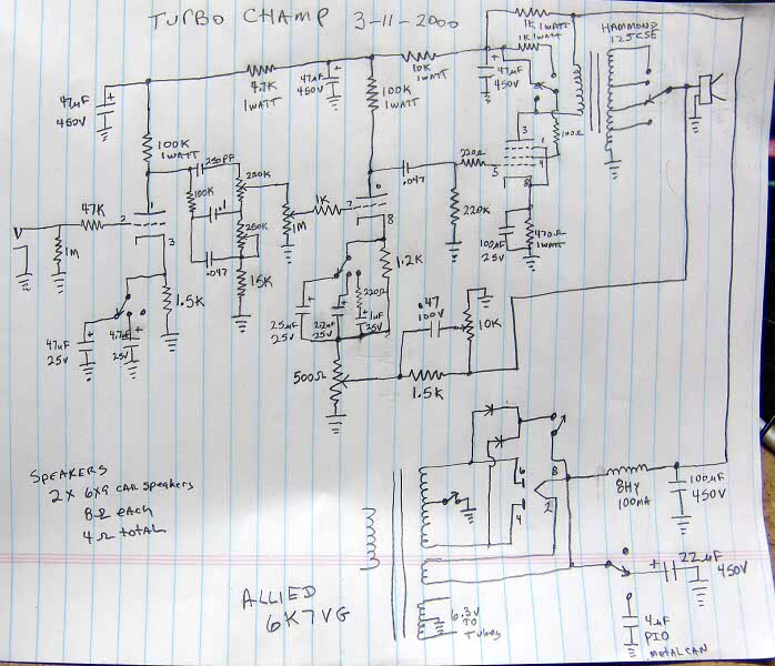

The picture shows a popular Champ replacement OPT that I got from Triode Electronics in 2004. It looks like it could get it's butt kicked by a 12AX7, and weighs in at a whopping 205 grams, 15 of which is in the wires. Despite their midget status they did OK in a small amp that used a 12AX7 and a 6AQ5 for about 3 watts.
They are ~990 grams each, which is somewhere between the weight of Transcendar's 5w (800g) and 7w (1100g) single-ended OPTs.

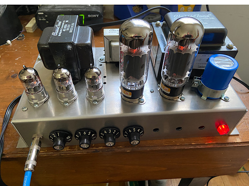

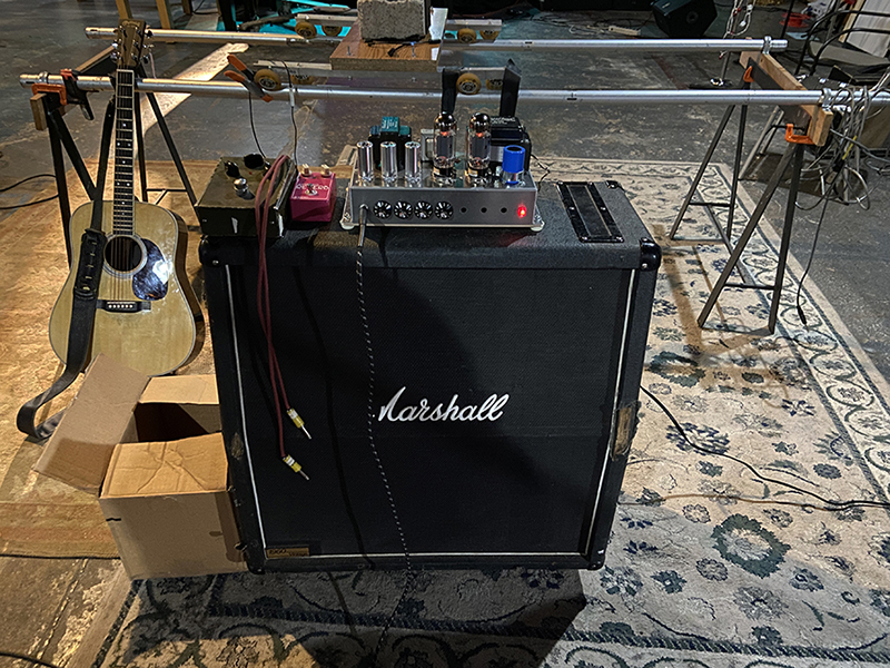

I have a little guitar amp that makes 4 watts on a good day. It's connected to a DIY cabinet that contains a pair of cheap 6 inch PA speakers. Their stated sensitivity is 93 dB and they are about 82 dB at 40 to 50 Hz. These were never intended for guitar, or bass guitar, but they do fine for routine practice and do get a "turn it down" response from my wife upstairs. I have a cheap Chinese copy of a Fender bass. It plays far better than I do. Short fat fingers limit my reach to about 3 frets on the long neck bass.
The little amp is seen here sitting on top of the speaker cabinet. I made it almost 4 years ago and still haven't made a proper cabinet yet. It is a lot louder with a regular guitar, bit I'm using a $4 OPT and speakers that have very limited response below 80 Hz.
It would be possible to make a bass guitar amp in the 5 watt range with one of your transformers. I would start with a Fender Champ type circuit and tweak some of the parts values in the tone control area to suit your particular bass guitar sound preferences. I made several "Turbo Champs" in the late 1990's and one did get used for bass guitar. It ran a pair of 6 X 9 inch car speakers obtained when a local K-mart closed down.
If you get nowhere trying to get a replacement for your Hammond transformer, it may be possible to use it in a bass amp with a solid state rectifier.

How does the 1K resistor switch on the power tube screen grid affect the output/tone?
I'd like to try using those switchable cathode bypass cap switches on an amp, too.
