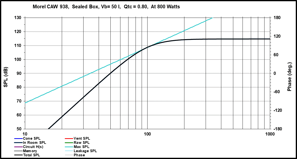

Quick simulation of the CAW 938 show's you should be alright as long as you cross to subs (on the high side) and have a powerful amp.

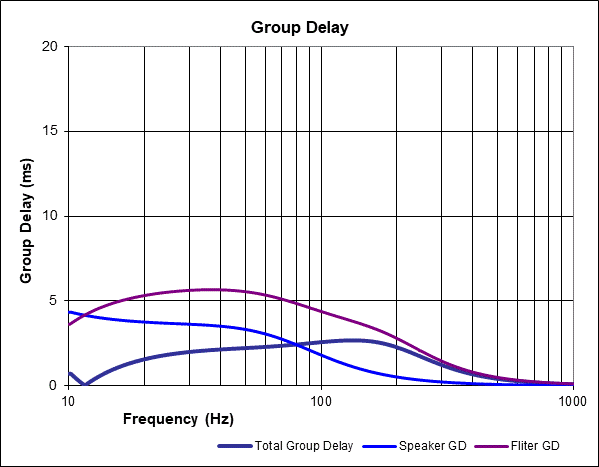

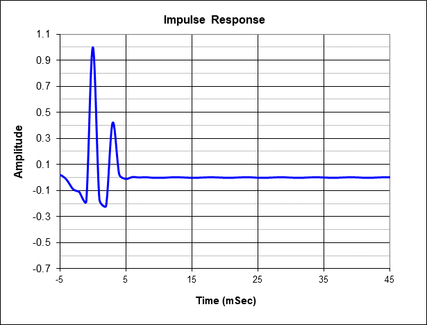

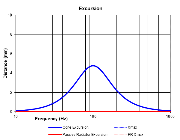

This is in 50L sealed, 800W peak, electric LR4 HP @ 100Hz (and LWT to flatten the response to Qts 0.707 before applying LR4, for true acoustic LR4). As you can see, SPL 115dB in the passband and Xmax at 100Hz.

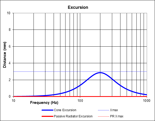

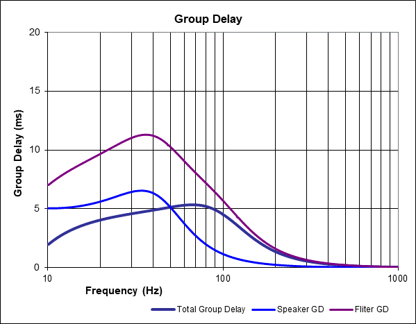

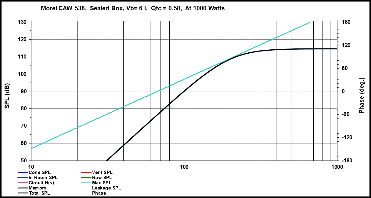

The CAW 538 isn't perhaps the ideal filler driver between the CAW 938 and ET 338 but can certainly do it. Here it is 6L sealed, 1,000W peak, electric LR2 HP @ 200Hz (and LWT to flatten the response to Qts 0.707 before applying LR2, for true acoustic LR2). Again, SPL 115dB in the passband, and Xmax at Fc 200Hz.
This of course if you want to spec for SPL 115dB peak at listening position (less actually since no baffle step). And without knowing your drivers' power compression and distortion profile at these power levels. But point is you'll probably be alright as long as you protect the drivers and give them some power when you want them to go loud ever so often. In real life, you would probably be OK to cross to subs at the standard 80Hz, if that's a fixed frequency available to you (through sub or HT receiver etc).

Those Morel drivers can only take that kind of power for a couple milliseconds. Continuous long term power for both mid and tweeter is likely between 150W and 200W.
The specs for both CAW 538 and 938 (as well as ET 338) specifically say 1,000W of transient power for 10ms, that’s why I modelled with it.
And 10 milliseconds is 10 thousandths of a second. In less than a second - POOF! No more output.
Most musical peaks above 100Hz are short enough (<10ms) - but could always set a limiter at 10ms if worried.
1000W peaks on 20dB crests at 115dB means 10W on average SPL 95dB. Most popular music is less than 15dB crests though, which is then like 300W peak.
