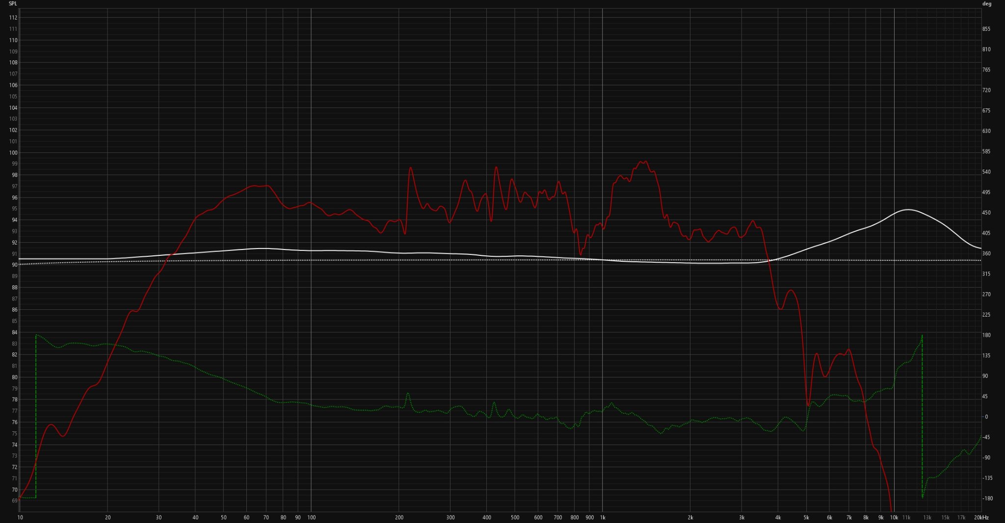

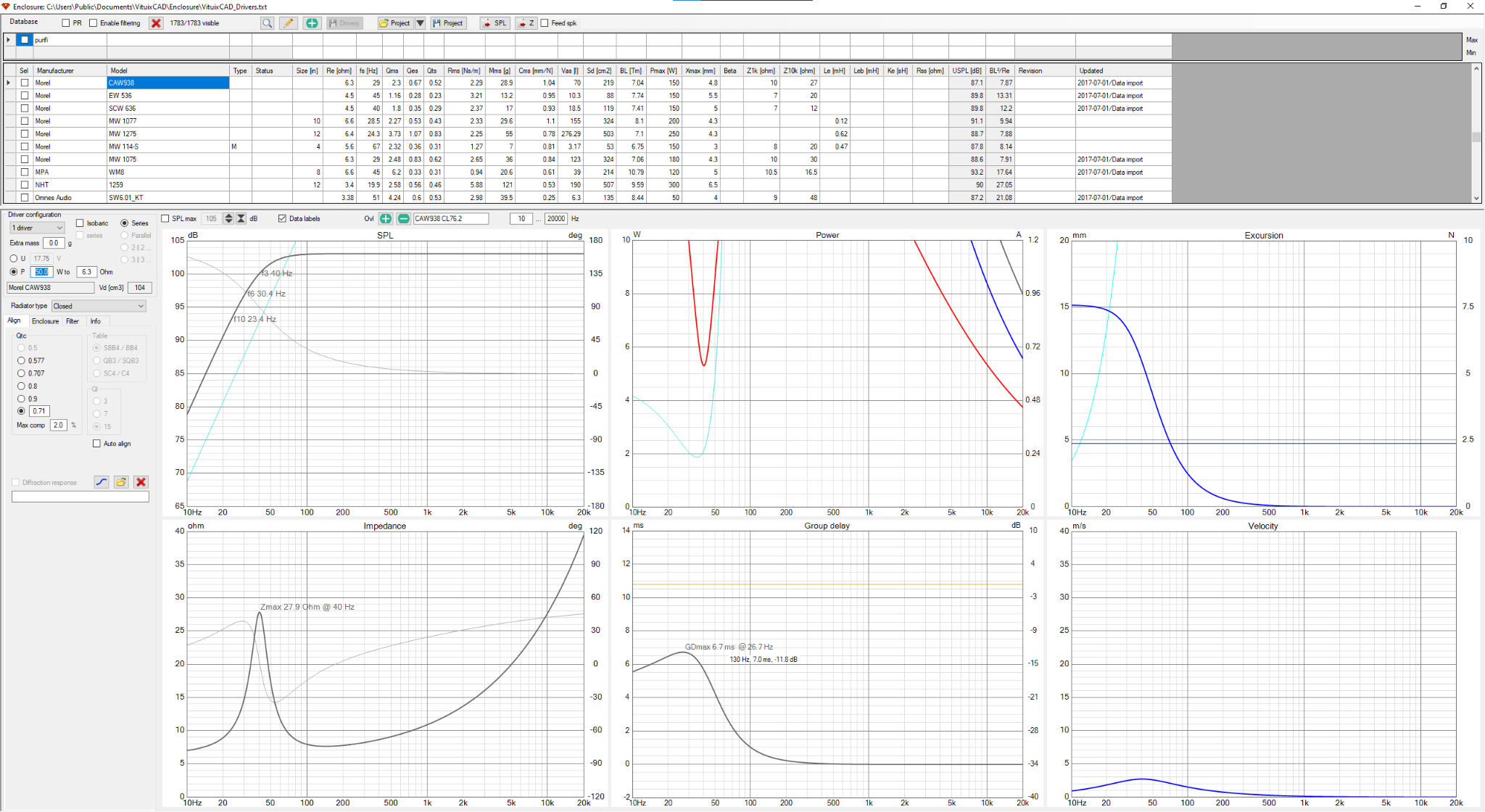

Please correct me if I'm wrong with anything above. Please see some enclosure simulations below and also some nearfield measurements of the CAW 938 and 538 test enclosures, these measurements are also gated from memory.
Hopefully this data is enough to go on, let me know if not or you need any more info. All measurements in REW have 1/24th smoothing applied.
EDIT: Sorry I also forgot to add the nearfeild accuracy cut off's.
  • CAW 938: 655Hz
  • CAW 538: 1023Hz
I will also not these measurements where not measured at a specified power level, 1 watt for example, they are quick and dirty just to give an idea of what the drivers are doing. The 538 enclosure has been filled with polyfil but the 938 enclosure doesnt have any.

In terms of woofer roll off at what point do you not need to worry about cone excursion
There's no obvious answer to this question. It comes down to how you intend to use the driver. If you model with excessive power levels at low frequencies, you're definitely going to exceed Xmax in lots of conditions. A 9 inch woofer is only going to do so much. At low frequencies, it's mostly about volume displacement in the end. Each octave you go down requires 4x the volume displacement to maintain the same SPL level. So at Xmax that driver might be able to run you out of the room at 200 Hz, but it's going to be much more polite at 20 Hz.
For normal home audio, there's typically a handoff in the midbass or bass region where you switch from excursion limiting output to thermal considerations limiting output. So at higher frequencies the wattage limit of the voicecoil comes into play more directly, but at lower frequencies it's more to do with the enclosure and excursion.
CAW 938 not suited for a low range woofer, my initial goal was anywhere from 500 to 250Hz down to the driver roll off with no HPF. If this does not seem viable I could definitely use it for a 2 way using it with a beyma compression driver.
To me, that woofer looks best for what you originally described: a 3-way. The impedance and frequency response discontinuities starting at 800 Hz would give me some concern from a general design standpoint. Maybe you can stretch the usable range to 1500 Hz, but it's something I'd listen to and measure before committing to. It comes down to what you find important from a design standpoint.

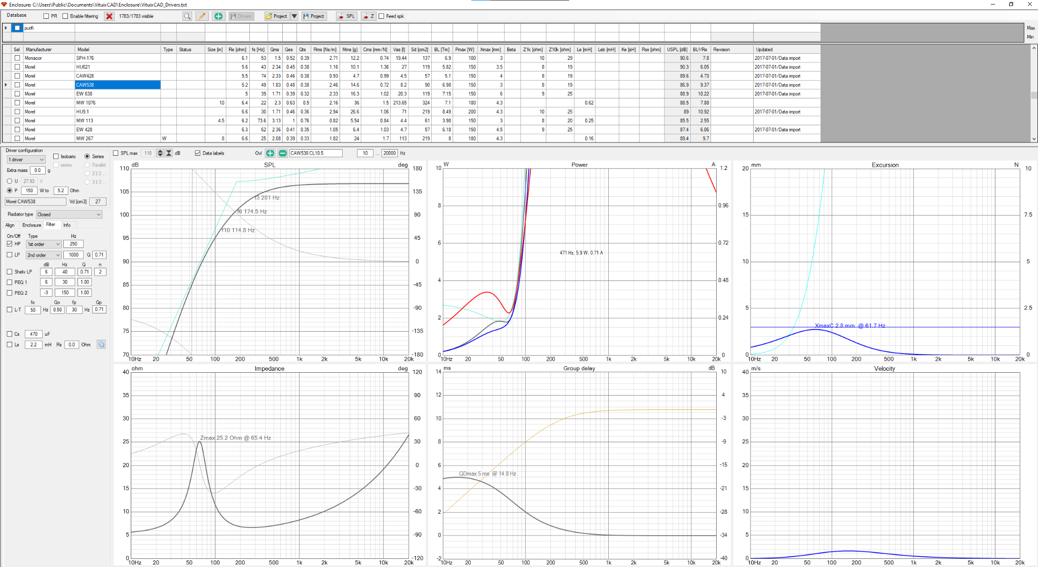

So I'm wondering if this is the main this I should be simulating to. Or am I needing to simulate everything to the peak/headroom of 105dB at the listening position? Here is the chart for 105dB at listening position.
Distance (m)SPL Loss (dB)Required Speaker SPL @ 1m (dB)
2m-6.02111.0
3m-9.54114.5
4m-12.04117.0
5m-13.98118.98
6m-15.56120.56
7m-16.90121.9
8m-18.06123.1
9m-19.08124.1
10m-20.00125.0
This however looks unrealistic to achieve even at 2m for even the caw 938 which does not hit Xmax at its RMS of 150W, with a 1st order HPF at 250Hz, and only achieves about 107dB. In the headroom aspect does it only need to be under peak power ratings and X_mech?
