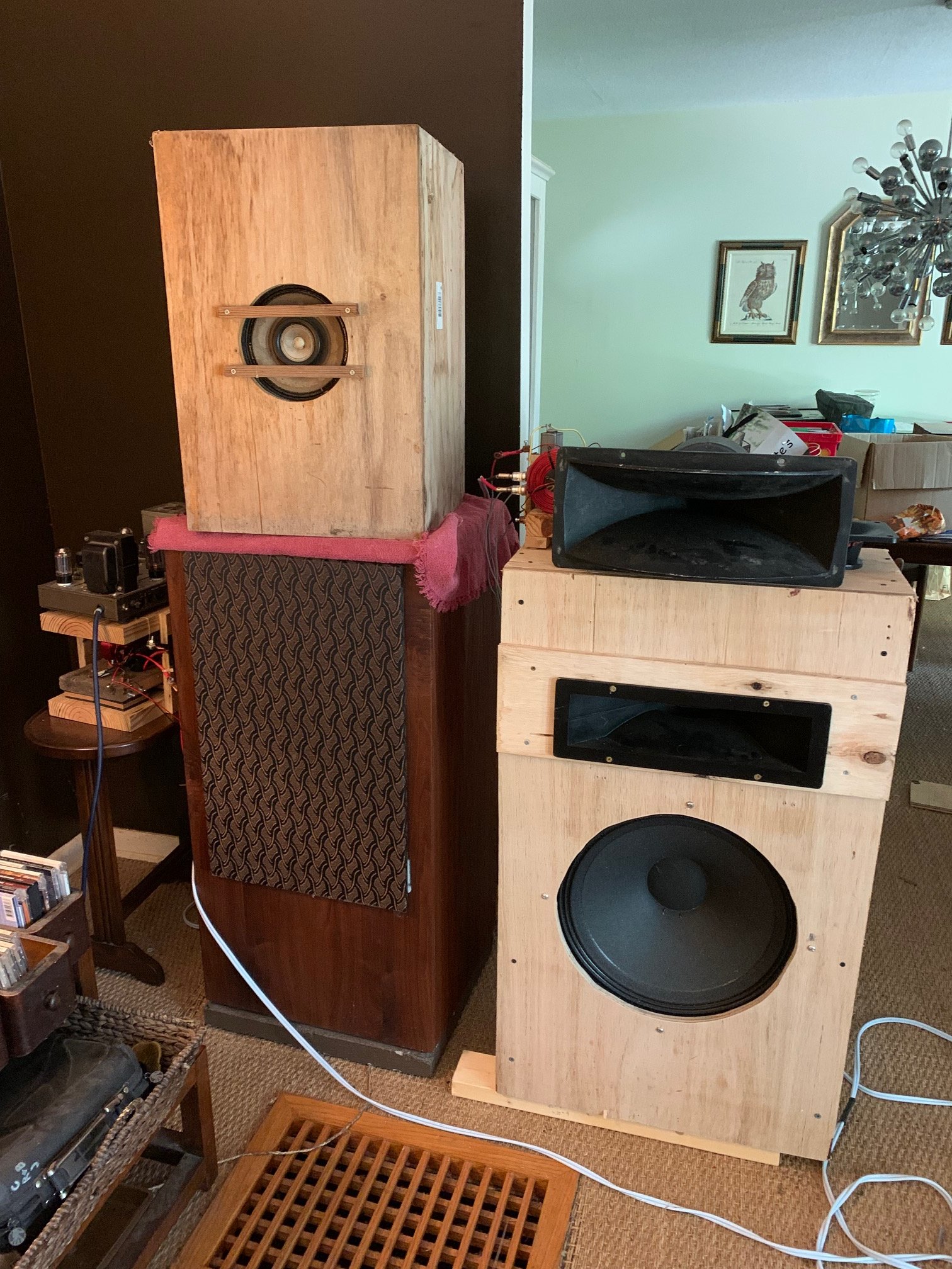

Let me be a little more forthcoming with my intentions and "origins" of my original post. I've been tinkering around with various high effecency speakers and really liked what an Altec 7" (409) in a 2'cu cabinet did in the way of "presence" and a 3D punchy mid-bass. So much fun to listen to.
The "bigger" speakers have their own charms, but thinking that the right 12" woofer (many think the Altec 414) might be able to capture some of what that 7"er was doing and straddle that gap between the big and small Altec (Western Electric) types.
Here's a picture of my follies as my family went to the beach without me and I turned our living room into a speaker fest.
The light unfinished speakers are open baffle with 18" JBL K-151's and toggling between Altec 291's/Emilar EH500 horns and Altec 802Bs/32 Horn Xo 800 Hz (everyhting is 1st and 2nd order XO). The dark Walnut "finished" speaker and my daily driver is a WE 753 variant with 15" Jensen P15LL with Radian 475PB/Altec 32horn XO 1.2Hz. The gritty little welterweight on top is the Altec mentioned above.
