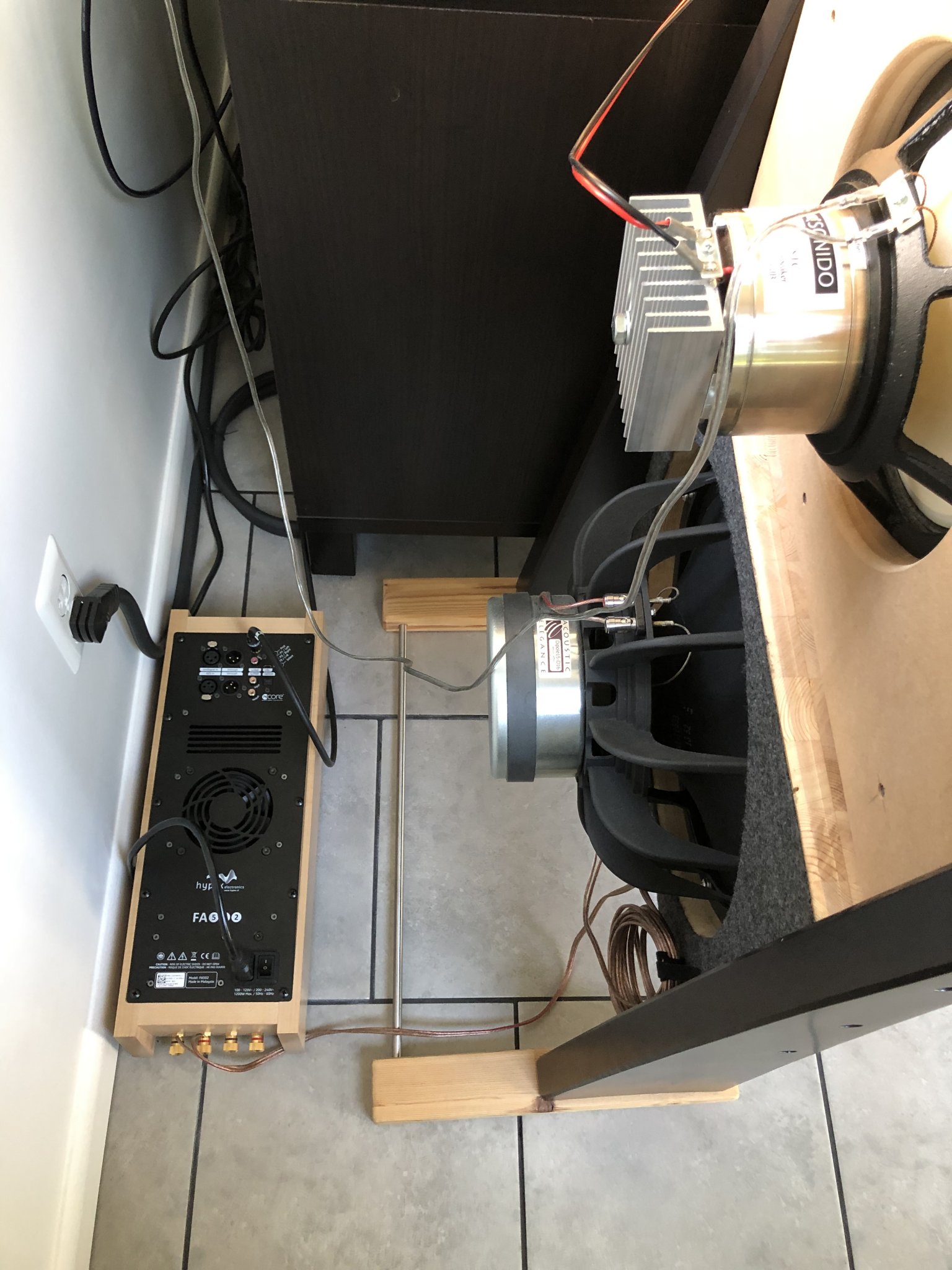

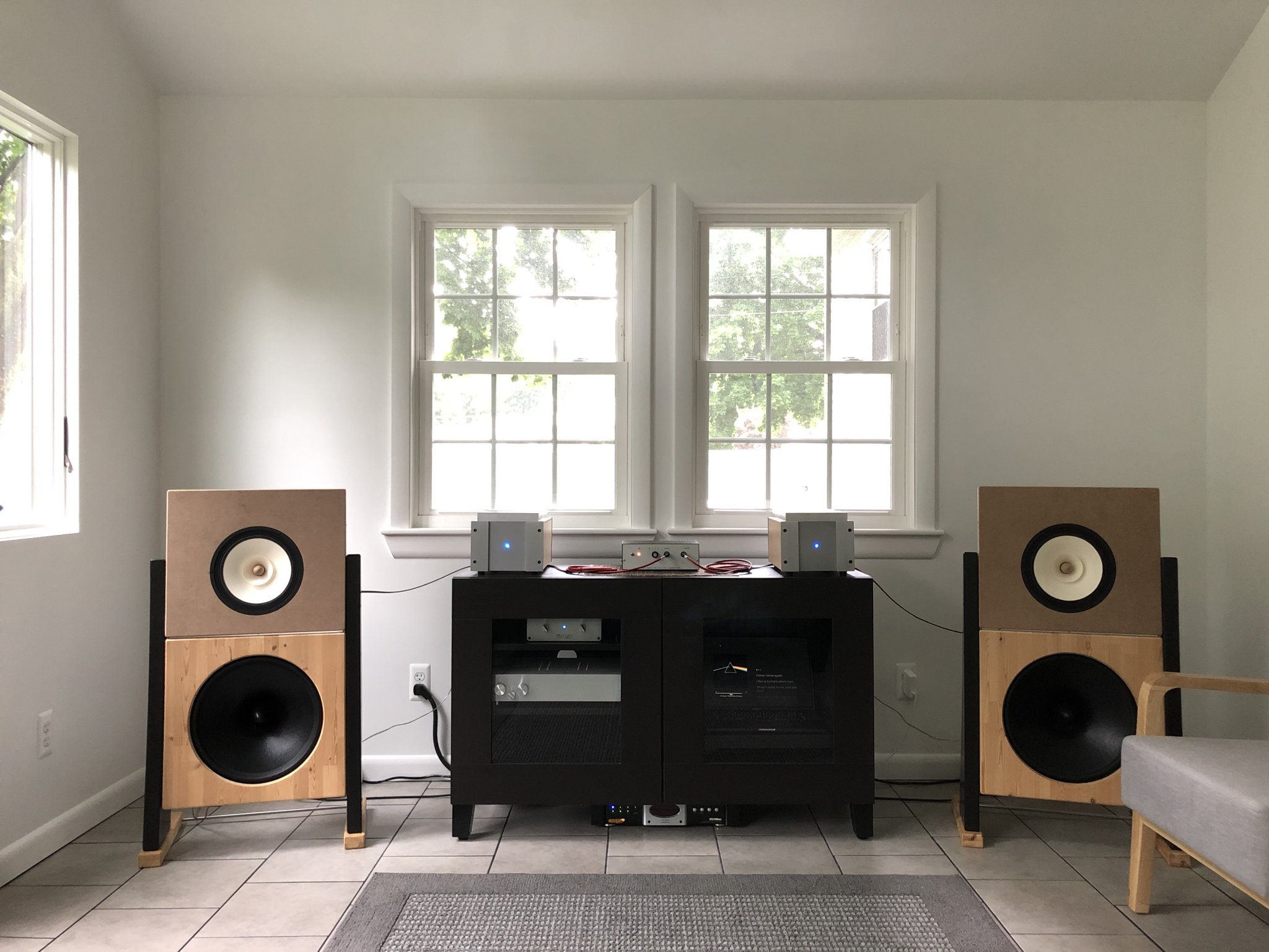

Currently being “spooked” on a regular basis by these Sonido SWR250 16 Ohm field coils.
Driven by my DIY F2J monoblocks fed by a DCB1 with Jensen iron on the outputs for a 6dB boost.
Signals handled by First Watt B5.
Bottom end is Acoustic Elegance Dipole 15 driven by Hypex.
To me 150-3000Hz is “meat and potatoes” and always needs to be tasty.
There will be some playing around with the very top and bottom ends to see if adding a tweeter or additional woofer brings anything to the game.
