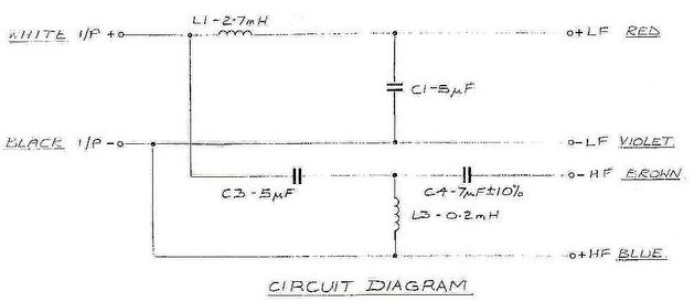

8" bass and tweeter is a delightful combination done right. KEF did it years ago to near perfection, although you can adjust this circuit considerably, it is the right idea:
on 8ohm woofers and possibly 6-8ohm tweeters that will cause significant dip on crossover TFHarbeth have worked wonders in updating the LS5/9!
Care to elaborate? I really have no idea what you are talking about...😕
