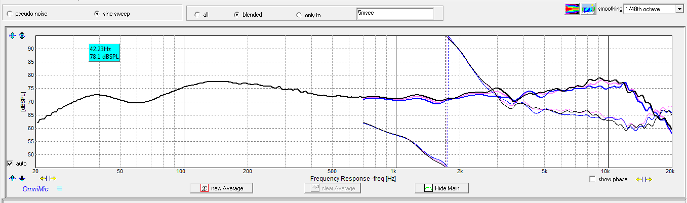

So, last Saturday i had the opportunity to listened to Rogers LS5/9, the system comprised of full QUAD CDP, PRE & AMP.
The speakers are enjoyable to listen to, we set it up around 2.4m between speakers, 40cm from the front wall and around 60cm from the side walls. The room was moderate size but it was an open plan, so the bass was good.
I brought my measurements gear to see how the speakers perform (actually there were 3 pairs of speakers, the other 2 were QUAD 11L and KEF Concerto)
so here's the measurements of LS5/9
1/48th smoothing, @Tw axis, mic distance 90cm with 0 15 and 30deg off axis.

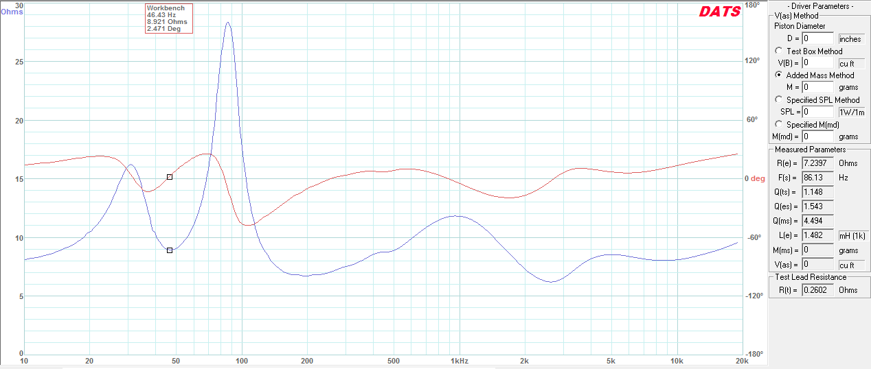

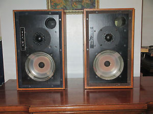

Mark Hennessy has a good page on this classic 8" bass BBC monitor. He liked it better than the LS3/5A.
Rogers Loudspeakers › LS5/9
I've not heard this model, but have heard a similar PM200 design from Chartwell. Your measurements seem to confirm a couple of slight issues around 3 and 11Khz. Bit of a classic of its type really. Easy listening, aren't they? 🙂
It's actually quite hard to sell a neutral loudspeaker, IMO. There's always something in the shop that sounds more exciting, maybe has more bass or top. But neutral (and the famous BBC dip toward the top end) is easy to live with and it's probably right. 🙂
I certainly listened to more classical music when I had this sort of polite and detailed speaker. I wonder why that was? 😕

well i cant say the ls5/9 is neutral 😀
i've used 8" hds with satori in a waveguide, and about to build 10" with seas t35, im aiming for more realistic presentation and bigger scale than my current reference with satori mids and raal, but not sure if that's really achievable 🙂
I think that English speakers are usually not designed for a mic on the tweeter axis but referenced somewhere in-between the mid-hF acoustic centres?
it maybe so but I'm not sure, but the tweeter position is lower than usual speakers, most likely around the vertical centre of the box.
