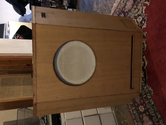

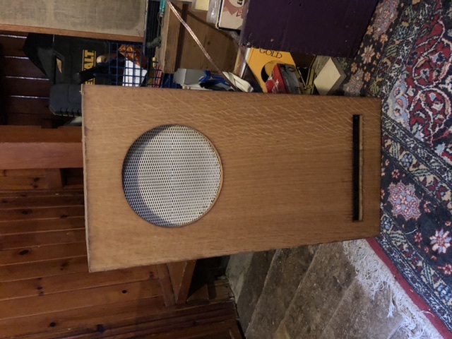

So, I went & picked up the speakers today. 431E4F79-6823-4997-ACF0-19522C277EA9.jpeg

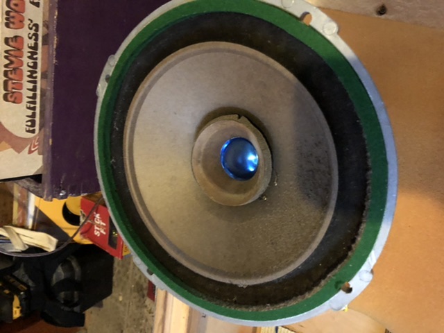

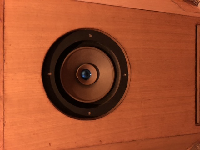

I immediately removed the wire grills & had a look at the drivers which look ok other than the foam around the wizzer cone has deteriorated. Is this replaceable??
They sound pretty sweet, nice & more detailed than my AR4AX. If lacking a tiny bit of bass but that just may be the cabs. Not measured it yet but the smaller cab looks like it’s to the Wharfdale specs thinking I’ll build a new pair of those with the inner fold TWQT design & perhapse increasing the ply to 15mm instead of 12.

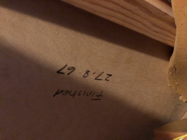

When I opened them up the smaller cab had the writing in saying finished 27/8/67 which is pretty cool, the guy I got them off said he’d inherited them from a professor.
If you very carefully remove the remainder of the perished foam you can replace it with a home made annulus of soft foam.
Use a tacky PVA adhesive like Anita's Tacky glue or a similar PVA adhesive which is recommended for replacing the foam surround on woofers.
Wharfedale found it necessary to damp the edge of the whizzer cone of the 8" and 10" units to balance the treble response with the rest of the audio range. The 12" units didn't require this edge damping, perhaps because their whizzer cones needed more liveliness for the overall balance.

The dimensions of the vent in the Wharfedale cabinet design were not arrived at by theory. Instead they were chosen 'by ear'. The method of vent tuning back in the day was to tune the vent to the free air resonant frequency of the driver. However, in the case of drivers with a resonant frequency above 50Hz, sharp reflex tuning was said to be 'a doubtful blessing' and a larger than theoretical vent was employed.
If the T/S parameters of your particular Super 8s were accurately known, then we could design a bespoke tuned enclosure. However, some rough calculations I have done using the measured parameters provided earlier suggest you would require a much larger enclosure.
I have found this information regarding the foam annulus that was supplied by VaNarn in 2016:
For the Wharfedale 8 RS DD and the 10 RS DD model, the foam used for the damping ring on the HF cone is made from a soft 1/4'' thick plastic foam with small pores. It was cut out from a sheet of foam as an annulus, I.D. = 2.75''; O.D.= 3.5''. A section, approx. a quarter of the circumference, was removed to allow it to be fitted to the edge of the tweeter cone. A latex adhesive should be used to attach it and it must be tensioned in such a way as to to provide a small amount of compression to the cone edge.

Thanks so much Galu, that's great info on the foam, i'll see what the mic cover is like when it turns up & dig out some other scraps I have to see which is most suitable. I measured the cone as 147mm across & with the surround up to the green 177mm
Looking at that page I think the increase in size to create this style of cab may make them too big for my tiny house (& for my partner!) So will probably stick with a wharfedale spec size very similar to the one one is currently in.
As long as you stick close to the Wharfedale spec for the internal volume (within 10%), you can make the enclosure taller, narrower and deeper to match modern domestic tastes.

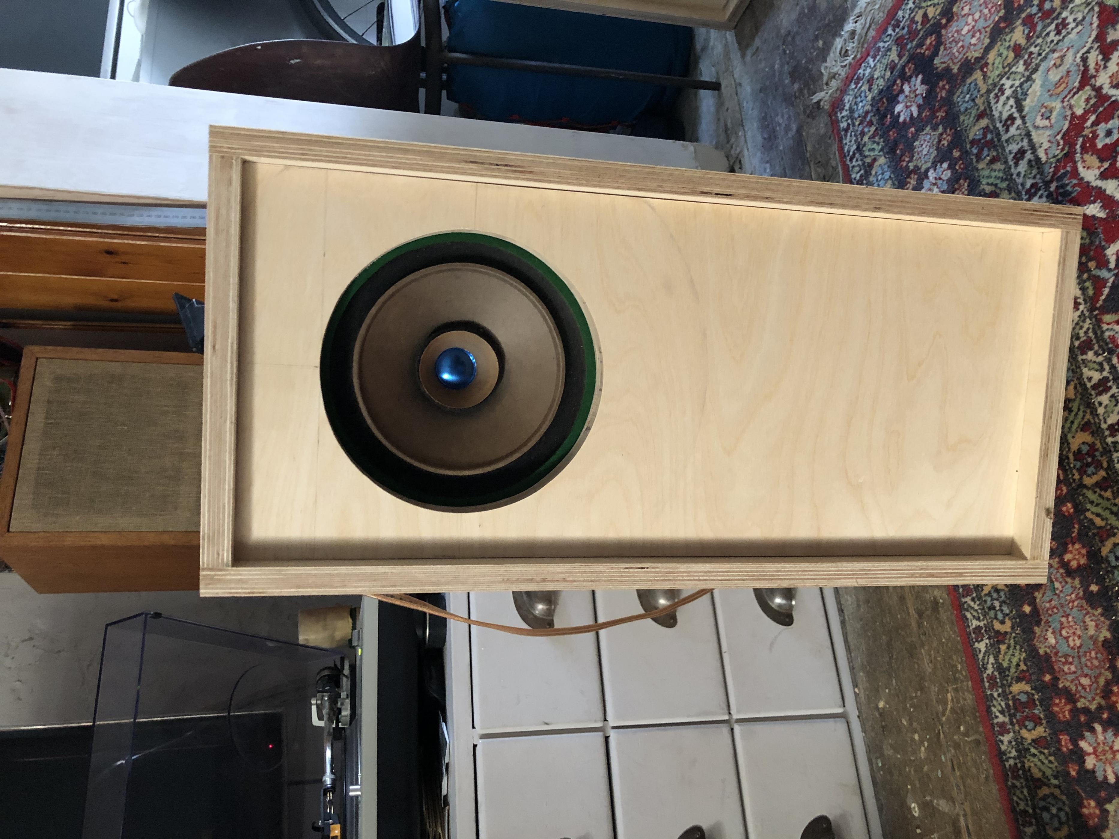

So... cabinets coming along. As suggested I left them unported to see what they’re like first.
I’d not disassembled the old ported cab so could use it for comparison & it must be said port really does make a difference, much more bass & feels like detail gets a bit lost on the imported cab.
On the wharfedale specs it mentions lining the cabinet on all 4 sides with ‘back lined soft cloth, 1” thick’ Wondering if you had any suggestions or if this is just the same as foam/rockwool stuffing?
