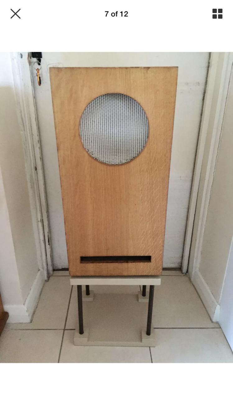

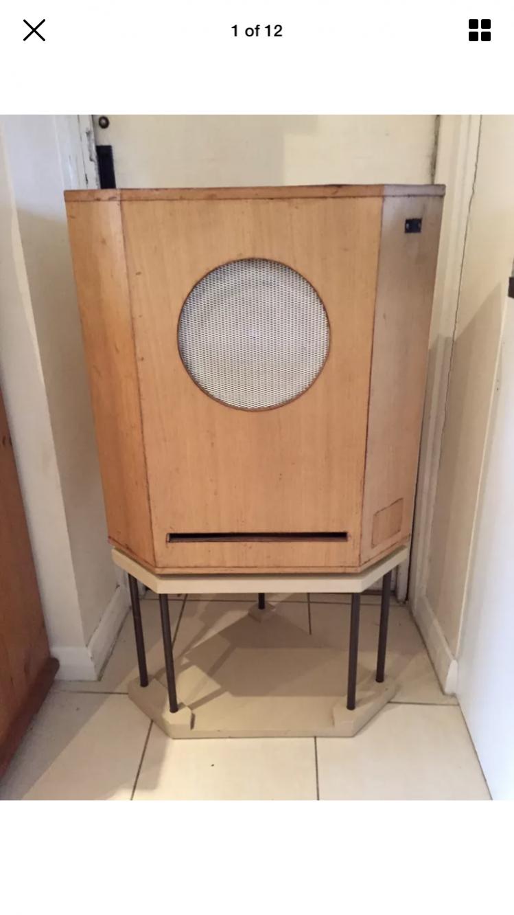

I like the way you have incorporated the slot port into the cabinet design.

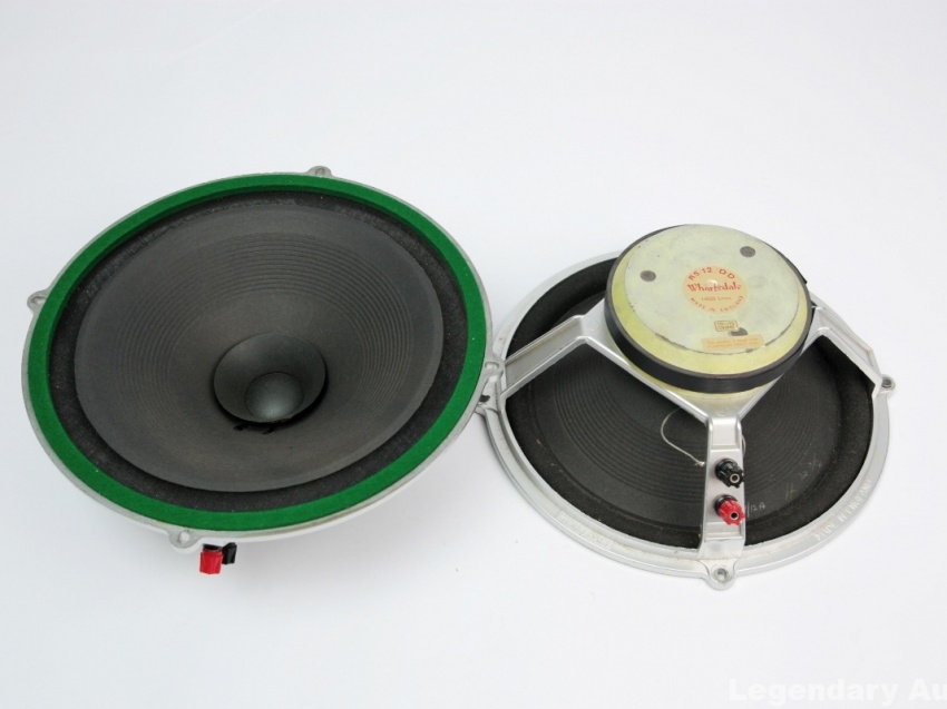

Did you replace the foam around the periphery of the whizzer cones, or is the frequency balance just fine without it?

Yes I did exactly as you suggested & it’s definitely made a difference, the high notes of horns were sounding almost on the edge of rattling or vibrating the paper if you get what I mean? & it’s softened that brilliantly.
The ports at the bottom ended up like that as my router wasn’t doing a great job on the test pieces I did so thought up this idea & it looks actually better than I imagined. I am absolutely amazed at the difference between listening without a port & now. I guess it also gives the room to put a fold inside if I wanted to experiment!

Thanks again, really chuffed with how they sound! Need to keep my eyes out for some 12” super RS now!!!
I've got one Super 12/RS/DD in my collection and it's in mint condition.Need to keep my eyes out for some 12” super RS now!!!
Don't know where you are based, but there's a pair available here for £250 right now:
