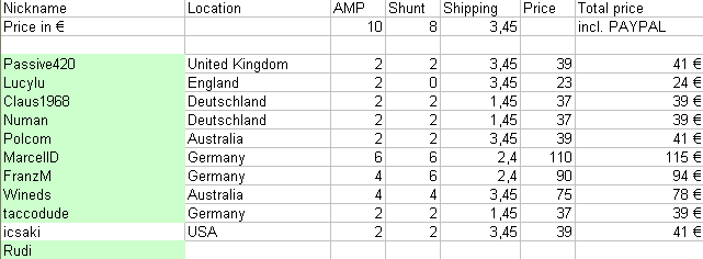

Hi Rudi I just need amp pcb s I already have shunts,please amend list so I can pay thank you regards john
Rudi payment on its way as you are on holiday we can sort this out on your return. John
Hello, it's too late for joining to group buy? Please count me with 2 amp boards and 2 shunt pcbs.
Please forget the previous message, I'm checking BOM and I don't know if will able to get all parts. Maybe on next run of boards.
Gentlemen, I have just returned from a short holiday.
This is the message that I found in my EMail-box:
Dear Rudi_Ratlos,
Your order 123456-4711 is confirmed Aug 9, 2013 21:22 and schedule to ship on Aug 21, 2013.
We will send you delivery details as shipped. Please let us know if you have any further questions, thank you.
So: I will receive the FC-100 AMP- and Shunt - PCBs by the end of next week and will send them to you ASAP.
Find attached the current order list.

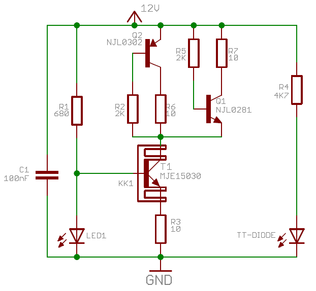

I would appreciate very much, if somebody of you will do a "sub - group-buy" for the NJL - transistors, measure and match them.
I am willing to pay for 10 pieces of NJL0281DG and NJL0302DG each, provided that they are closely matched.
Best regards - Rudi_Ratlos

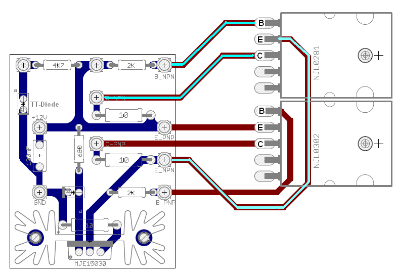

You can buy ready matched NJL transistors online but they are a bit pricey.
Rudi - could you briefly explain the process and equipment needed to match output transistors.
Also, the Toshiba 2SC3423 and 2SA1360 are obsolete and hard to find unless we risk an ebay vendor - are there any other reliable vendor and should these be matched along with the MJE-transistors?
Rich, I have used a CCS consisting of resistor R1 and LED1 and adjusted R1, so that about 150mA is flowing through the DUTs.
When I have built the prototype version of my layout of Mihai's FC-100, I have used 2SA and 2SC transistors that have been manufactured by ISC.
They ISC transistors are available from REICHELT, my favourite German distributor, for example.
Later, when I did the 1st and 2nd round of group-buy, I bought original Toshibas from pacificsemi.com.
But I wonder if the Toshibas "sound better".
I have bought the NJL-transistors from VERICAL (have a look at octopart.com).
From my experience it is safe to order 10 pcs. of NJL0281DG and 10 pcs. of NJL0302DG to get two fairly "well matched" output triples of each.
So: if we are 5 to join a "mini" - NJL - groupbuy and you order 50 pcs. of each, you will find 10 "well-matched" output triples.

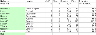

Gentlemen, I have received the PCBs today, have already put them into the letters and drive to the post-office in a minute.
So you all will have the PCBs by the end of this week (German participants) resp. by the end of next week.
Have fun building the FC-100 - Rudi_Ratlos
P.S. What I have forgotten to say: I have one set (2 x FC-100 AMP- and 2 Shunt-PCBs) left.
The price for this set is 41€, worldwide shipping included. If somebody wants to have this spare set, ...

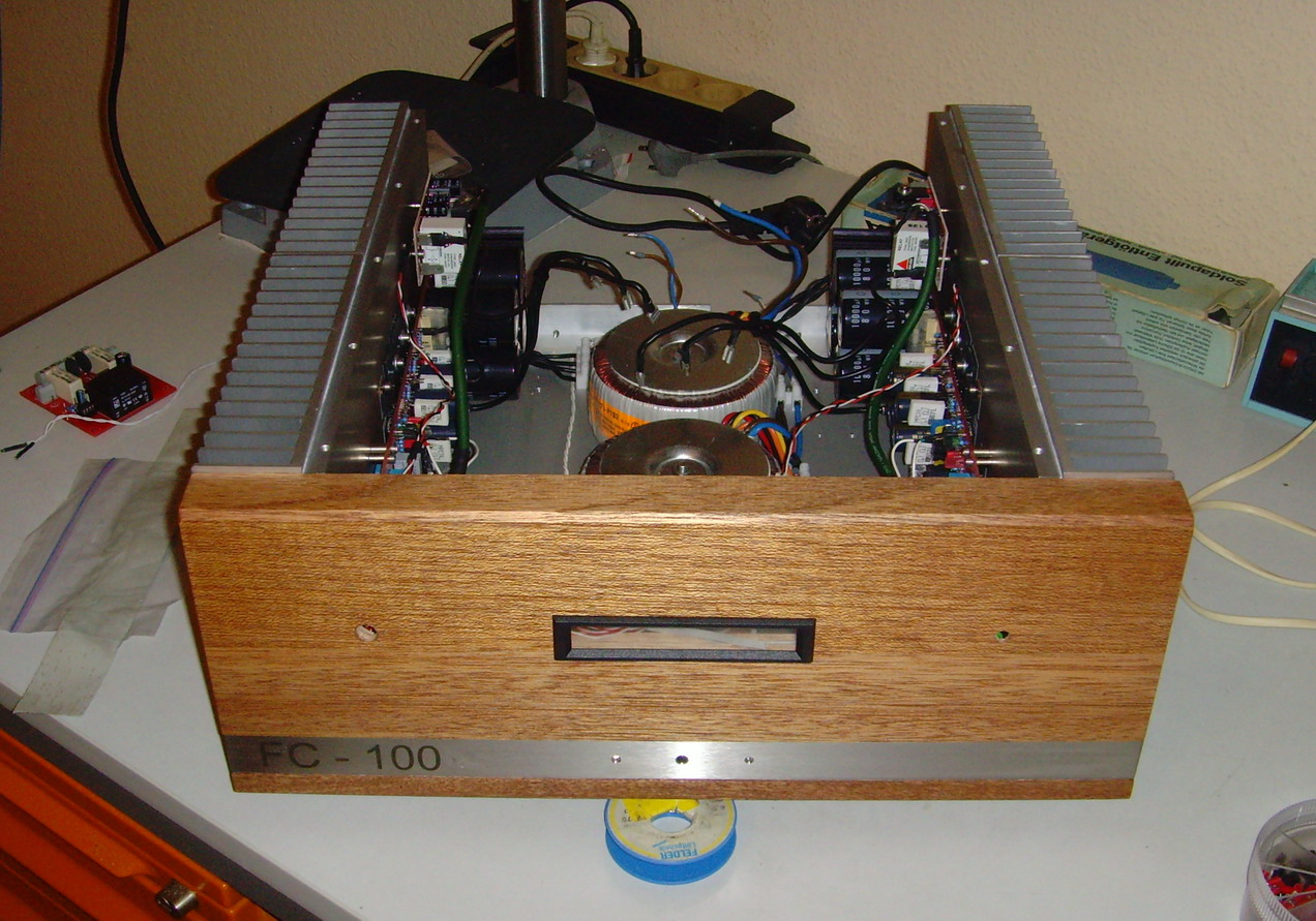

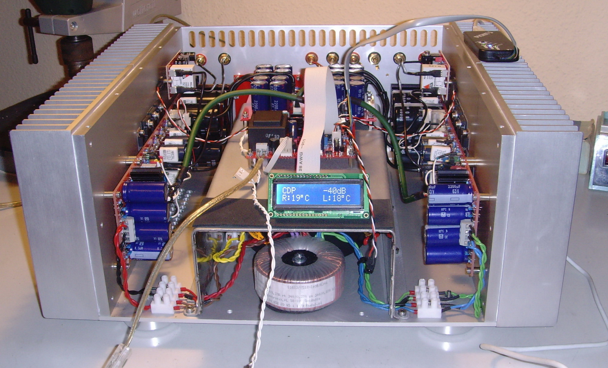

Franz, I have laid back the spare set of FC-100- and shunt PCBs for you!
The FC-100 is a real gem - I know that you agree.
These are the next steps of my FC-100 build (after I will have finished the VCPre Rev. 2.1 group-buy):
- to "marry" the VCPre ("Versatile and Comfortable passive Pre-Amplifier" - I will use a 1x16 LCD) with the FC-100
- to give it a smart-looking, wooden front
The FC-100 is really worth all the time it takes to make it an integrated and good-looking and fantastic sounding amplifier.
Best regards - Rudi

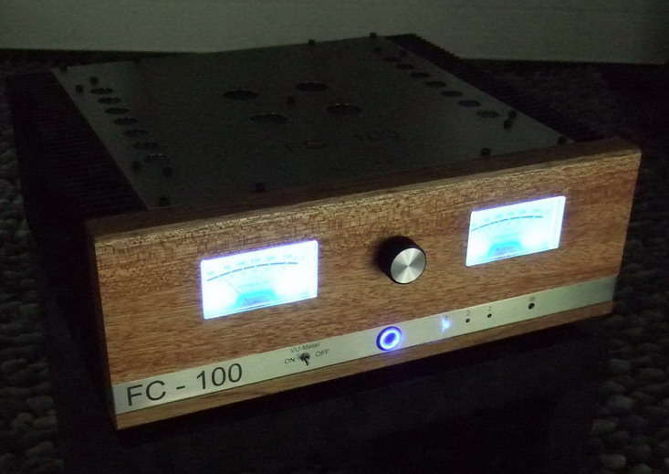

FC100 for Sale!
Hi there,
i sell my FC 100 assembly kit - including all parts - not assembled
I have way too many projects and I'm starting to sell some of them.
FC 100 - AMP complete including all parts - not assembled
