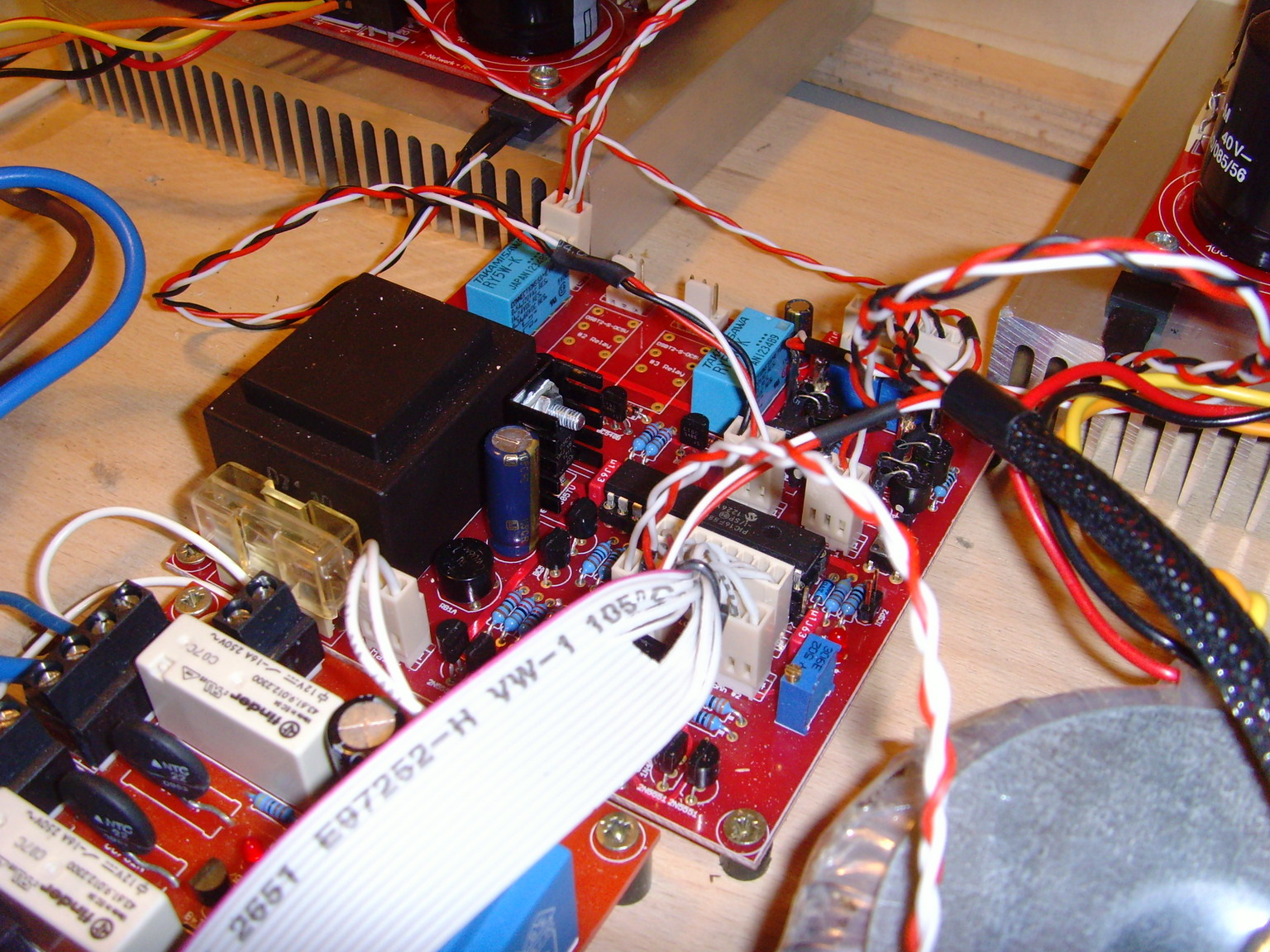

Yesterday night I have "married" the prototype of the new "multi-purpose Lightspeed-Attenuation board" with an old, discarded SYMASYM
of mine (see image attached).
Everything works as designed, I do not preceive any hum, every functionality can be controlled by an infrared - control unit, ...
(look at post #520)
I have ordered 10 of the PCBs and will build them with some of my German DIY friends, before I will offer this PCB to the community.
But: be sure - this small PCB is a real gem and an adeqaute mate for your FC-100.
Best regards - Rudi_Ratlos

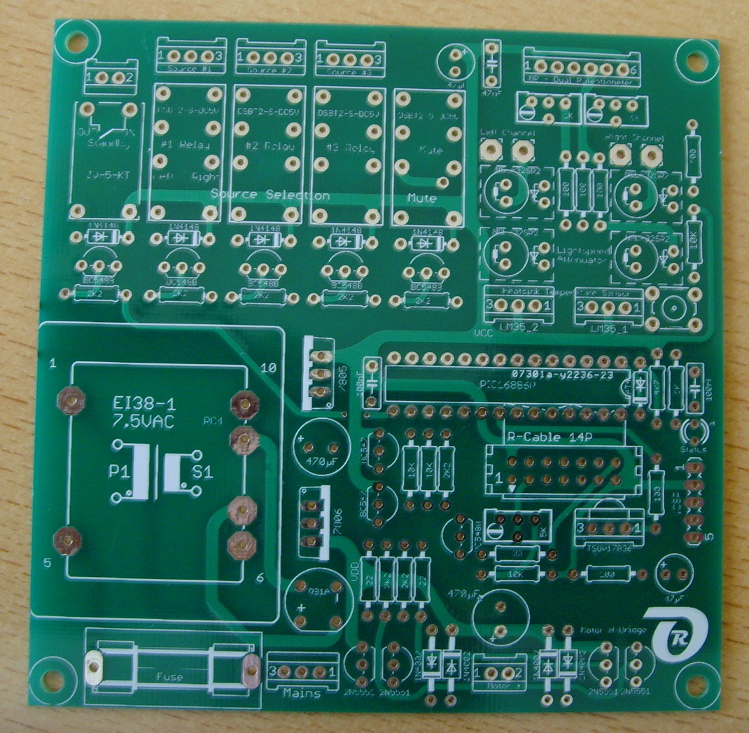

Adrian, I have already received a dozen of professionally etched PCBs and am currently busy packing the components that I offered
in the 1st round (see my post #522) into boxes.
The groupbuy includes:
- the PCB
- 2 matched pairs of LDRs
- a BOURNS 100K motorized potentiometer
- a small transformer 7.5VAC / 4.5VA
- a pre-programmed PIC 16F886 µProcessor and a 28-pole socket

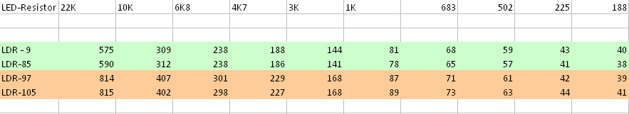

I have built a test-rig and measured the value of the photocell-resistor of a LDR at 10 different levels of current flowing through the LED.
Since I have ordered a big quantity of LDRs, I am able to offer well-matched LDR pairs to everybody who participated in the 1st round.
I have currently 2 sets left. You can have one, if you like.
Find attached the matching result of the LDRs belonging to one of these spare sets.
Colums B-K show the resistance of the photocell while the LED is connected to a 5V power supply through resistor B1-K1.
I have already written a Builder's Manual (in German Language).
The BoM (not including the LCD-display) can be found here:
https://secure.reichelt.de/index.html?;ACTION=20;AWKID=719405;PROVID=2084
The price for a set is 53.45€. Worldwide shipping is included.

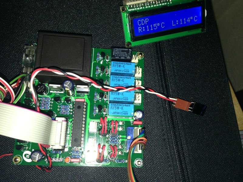

The 1st German DIYer completed my "General Purpose Lightspeed Attenuator" - PCB, connected it to his amplifier and
is very, very content with the result.
I will wait for the feedback of some other DIYers.
P.S. He did not yet connect the temperature sensors; he will do this this afternoon.
