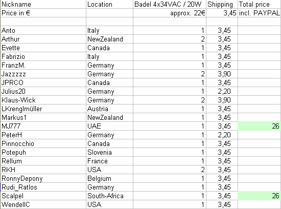

Gentlemen: as I told you, I will close the "Shunt-Transformer" group-buy tomorrow early morning and will order from BADEL then.
Find attached the current order list.
Two of you have payed already, and I have accepted their payments (my risk?, their risk?).
But: please wait with your payments, until I can give you the exact price (on Monday or Tuesday).
I have also been asked to quote a price for a transformer with the following sepcifications:
115 - 115 VAC / 4 x 25 VAC / 500W transformer, magnetically shielded, encapsulated, ..., with any option that you like,
to be used for both 117VAC and 220VAC primary voltage, suitable to drive both backend-PSUs of Mihai's FC-100.
The advantage: you do only need 1(!) transformer for the FC-100, and you will have "channel - independent - power" as well.
I will tell you the result of my request tomorrow / on Tuesday.

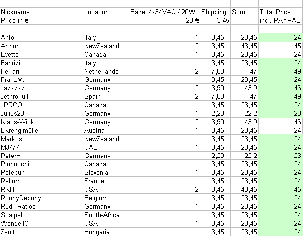

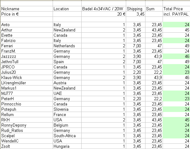

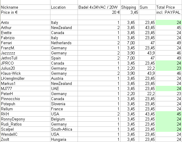

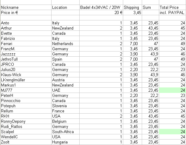

PAYPAL Time for Shunt Transformers
Gentlemen, I am able to offer you the FC-100 Shunt-transformers:
Primary: 115 + 115 Vac (suitable for 110, 115, 120, 220, 230 & 240 Vac primaries)
Secondary: 4 x 34 Vac / 20VA
Option: Magnetic Shielding
for 20€ per piece.
The lead-time is 3 weeks.
Find attached the resulting EXCEL sheet.
You can PAYPAL me now. My PAYPAL-ID is: RRozek@t-online.de
@Those, who ordered FC-100 PCBs and components as well:
I would like and include the transformers in your FC-100 letters (I will use a small parcel instead).
The shipping costs are the same for both alternatives (separate FC-100 letter / separate transformer letter vs. small parcel).
The parcel will be sent to you as "registered mail".
Best regards - Rudi_Ratlos

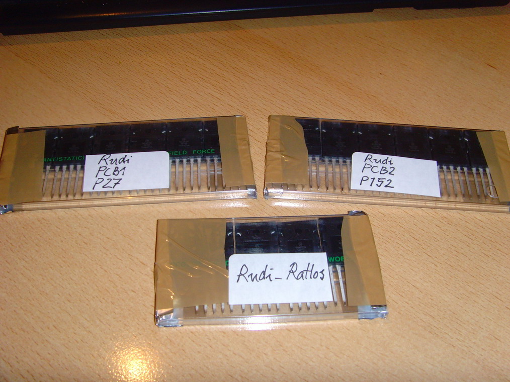

Gentlemen, I am through with matching and packaging the NJLs.
The Hfe matching results are very, very good and all (!!) of you have triples with a deviation of <= 1%!
Find attached an image, how I packaged them.
I have taken my own NJLs as an example.
Each of you will get 2 boxes with 6 transistors and 1 box with 4 transistors.
The boxes with the 6 transistors contain a matched triple of NJL0281 and a matched triple of NJL0302 for the use of 1 AMP-PCB
and have a label consisting of 3 lines:
- your nickname
- to be used for PCB1 (the left channel for example) or PCB2 (the right channel)
- a note which ThermalTrack diode has to be disabled (jumpered)
For example: on my PCB1 the diode of the Pnp NJL0302 transistor with number 27 on its back shall be bypassed;
on PCB2 the diode of the Pnp NJL0302 transistor with number 152 shall be bypassed.
The box with only your nickname on it contains the "spare transistors", 2 of each.

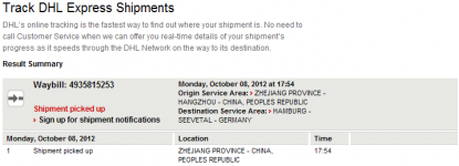

I am quite surprised: the PCBs have been etched today (!) and are already on their way to me!
So I will have them on Thursday!
I have already informed the main customs office in Leipzig, Germany, about the delivery of the PCBs.
In the past I had to answer their questions: "Rudi: why do you need so many PCBs? Do you own an "Audio - company"?
How big will your profit be selling the PCBs? ...", and this caused some delay several times.
I hope that the delivery of the PCBs will not be delayed this time.
Since I do not know exactly, when the BADEL 4x34VAC transformers will be delivered (I was told: lead-time is about 3 weeks),
