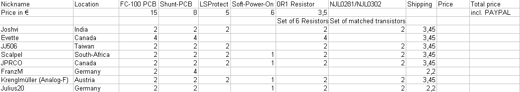

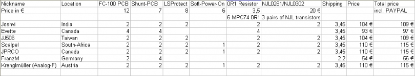

Gentlemen,
I received a quote for the 2nd round of group-buy of the FC-100 today.
Since I do no more have to pay for tooling, I am able to offer you smaller prices for the PCBs.
I will offer you Rev.1 of the speaker-protection PCB in this round of group-buy.
Rev.1 improves the stability; you can fit the OMRON G2R-2A relay, the AMPLIMO, the ... on it.
Rev.1 is tested and approved.
But since Rev.1 needs tooling again, I have to raise its price a little bit.
Concerning the OP-transistors: a pair of NJL0281DG/NJL0302DG costs about 5€ currently (MOUSER-price).
You need 3 pairs of these transistors per PCB.
I will match them for you (if you like).
In order to have a "bigger pool" for the matching process, I think that it is wise if you order 4 pairs per PCB.
That is why I calculated 20€ per PCB. I will of course include the spare transistors in your letters.

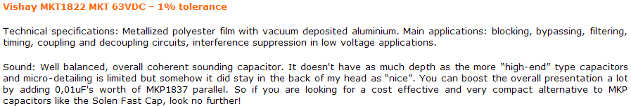

Maybe it's time to buy the last pieces from the market.
Patrick,
the max. grid of the input DC-blocking input capacitor is 15mm.
Everybody has to decide by himself, if he needs an input-cap at all.
If he is sure that all of his music - sources are AC-coupled, he doesn't need.
If not:
I recommend to use of MKT1822 bypassed by MKP1837.
I use this combination myself: I "glued" the MKP on the solder-side and then soldered it.
The value: max. value with a grid of 15mm.
Do you have any other recommendation?
Best regards - Rudi

At a dutch forum someone is offering Vishay-Roederstein 1820/10µF MKT's for a fair price.You always can bypass them with the MKP1837
I used this one: IT-Tronics - 5x MKT Kondensator radial 10uF 100VDC RM27,5 ; RoHS ; 1822610015
they will be 5€ for five pieces ( Roederstein MKT1822/100V )

If you can find an old stock polycarbonate folded film (rather than wound) then it is almost as good as polypropylene at half the price and half the size.
I think the carbonates are better than the various esters and terephthalates.
