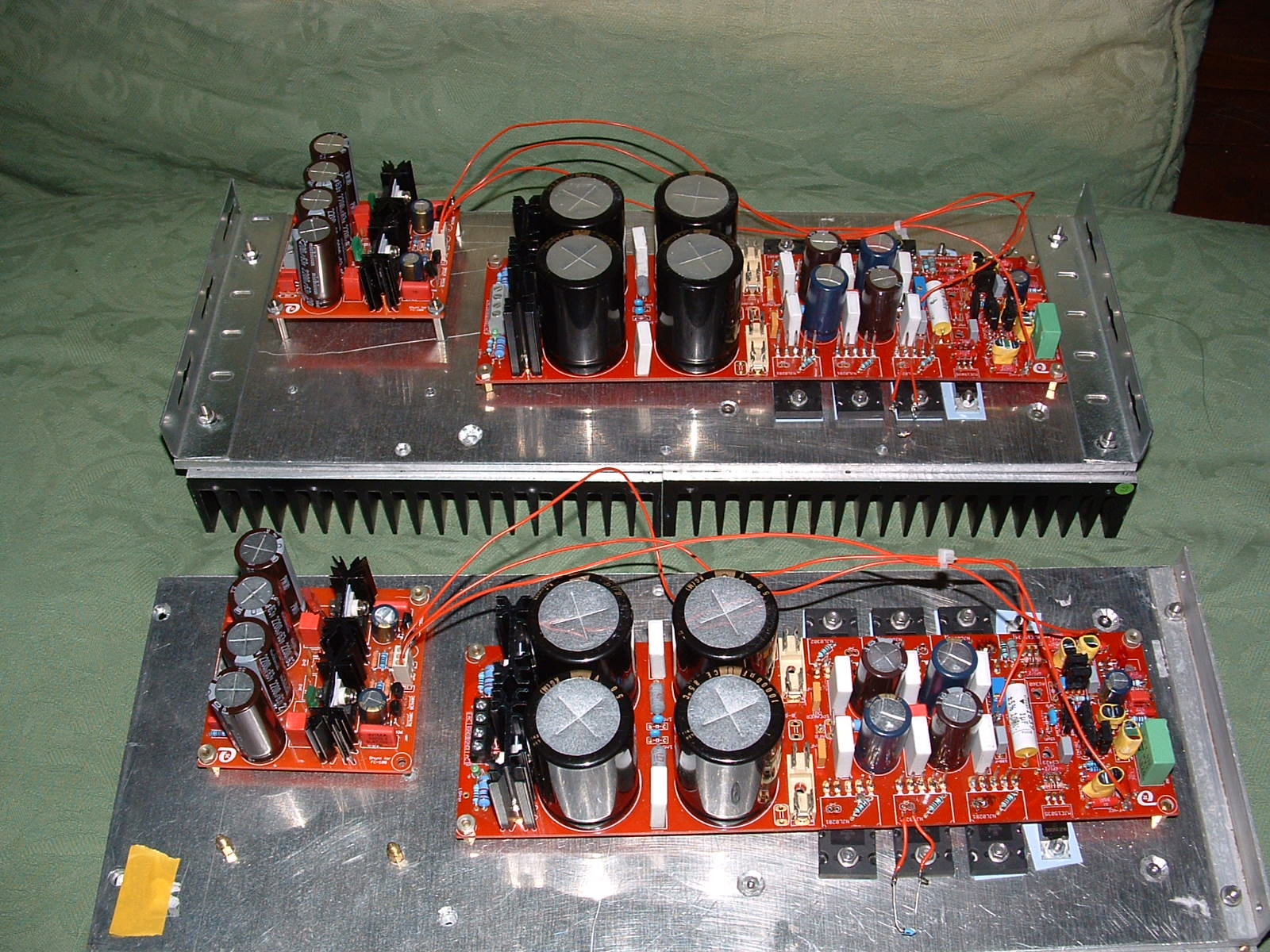

Yes i screw alu plate to heatsinks,my resistance reading are zero for all (fingers crossed i did that right) Photo for you Rudi.🙂
It cross my mind that the amp had ran for a very short time and both boards had same fault at same time that this was a component failure

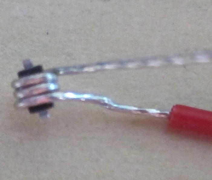

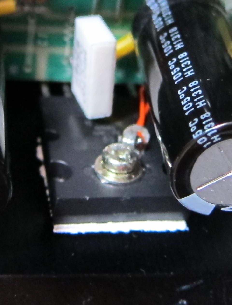

Did you solder (??) the ZENER diode (the one that replaces a TT diode) to the heatsink? I see some small solder points on the picture.
Best regards - Rudi
Best regards - Rudi
Dear oh dear; That diode is meant to be thermally bonded to the heatsink 😡, not electrically connected. How did you manage to solder aluminium?
Are you sure you have enough screws to join the aluminium plate and the heatsinks? You have to have heatsink compound on the joined surfaces which I do not see. Maybe you did a very good job of removing the excess.

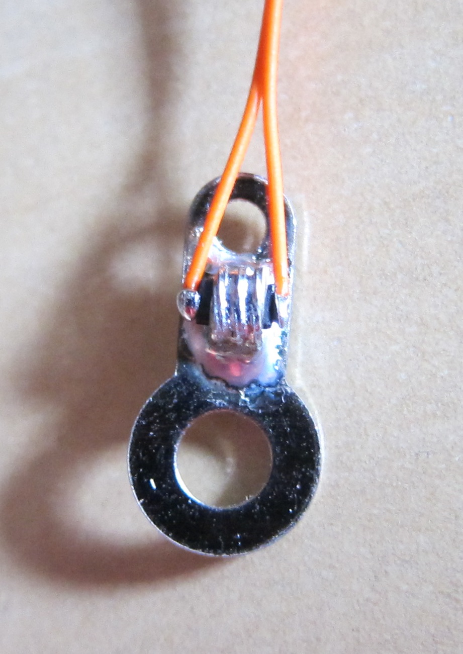

This is how I handle the external bias compensation diode (I used MBR0520L), first, use a wire and wound around the diode, then, soldered the body on a wire connection ring and mount on top of the transistor. The heat dissipated from the transistor will transfer to the diode effectively thru the mounting screw.
I have tested this method and it is very effective, I saw the bias start to raise but quickly corrected. It is able to maintain a constant bias current without thermal runway nor over compensated.
Yes Rudi soldered and checked with meter thanks john
Thanks for help I will do that,,what I should have said now I have read Rudi s post again slowly is that the diode is soldered to the short wire each side ,not the sink ,I already said both sides have played music ,,now just fuse soon as I switch on ,I give in

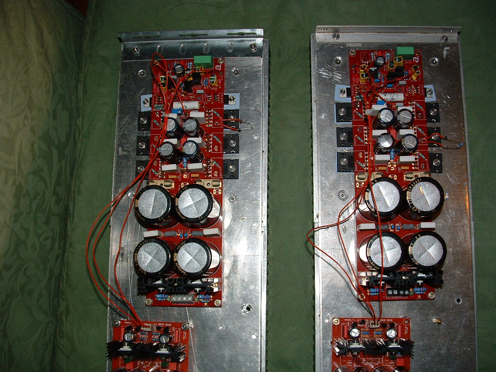

Andrew, Sheldon: your posts concerning MAG - to - Chassis connection is very interesting and informative, ..., but: will it help John to resolve his current problem?
As I understand John: both channels have worked, played music from a short while, but from the moment on, he connected his channels to his case (front and back-panel) the fuses blow.
There must be a short, somewhere. This is my opinion.

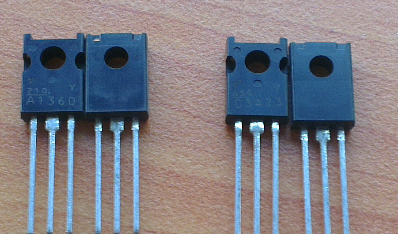

Update :
Most of the 2SA1360Y have Hfe about 155. A few about 170. Same lot number
Most of the 2SC3423Y have a Hfe of about 184. A few close to 200. Once again all from the same lot number.
How close a match do I need for the 2SA/2SC pair?
Paul, from looking at the case alone, your transistors look like genuine Toshibas.
