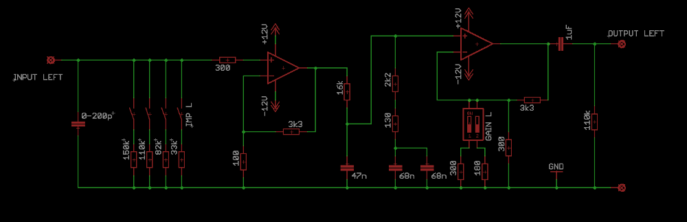

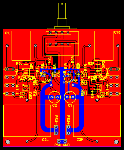

Hicoco, that's one hell of a schematic. Very professional, congrats!. Now show us the pcb when done:D
Regards
Prasi
Thank Prasi, this is the first round.....not done yet

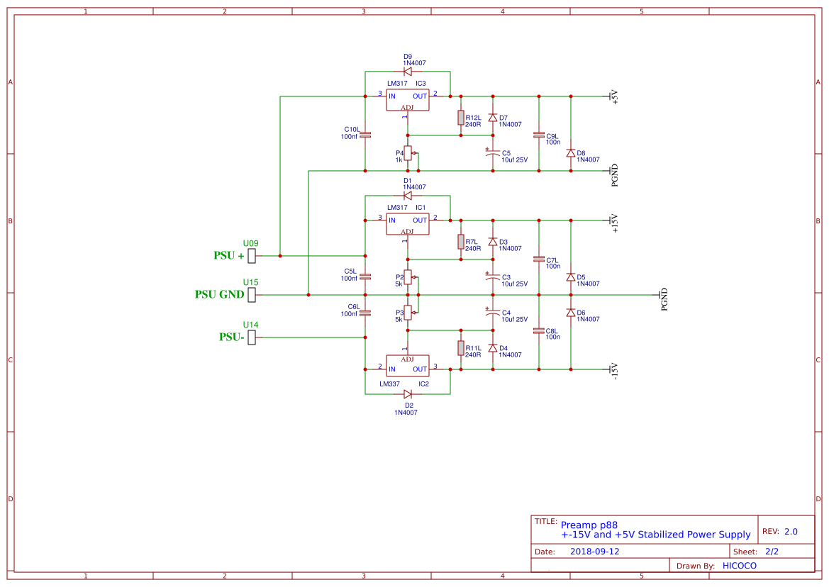

Prasi, thank again, this is very nice coming from you as you are a very fine PCB designer.
This preamp is an adjunction for my LM3886 amp, I have to ad a +-15V and +5V Stabilized Power Supply for the preamp and a Bluetooth audio receiver.
I have the power supply for the Amp (35V after the bridge).
I have 2 questions:
- May i use the same power supply with this schematic?
- if yes may i add it on the Preamp PCB just before the 220uf caps at the Preamp input
Hello Hicoco,
You have asked a difficult question:). I am no expert, but I would suggest to keep it modular so that you could try different PSU if you feel the need, however everything on a single PCB makes it very comprehensive. Its your decision.
Beware of ground loops when designing / building , it can cause sleepless nights.
regards
Prasi

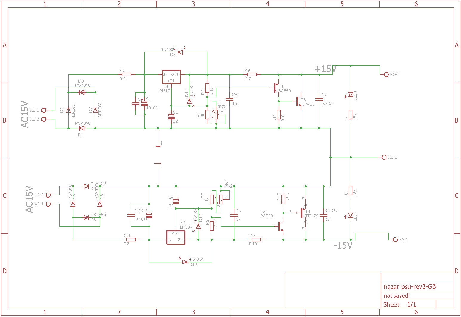

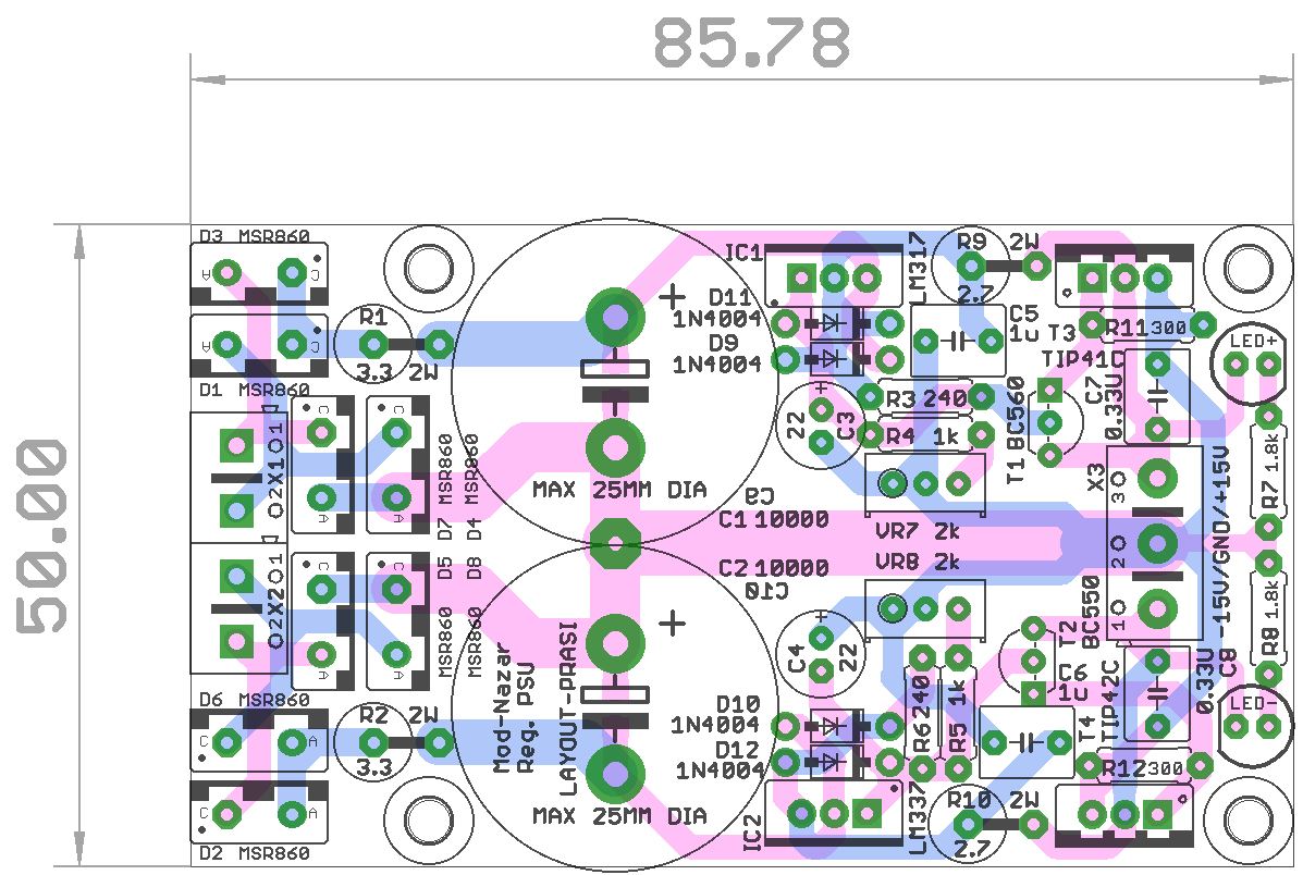

Have a look at the Nazar psu which i made pcb.

Yes, but coupling cap always has resistor to ground after it, it doesn't matter if it's input high pass filter or output high pass filter. They always go together. Cap + resistor = high pass filter that keeps DC out.
but then again some designs seem to use a coupling cap without a resistor. would that still be a dc blocking cap or does it serve a different purpose?
Without the resistor filter is not complete. In the case of the above schematic 1uF output cap will be in series with input cap of power amp (or some other preamp) and their combined value will be too low. Output filter should have resistor to ground or else output cap on the above schematic should be completely removed (if power amp has it already).
This look like RIAA circuit and there should be resistor to ground after 1uF.
makes sense! thanks!
if a passive pre amp is used right after this schematic, say with a 20k volume pot, will the resistance of the pot add to the characteristic of the filter?
i'm thinking the 110k resistor would be in parallel with the 20k pot resulting in a 16,9k parallel resistance. together with the 1uF cap this should make for a roll off at roughly 9,4 Hz.
is my thinking right on this?

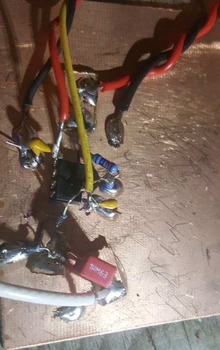

My ESP P88 build is under way. I've got the power supply board finished and the first stage of one channel. It sure is fun to see a voltage gain of 2 show up on the scope.
-Neil N0FN
