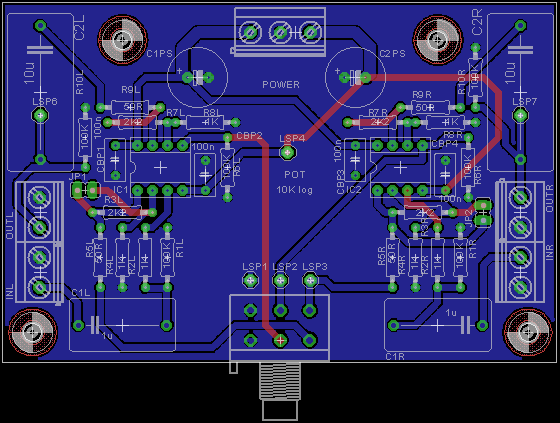

I copied Prasi's P88 PCB and added some goodies:
1. Jumpers for shorting input stage feedback resistor - easy way to select 0dB gain or whatever gain is selected for the input stage
2. There is no footprint for ALPS RK27 pot in the Eagle libraries so I just left enough room on the pcb to accommodate it's footprint 28mm x 26mm and added three solderpads that suit ALPS RK27 pin layout
3. Input cap footprint is like Prasi's 15mm lead spacing but I added footprint for 22,5mm output film cap because there is 10uF Wima polyester cap in the local shop with that footprint
I think this is not finished pcb design. This pcb has more potential for improvement.

The PCB in post #61 has some issues. I would suggest to revert all traces to the top layer as much as possible with solid ground plane on the bottom layer as Prasi did it initially. Another problem to look at is the mixing of power supply return and signal ground routes. I would suggest to route the power supply from the middle of the PCB to the corresponding power pins of the op-amps under the ICs (between the rows of pins), then route everything signal related on the outer (left, right) sides of the PCB making sure that signal traces do not cross power supply traces. Such arrangement will prevent mixing power supply return and signal ground routes.

That could be done only if one would use one dual opamp per left/right input stage and one dual per left/right output stage, as I did in my actual P88 from the photo. But the attractive side of Prasi's board is that each channel has it's own dual opamp - there is no crosstalk between channels! Everything is crammed inside duals and there is crosstalk if left right is inside one opamp. That's why JRC developed MUSE series of high performance opamps, to solve, as much as possible, the problem of the crosstalk inside dual opamps.

As for the PCB layout and channels cross talk. If you look at the OPA2134 datasheet Fig. 12 as an example, you'll see that the channel separation is better than 120dB up to 20kHz and better than 110dB up to 100kHz. I find it more than enough for line level audio applications. I think significantly higher cross talk can be generated by the PCB layout constraints.

It would be very difficult to route pcb the way you suggested with the component placement Prasi used. PCB would need a completely new layout of components. I just liked Prasi's layout and accepted some limitations that comes with it. But I followed your recommendation and moved most of the tracks to top layer leaving just necessary tracks on the bottom.

I understand the difficulty since it may require nearly complete redrawing of the schematic and PCB layout. Anyway, having solid ground plane is already a big improvement.
