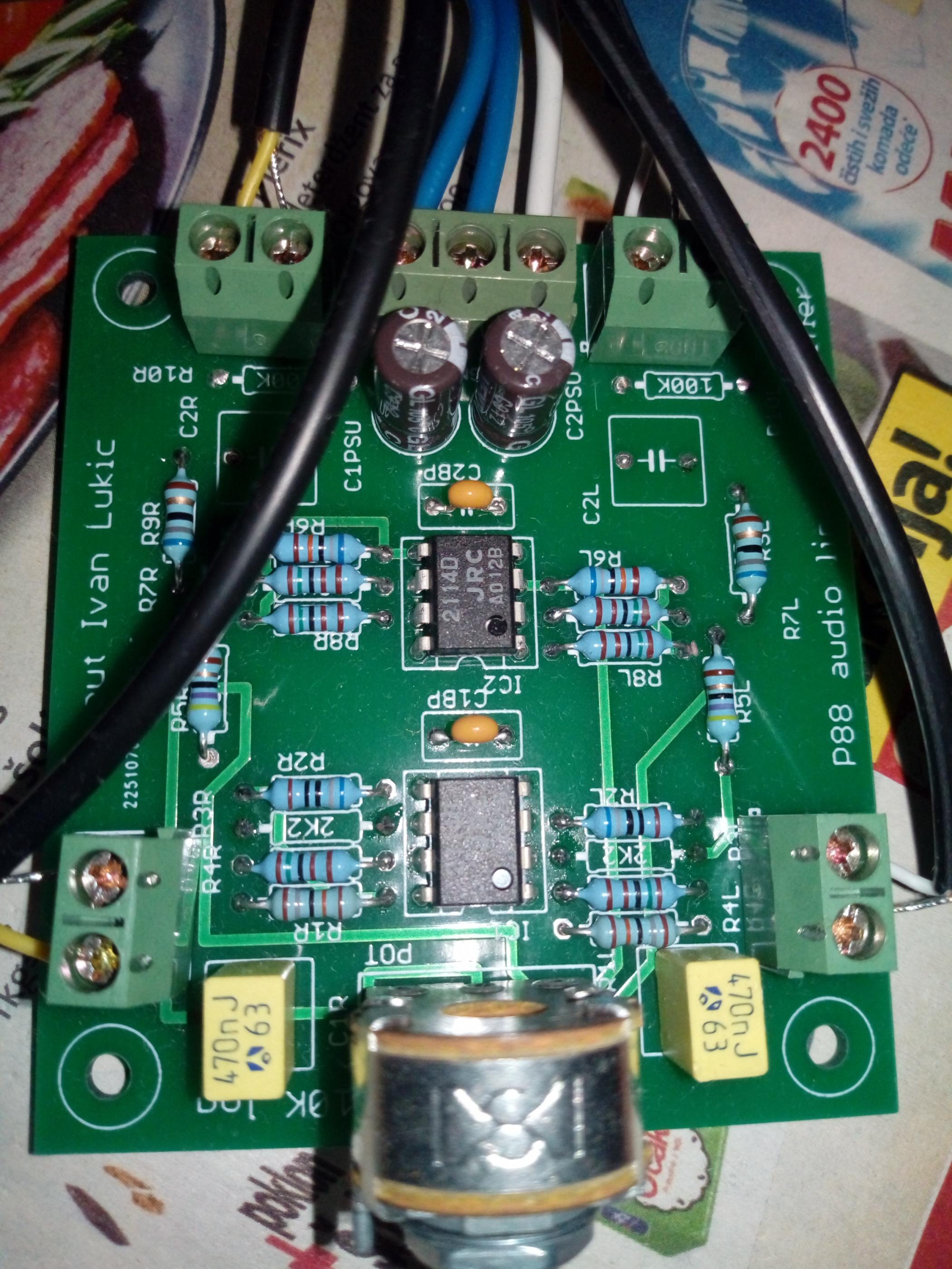

This is P88 on the boards that I designed to have pot onboard. I don't like cables.

I used the same method of bypassing opamp power supplies as used in original ESP P88 boards because it's the easiest way to route the board. One 100nF non polar cap close to each opamp PSU pins and one elco per supply rail few centimeters away that serves the whole preamp. Doug Self claims that for TL072 and NE5532 one non polar between supply rails close to opamp is enough. The real question is what kind of non polar to use? It seems that different kinds give somewhat different sound. I use MLCC for these positions but there are claims that polyester is better choice.
What you see in the photo is my test P88 board. Therefore I used what was at hand at the moment of assembly. I used 47K pot but I also used 680K resistor to ground at the noninverting input of output opamp. The value of the pot should be 5 to 1o times less than input resistor to ground. I do not recommend that you use the pot and input resistor that I used for my test build. Why? Because the values I used are to high compared with values I used for the feedback and gain setting resistors, so I ended up with high DC offset at the output of P88. If you do not include balance pot I suggest that you use values suggested in ESP article. At the output of first opamp stage you should have 50-100R series resistor, than 10K log pot and 100K input resistor to ground at the input of second opamp stage.
Here is schematic for my P88 boards. Please note that I used jumper instead of R3 and left unpopulated R4. Input cap should be at least 680nF and output cap should be 10uF bipolar elco or left unpopulated if you power amplifiier has input cap.

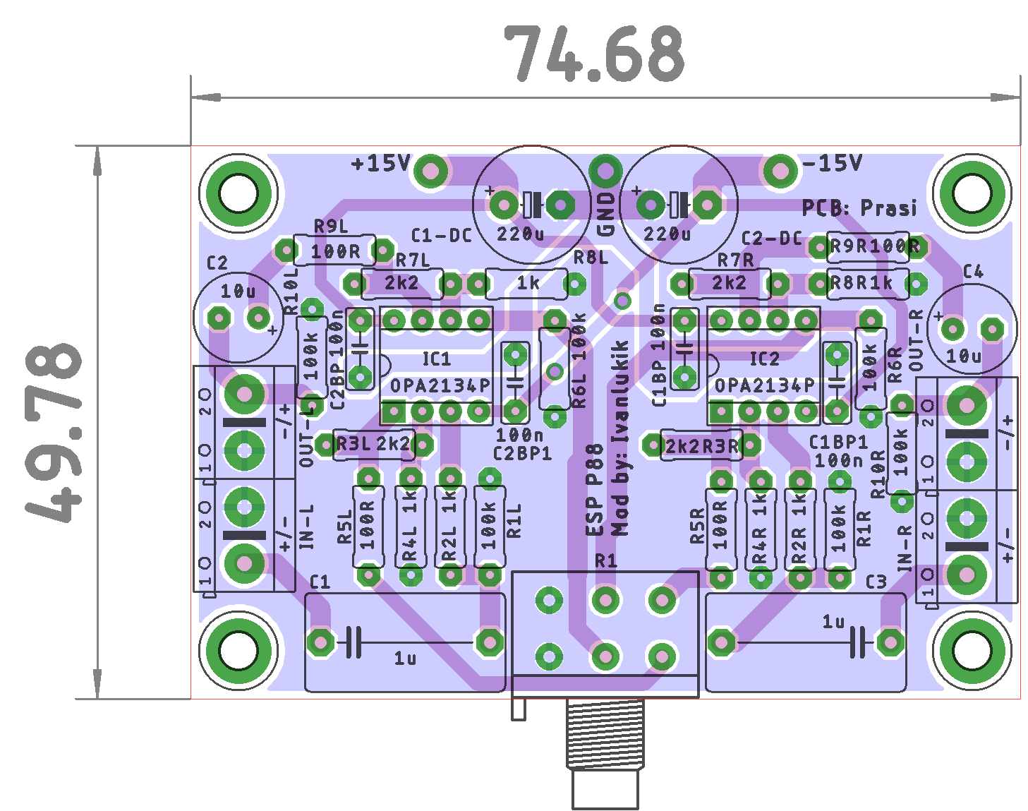

PCB from my photo is my second try for P88 and it's called P88 alternative. My first try was much more like Prasi's pcb, opamps side by side, not like my second try where one opamp is behind the other. But Prasi's pcb is much better since he has much more experience in pcb design.
I do not use 7,5mm lead spacing for 0207 resistors in my pcb designs because it is dangerous practice to bend copper leads at the joint of resisitor body. Although it saves pcb space the joint could be broken or damaged and made unreliable. I red a few warnings not to bend wire leads at the joint. If it is necessary due to pcb space restrictions do it very carefully.
Hello Ivan,
I have my created my own package where the lead spacing is 8.64mm and gently bend the leads. i havent faced a problem till now.
regards
Prasi
