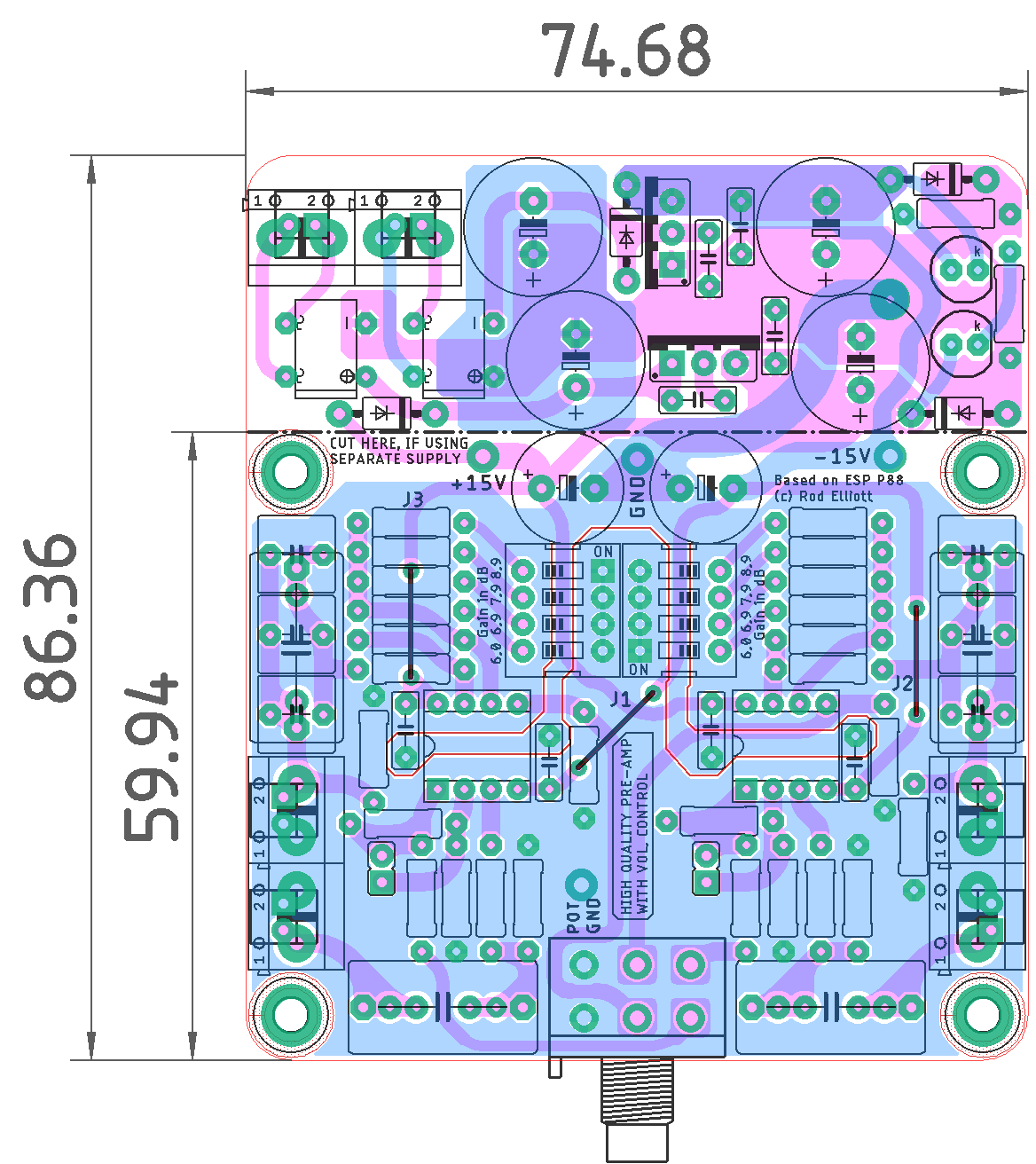

I've looked at a few PCB designs in the last few days and i see various approaches for using two layer boards. is there any "state of the art" way of doing it? for example power tracks on one layer, signal tracks on the other? also i notice there's usually a "flooded" layer for gnd. is it better to flood the bottom or top layer - the one shared with the signal or shared with power? others like phonoclone (VSPS) seem to keep signal ground and power ground seperated.
any general advice would be greatly appreciated.
it needs to be addressed on a case by case basis - sometimes ground planes are magnets for noise, other times they quiet things down.
If a layout is quiet, how it was accomplished doesn’t really matter.

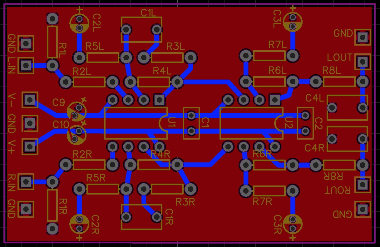

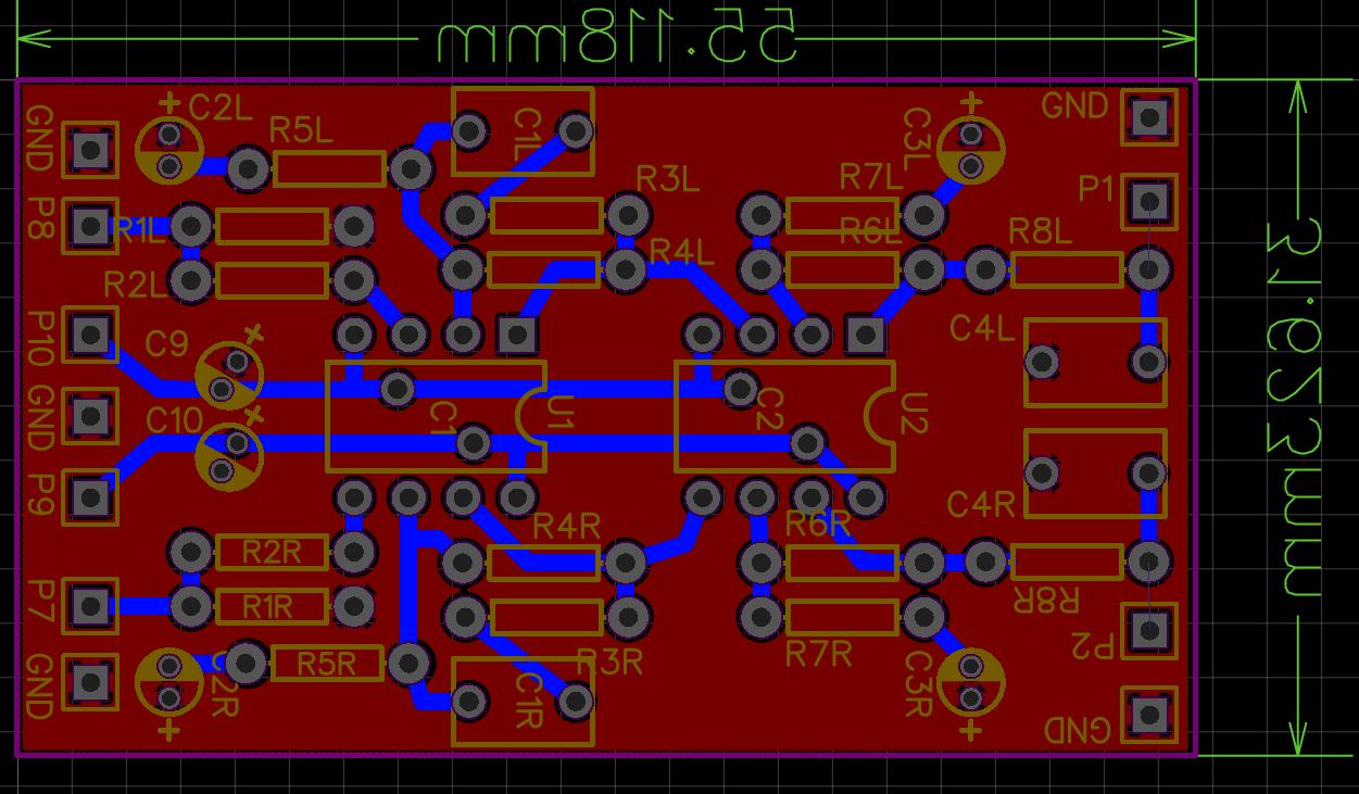

Two questions came up while working on my version of the p88 PCBs.

Two things:
1. Boards must be able to integrate in the complete preamp without creating internal ground loops all over the place. I do not think that this is the case with the ground pour connecting everything together. Confirm by drawing out the grounding scheme of a complete unit (power supply + pre + phono).
2. Impedances around the opamps in P88 and P06 are decidedly on the high side and IMHO would give higher noise levels than necessary, especially since OPA2134s and NE5532s are rather good load drivers and not easily impressed by loads even down in the low kOhms. Presumably the values were chosen for the much weaker TL072. I would suggest lowering them by about a factor of 3 for starters, maybe up to 5. (In P06, this would be R2-R7, in P88, R3/4+7/8.) The crux: Any capacitors forming RC time constants have to be increased accordingly, with much fewer values available, so if in doubt select Cs first.
