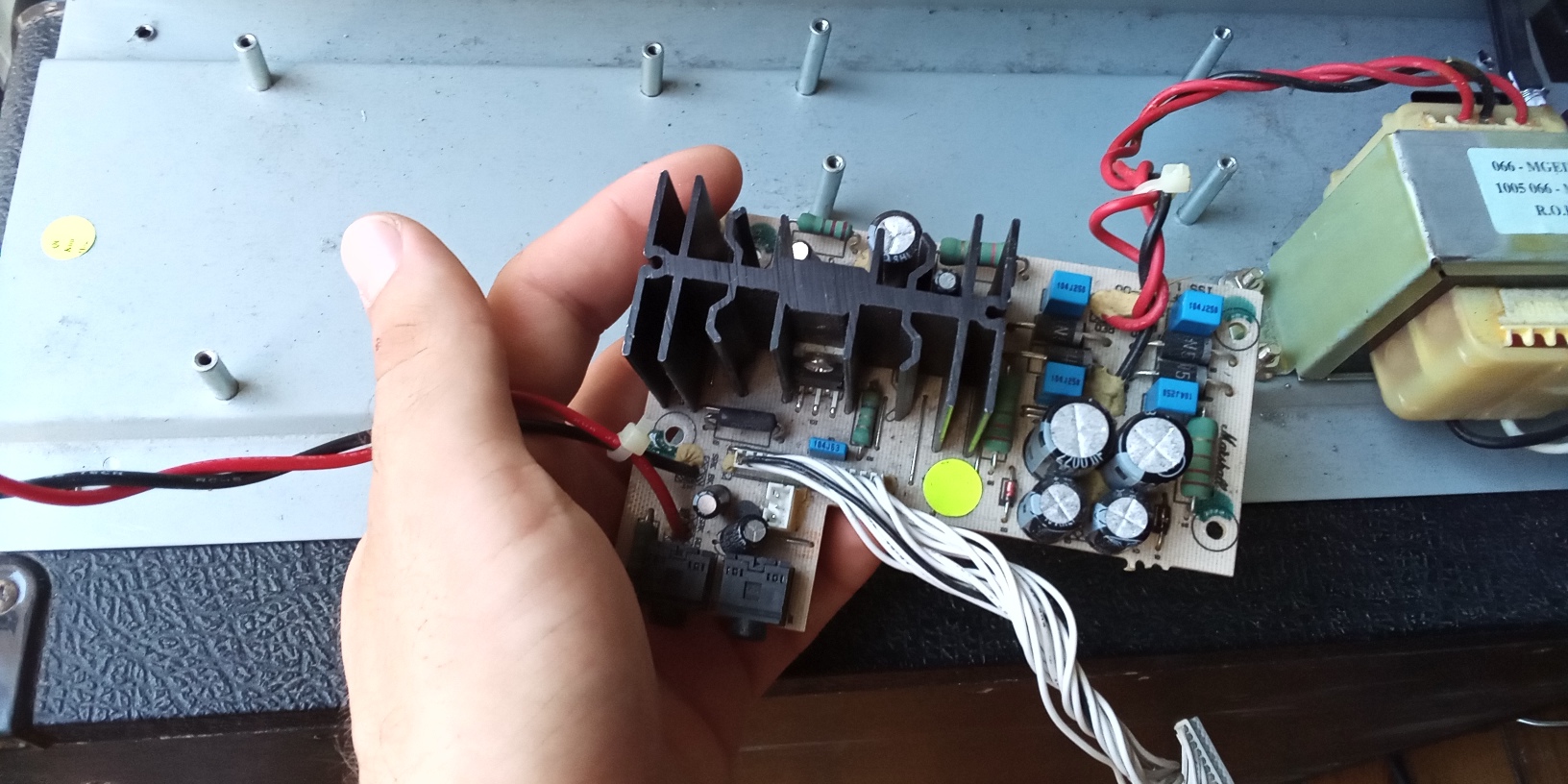

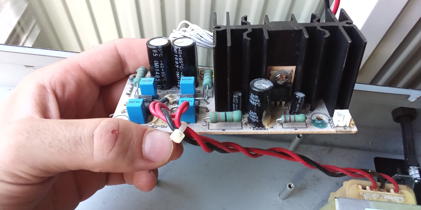

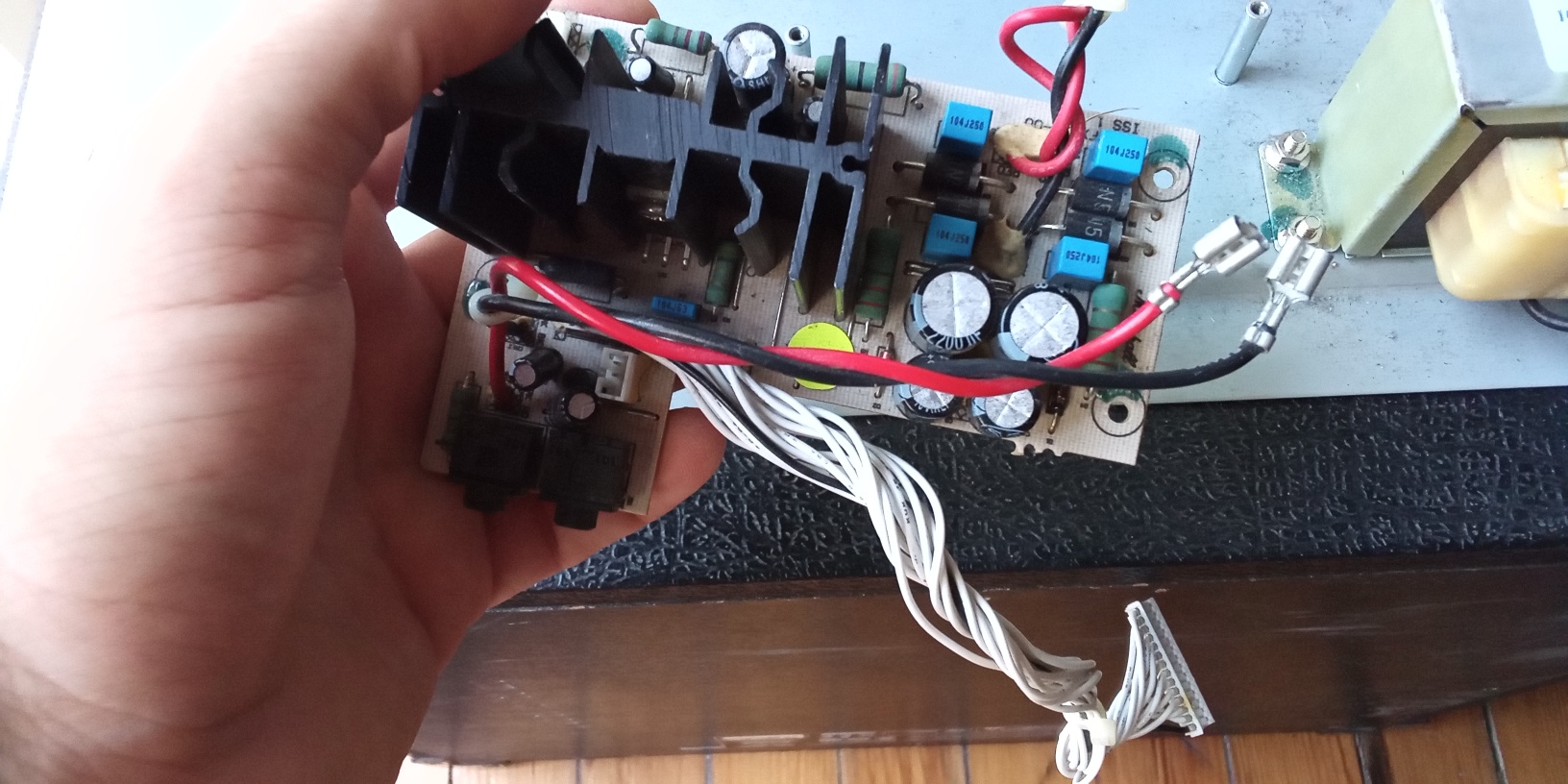

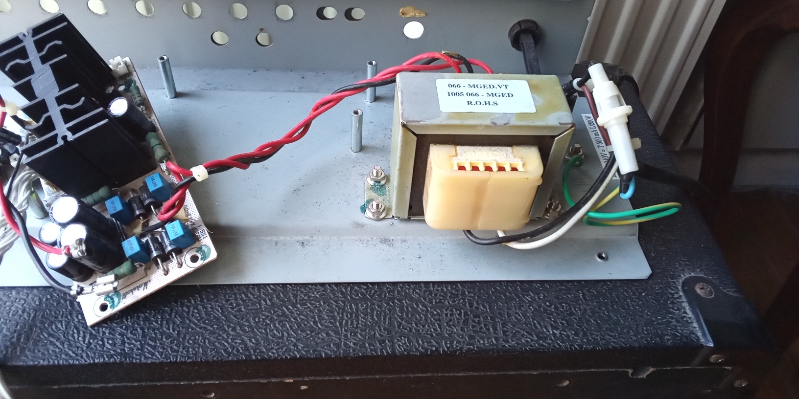

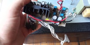

And some pictures of the "patient"

Hey! You have 90% of your problem solved!!!
You have chassis, cabinet, speaker, power transformer, power supply (both working as you say), you only need to make the preamp.
That PCB certainly has +/-15V OUT to feed former preamp, fine for the new one, and a Power Amp signal input .
So reassemble it, connect speaker and turn it ON, it apparently works, if one of those mini jacks is the CD player input, connect a Phone or Player and test it works.

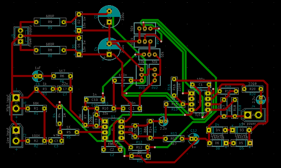

Ι have made a pcb sketch in KiCad. It's my first sketch so it might be sloppy.

I tried it but I think I made a short and blew a diode. If I am not mistaken is the 1 watt 15V zener diode. I replaced it and something strange is happening. The diode I replaced has 15V when I measure it. But the other zener diode has -8V. Shall I just replace the diode? or there is a chance that something else is going wrong?
(in the schematic they are placed in bottom left and named zd1 and zd2)
And if I am not mistaken (once more 😛 ) I won't need the power section of the preamplifier from the Elliot design. (I am reffering to D5, D6, C12, C13, R19 and R20 from figure 1 in Elliots schematic for the preamp).
