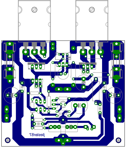

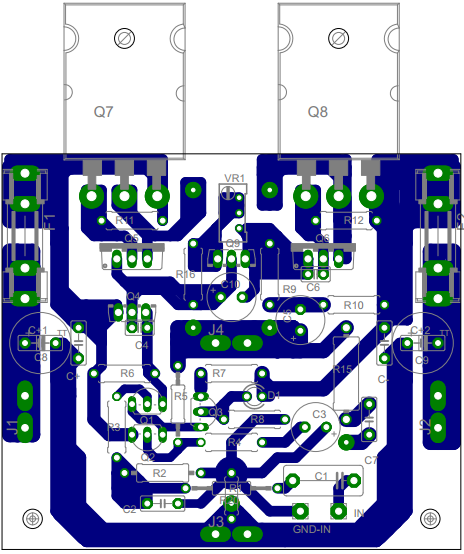

Power tracks running in parallel with sensitive signal track can induce noise because the two inductors act as a transformer. There are many small things to look out for to avoid if possible, there is no magic formula, it is a learning curve. I think your previous board is as good as it can be, you have followed all the guidelines.
Is this good? I still prefer the previous one though...
The previous one is better. With this current layout you will modulate the left hand side power line to the driver circuitry which is very audible and definitely measurable.
What I mean is that the power transistor connected to the left hand power trace will pull the voltage down to the low current circuits connected after it each time it draws current.
This is my favorite layout, it uses no jumpers(except for a wirelink in speaker zobel ground), and all the components are on board...

Decoupling Caps should be after the fuses not before. Fuses and holders have resistance. I don't like fuses on power amp boards. I always build them as part of the power supply not the amplifier, which is where they should be.
