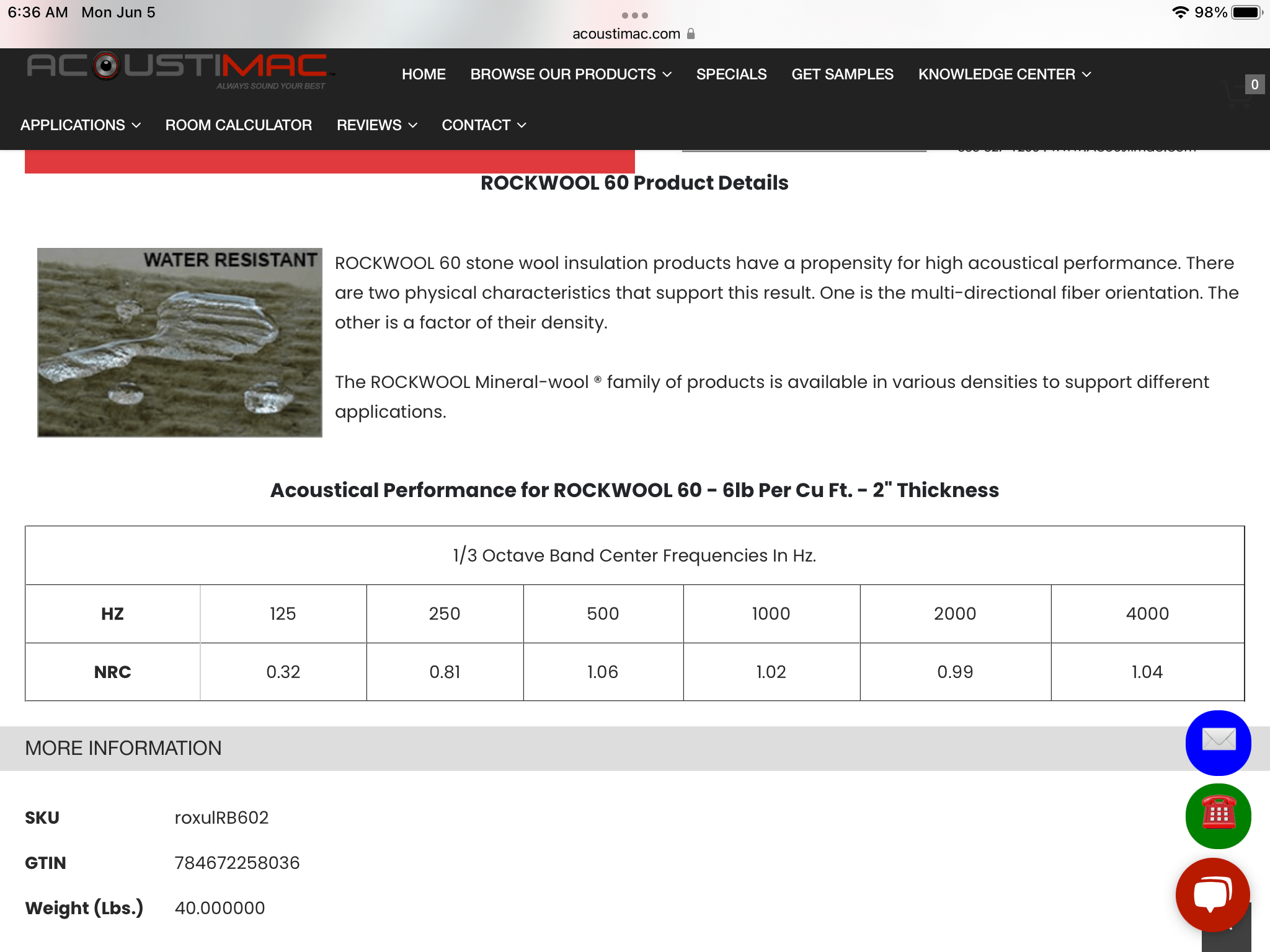

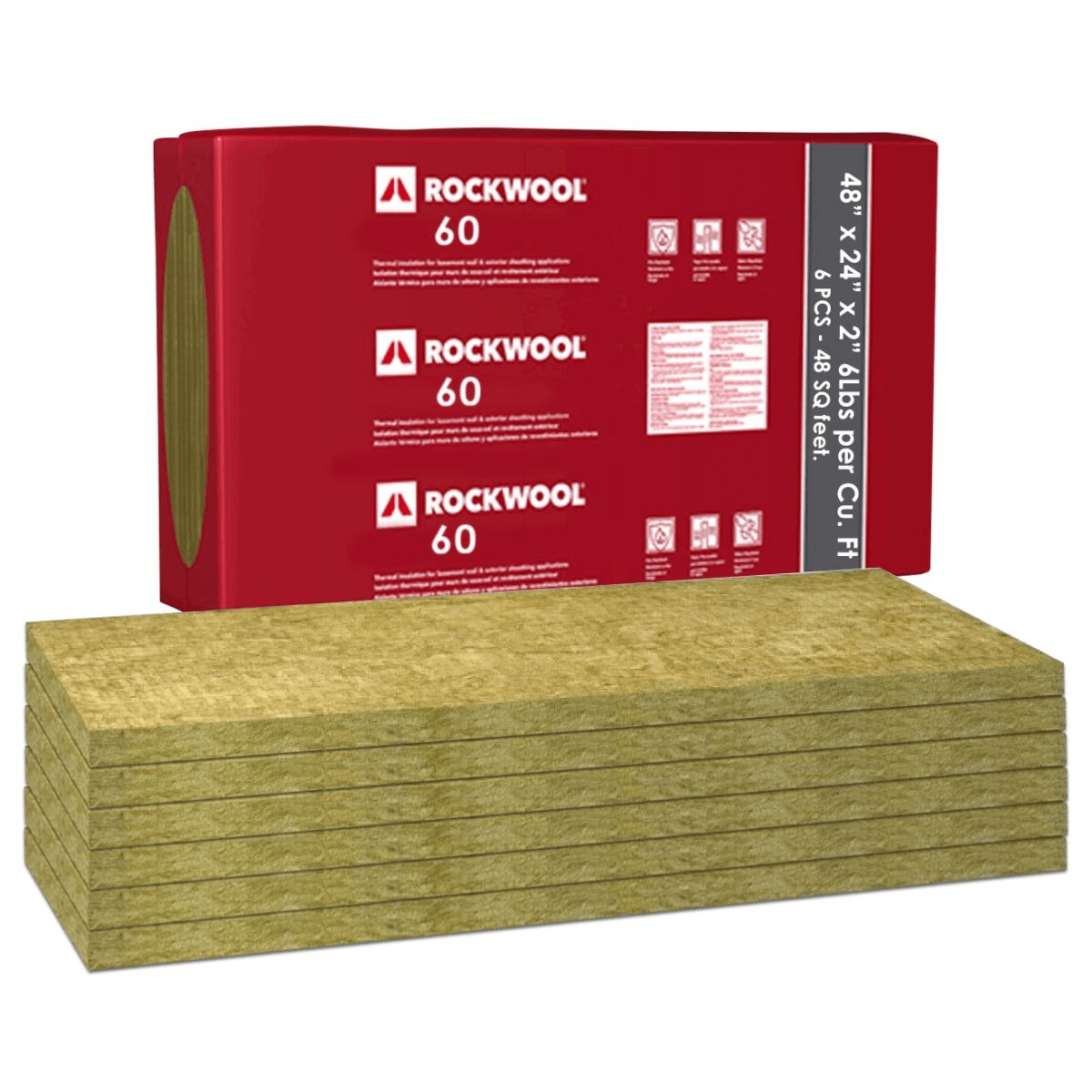

I’ve used this a couple times on the back (inside) of the speaker box, works well taming down to 200hz +/- backwave.
Uses a little box volume (6lb/Cu ft)……anyone know a way to figure out percent of air volume displaced?

Good for reducing cabinet reflections, but could that magnitude of density also go some way towards reducing the available internal volume?
I'd be interested in an expert opinion.
Yes it would have to be factored into the design, my guess is its at least a 30% reduction by volume…….so for example (at that guesstimate)……
2”x12”x24” = .21 cu ft +/- ……but the question still stands on how to figure it out exactly from 6lbs/cu ft?

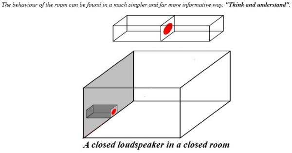

My advice to you is to line your room with better damping materials, and Wool ticks most of the boxes:
You could do Worse than employ Rockwool:

This stuff is made for sound absorbing, NRC numbers over 1.0 means 100% absorption @ that frequency.That may not be possible, but we can assume that material which is too tight and dense will simply reflect rather than absorb.
As for room acoustic panels, these are rigid enough to just wrap in cloth and hang on the wall without a frame.
