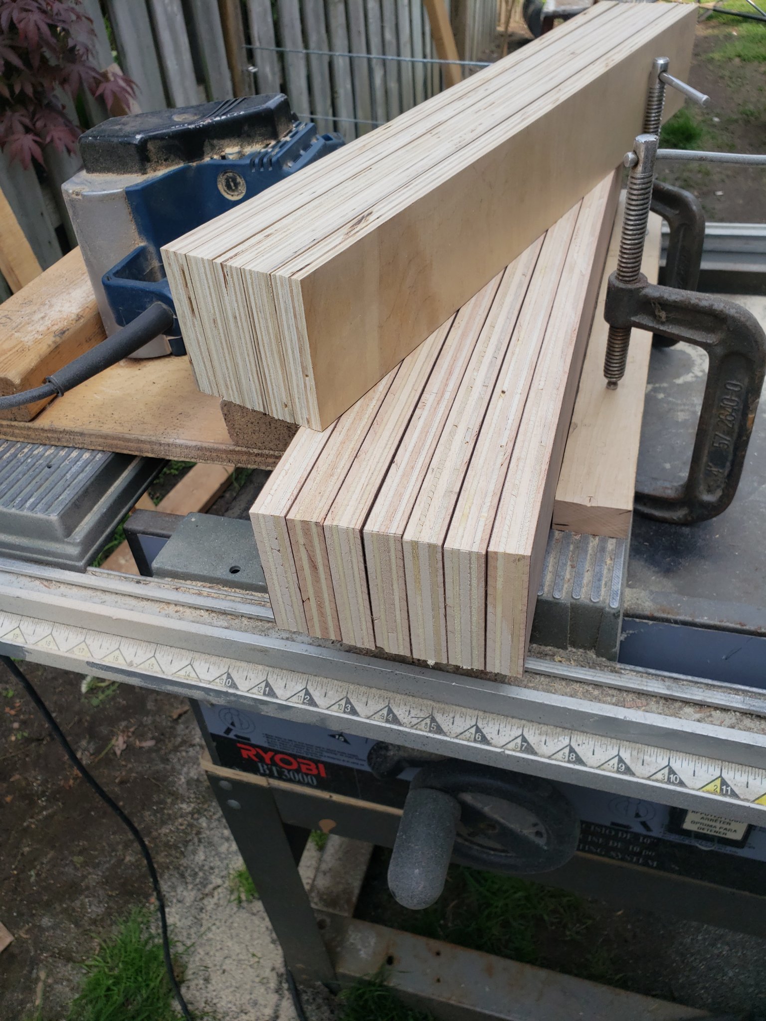

I've been thinking of doing some kind of a multi layer for my treatments, having about one inch of RW at the back, or the bottom depending how you look at it. Or even say 1/2" RW to fill half followed by a natural cotton or something similar over top to fill the other half. I figure that might prevent or help prevent RW particles from getting air born. What do you think?
These panels don't have a whole lot of depth, a mere 3 1/2" x a couple of feet. These are supposed to go on the wall directly behind stand mounts. I cut enough to have an extra one.
