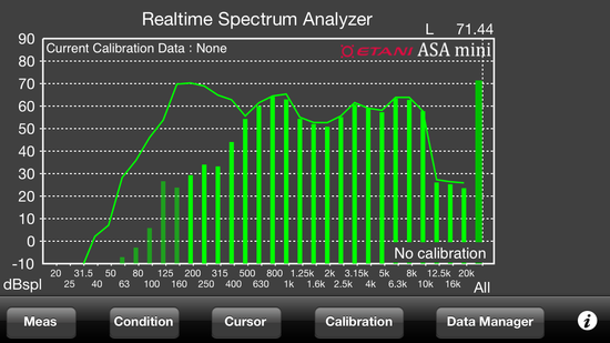

freddi - No apology needed! 🙂 Thanks for the explanation(x2). A friend of mine made a simple measurement of the LS cab in my room with a Synergy horn experiment on top about a year ago.
I guess the graph can tell you much more than I can.
(The hollow portion below 450hz is the LS - obviously. LOL)

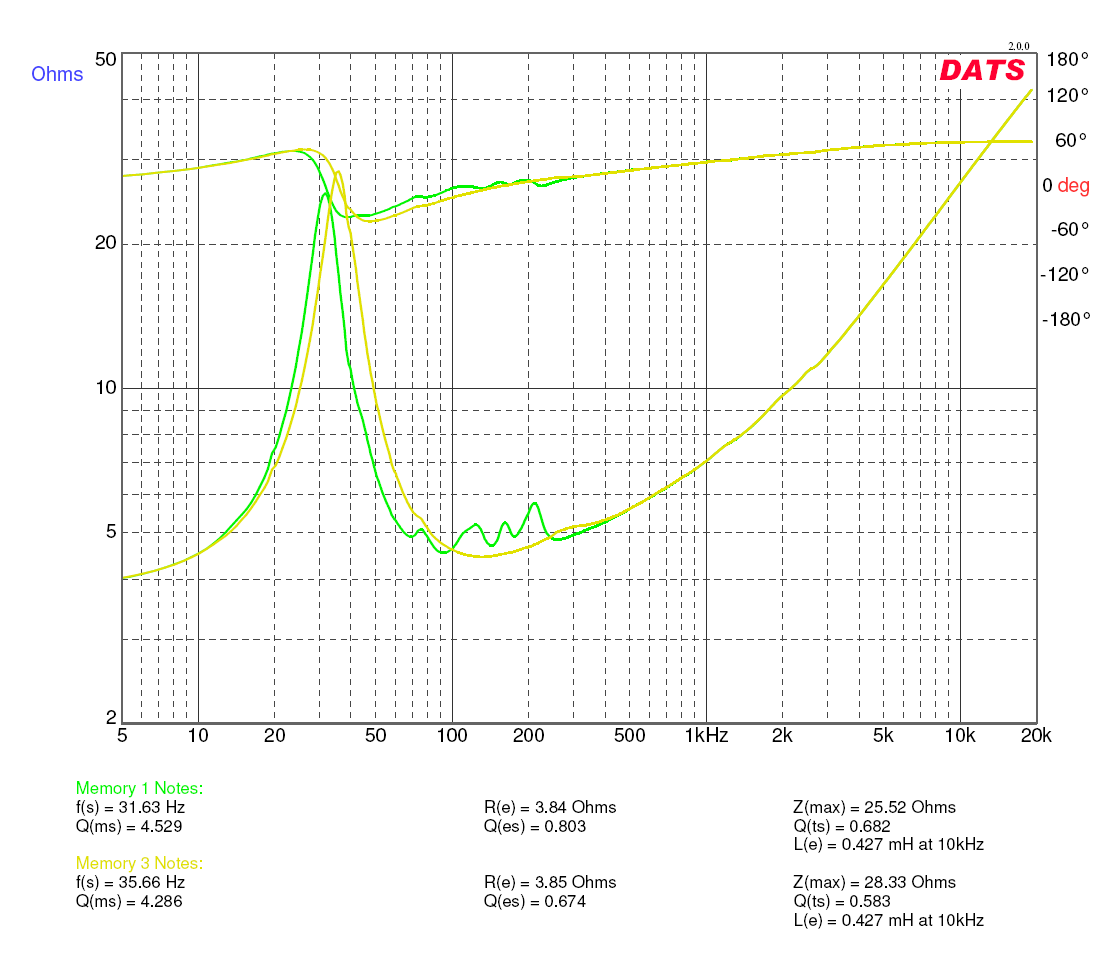

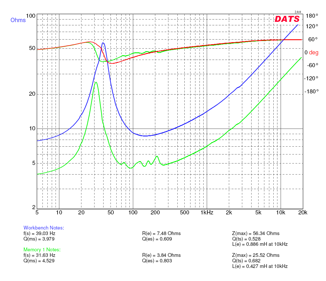

Here is the impedence sweep of the KaZba (green) compared with a single driver (blue). The KaZba cabinet brings the fs from 39Hz down to 31Hz! That is surprising and means that there is an air mass loading going on. Qts is about 0.69 vs o.53 for bare driver. The squiggly business from 100-200Hz may be K-aperture vibration and buzz that is audible. Need to stiffen it and use foam gasket to absorb motion from pressure.
If I remove the two K-apertures (yellow), we see that the absence of the apertures shifts fs up to 35Hz and decreases Qts to 0.58. The wiggles are definitely caused by the apertures.
nice Qt! plus a substantial drop in fs = cool - -if this can be translated predictably to larger KaZba - then there will be a new configuration for the hobbyist. Is Qt similar with wings removed?
I knew you would ask, see previous post and again shown below. yes...
Without K-aperture fs is 35Hz, with 31Hz and Qts goes from 0.57 to 0.68.

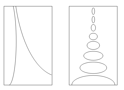

For the vibration on the wings, how about these?
Wow! Solid 30Hz response from an OB dipole box? With two buyout 8 inch drivers? That's impressive!
Maybe you should set up a website and start a business, xrk! 😀
CLS - The sketch on the right looks fun!
Will it work with some other figures? I'm thinking of small circles side by side, increasing numbers and/or size as we go to the bottom.
If this works, then will it be possible to make K-apertures by just punching enough holes with a few different sized hole saw?
haha...
That holey panel is more or less inspired by this: http://www.diyaudio.com/forums/multi-way/244508-monster-massive-4.html#post4142642
That holey panel (except think rectangular holes) is how I model a K aperture in Akabak.
Yes.
Yes.
